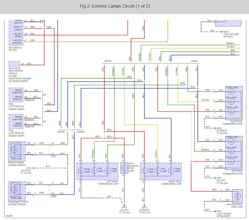

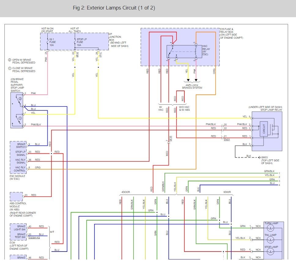

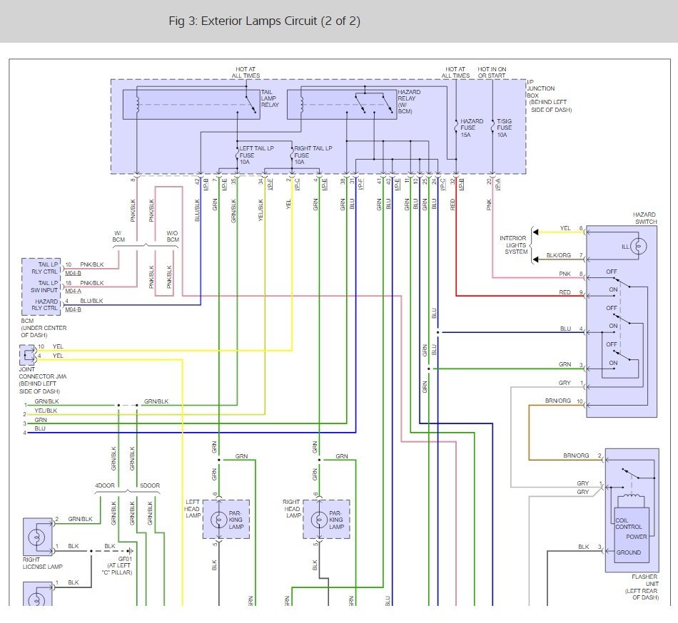

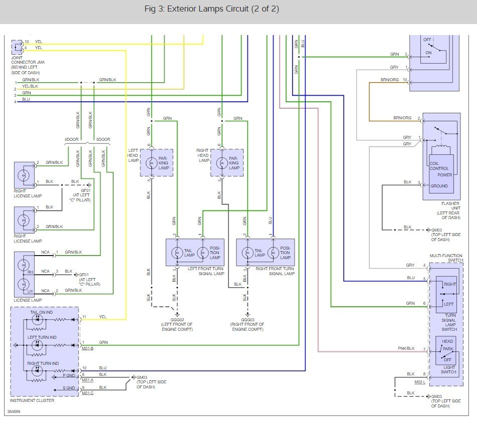

I would recheck the job and look for grounds that may have been left off or a connector not all the way plugged in.
Here is the wiring diagram I have found for you so you can check the fuses and relays.
and
Please let us know what happens, we are interested to see what it is.
Jun 22, 2017 at 9:49 AM
ZACK PRIDGEN
I checked my fuses and it ended up being my turn sig fuse. But now my back tail light is out :/ so I'm gonna check the light and that fuse next
