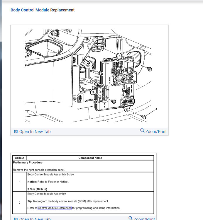

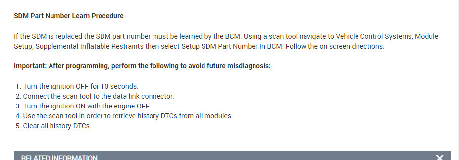

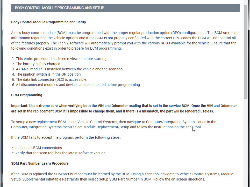

I agree with Joe however the BCM is also responsible instructing the clicking noise to start so if the vehicle is still stock and no radio has been changed, it could be the BCM has an internal fault causing this. I am not sure i would change it just for this but if nothing Joe mentioned checks out then it would be the BCM.
I attached the info for this replacement. Let us know if you have questions. Thanks
