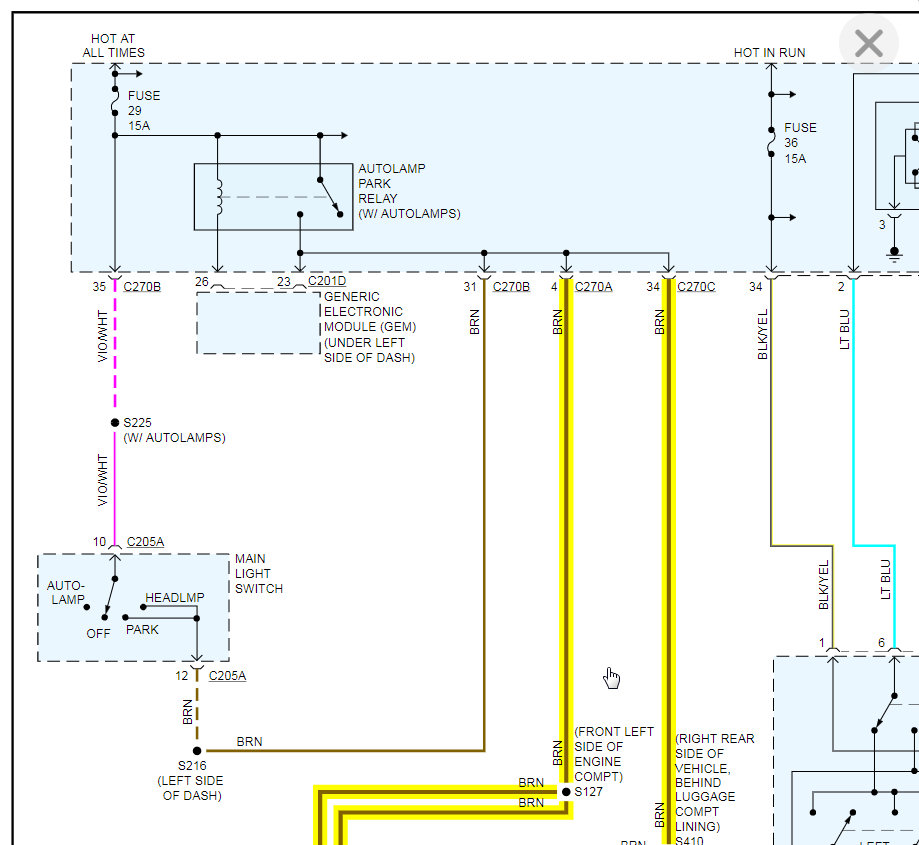

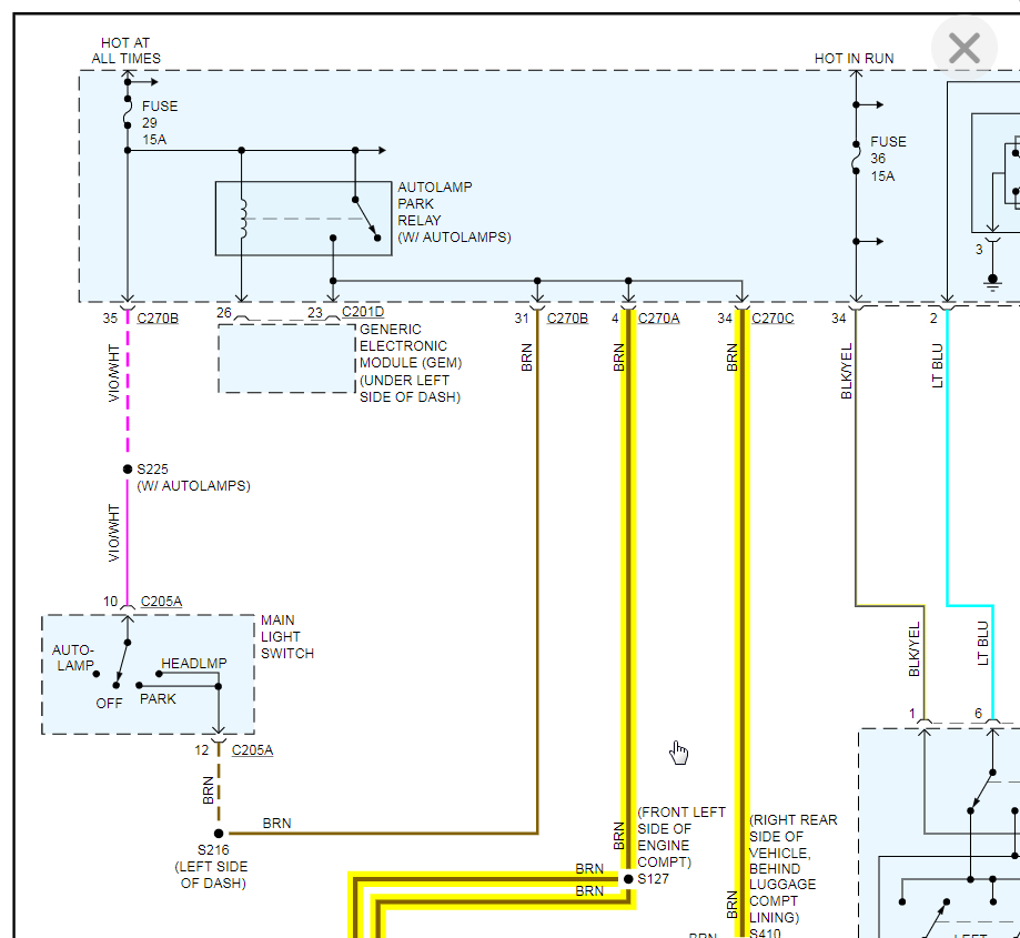

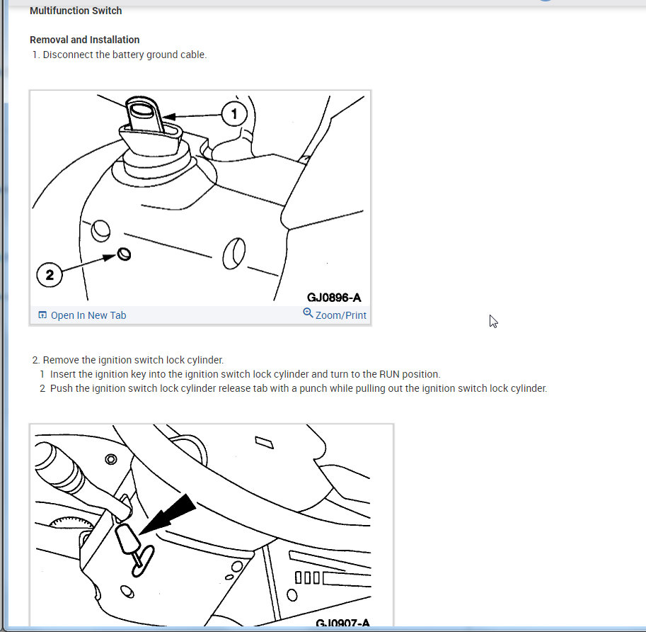

Blinker stopped working.
Jan 15, 2021 at 12:47 AM

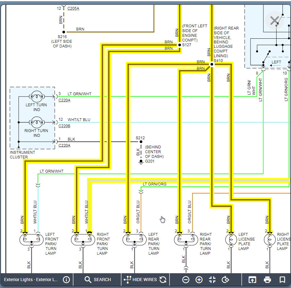

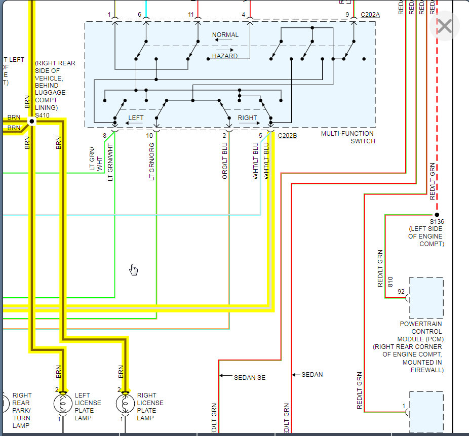

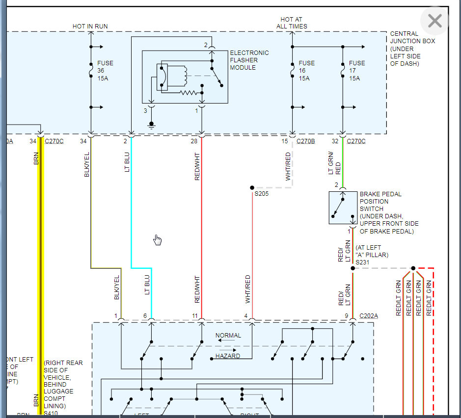

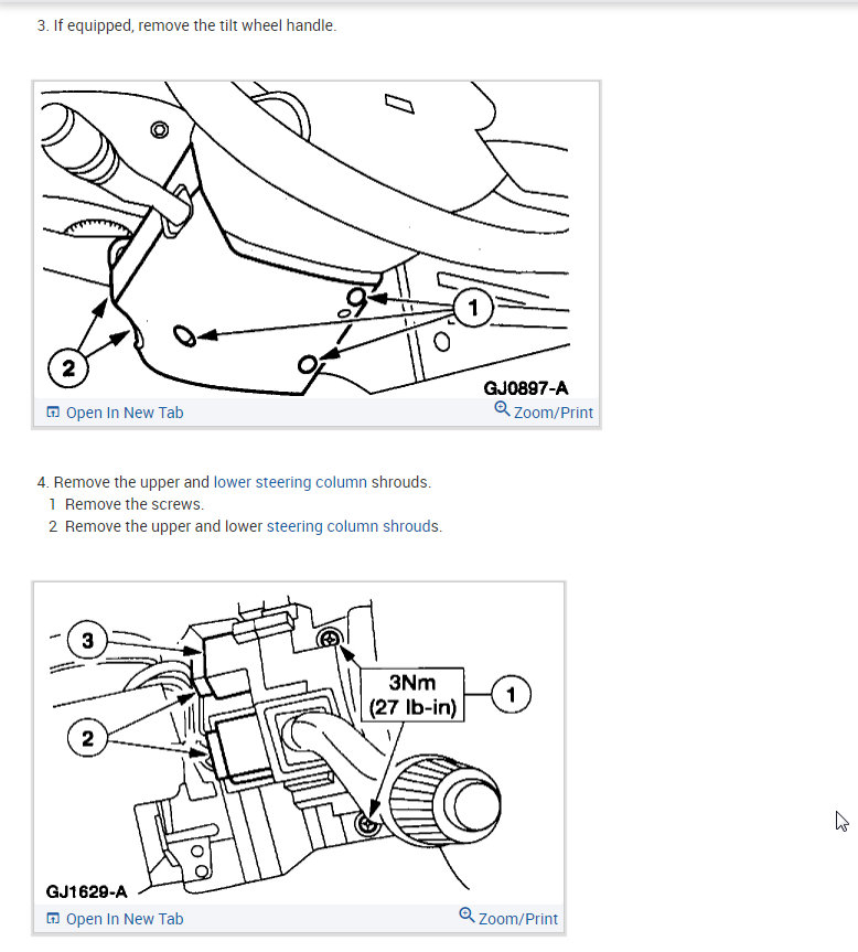

If all the turn signals stopped working and the other lights work then this is most likely a multifunction switch issue.

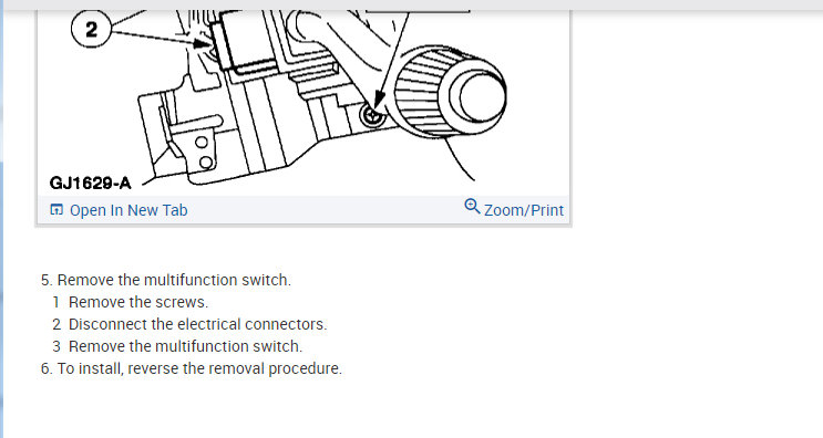

The way to confirm this is test the voltage coming out of the switch to the turn signals. I included the wiring diagram to do this. However, I also included the process on how to replace the switch as if it were me based on this information, I would replace this and then retest.
Here is a guide that will help do this testing:
Let us know what questions you have. Thanks
