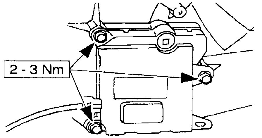

Good afternoon,
You need to rotate the white shaft to the same position as the old one. It will turn but maybe a little stiff.
Once you install it the actuator must be calibrated.
Note: Because the battery has been disconnected as part of the removal procedure the HVAC module will initialize and calibrate the actuators when the ignition switch is switched to the "on" position. The purpose of the module actuator position calibration is to allow the HVAC module to reinitialize and calibrate the actuator stop points. Calibration of the actuators will take approximately thirty seconds.
Turn the ignition switch to the "on" position and wait thirty seconds before verifying correct temperature blend door actuator operation.

Which way does it turn? It is not turning at all. I’ve seen people hook up a battery to it but that did not work either. How hard should I force it? My fingers/hands are killing me.
Thursday, April 15th, 2021 AT 12:34 PM (Merged)
  • 52,797 POSTS
Okay, you can plug in the electrical connector, turn on the key and change the command from heat to cold until it lines up.
+2
ERICO DESANTIS
All set. Your solution worked. I plugged it in, turned key to the on position, adjusted heat/cold knob until it moved into the correct spot (screw holes lined up). Then I installed the screws. Thanks again!

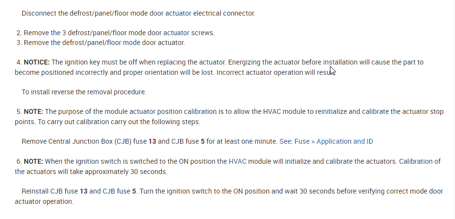

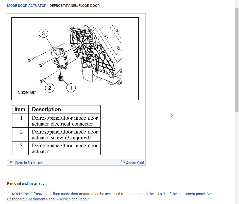

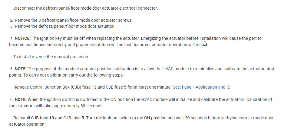

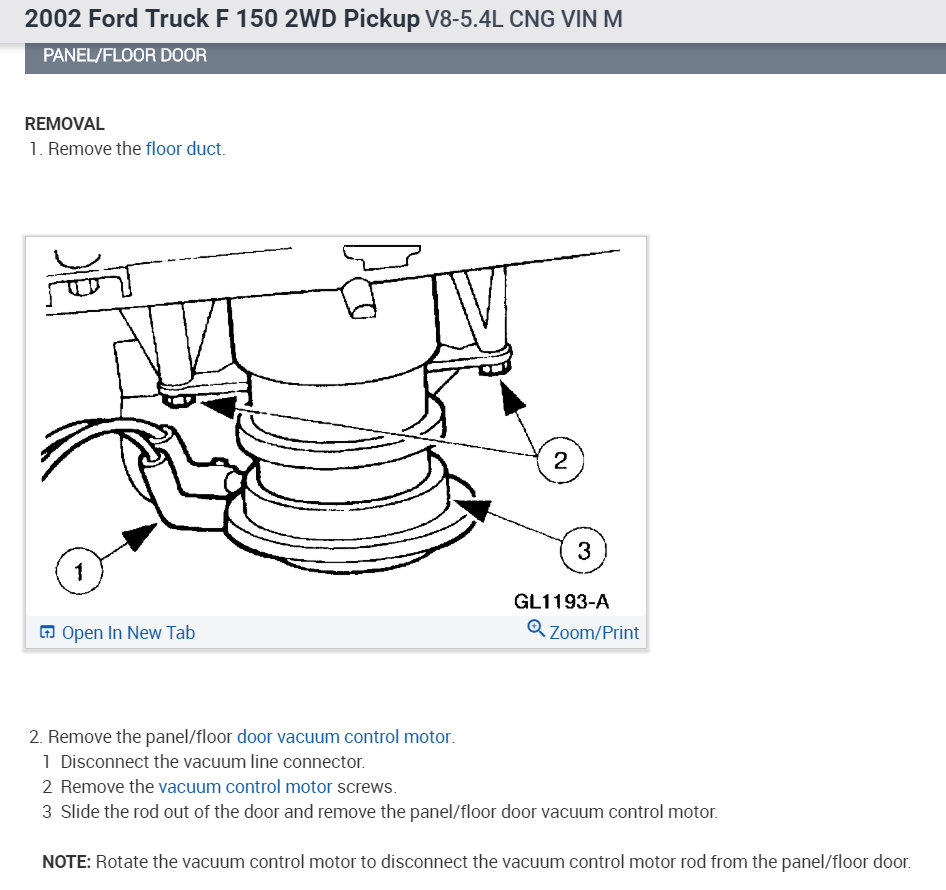

My defroster can not keep up with icing on the windshield. The air comes out of the center vents I think it needs a mode actuator can you help please?
Just to be sure, you have an issue with the air coming out of the center defrost vents but not the outer vents?
here is a guide on a blend door and while this is a mode door issue it gives good info.
This would be a mode door issue so I attached the info below from the manual on how to replace this.
Please run through this material and we an go from there. Thanks
+1

How do you remove and install the heater blend door it only blows luke warm air. Check hoses under hood both hot
Thursday, April 15th, 2021 AT 12:35 PM (Merged)
KEN L
  • MASTER CERTIFIED MECHANIC
  • 48,363 POSTS

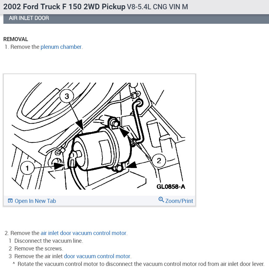

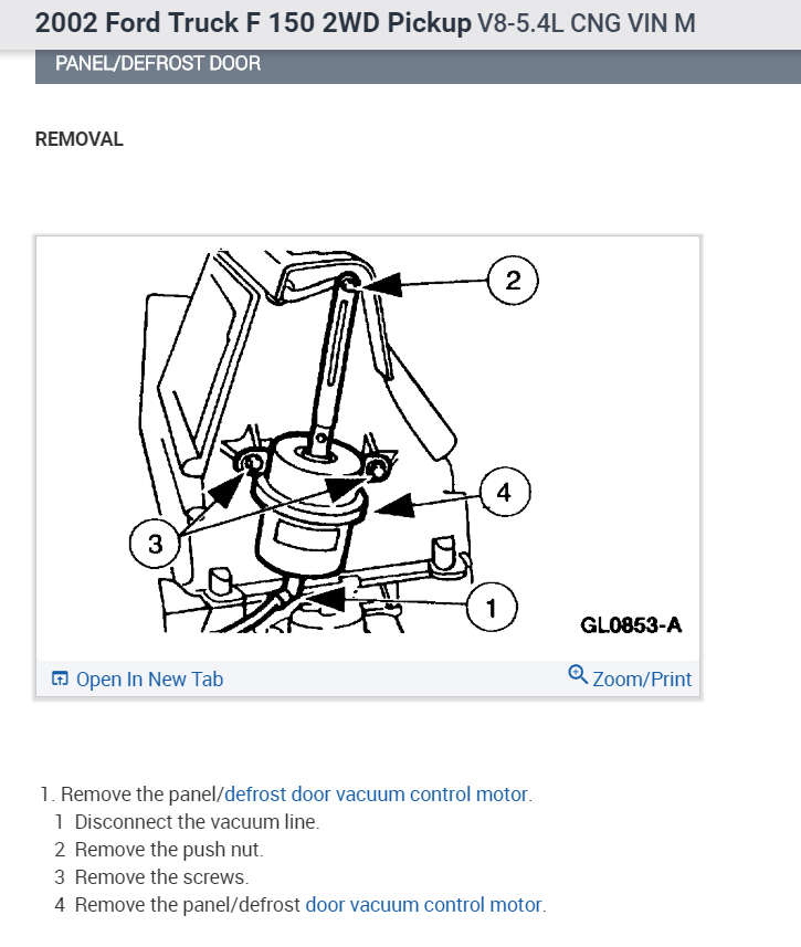

Here are two guides to help walk you through the repair and diagrams below to show the blend door actuators and their locations. Check the vacuum supply to the actuators
and
Check out the diagrams (Below). Please let us know what you find. We are interested to see what it is.

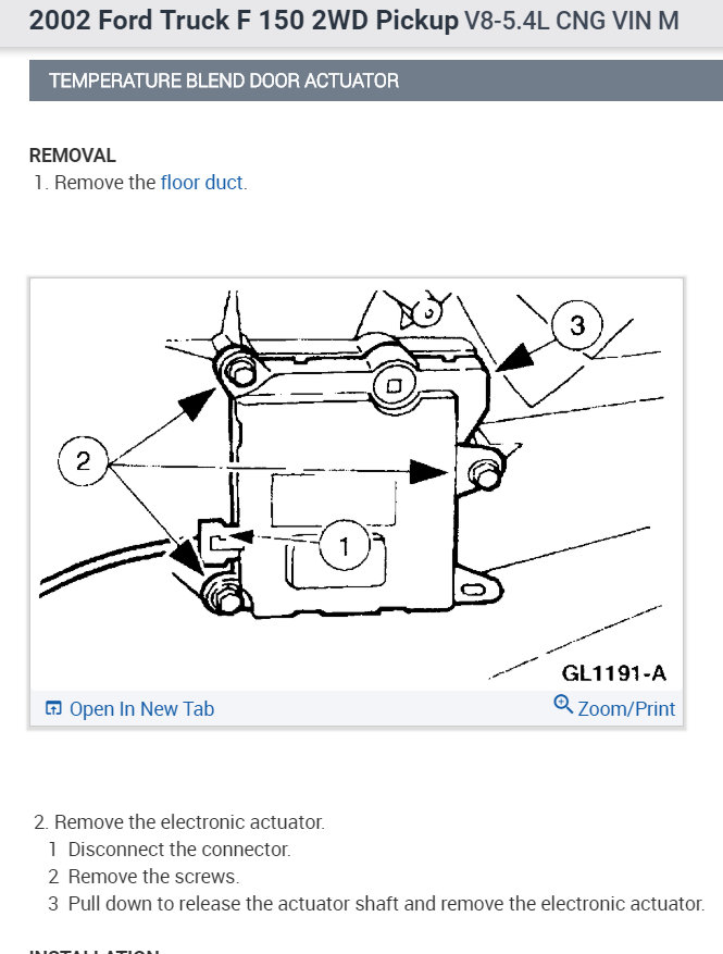

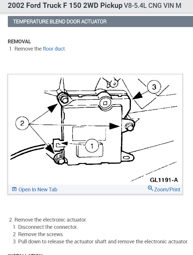

My heater will turn on and stay warm for a few minutes then it reverts back to blowing cold air. What would cause this?
Thursday, April 15th, 2021 AT 12:39 PM (Merged)
KEN L
  • 48,363 POSTS
It sounds like the temperature blend door actuator has gone out. Here is a guide to help you see what you are in for when doing the job.
and
Check out the diagrams (Below) Let us know what happens and please upload pictures or videos of the problem.

I have no control of the heating/cooling temperature on my truck listed above. Both the air conditioner and heater work fine, but it appears that the blend door changes position randomly. When the system is operating I can hear what I believe is the blend door popping open or closed, followed by a change from cold to hot air or vise versa.

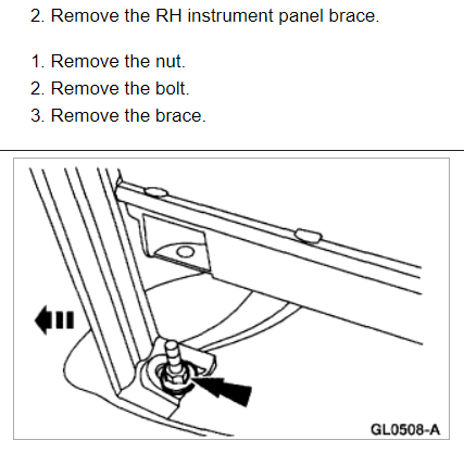

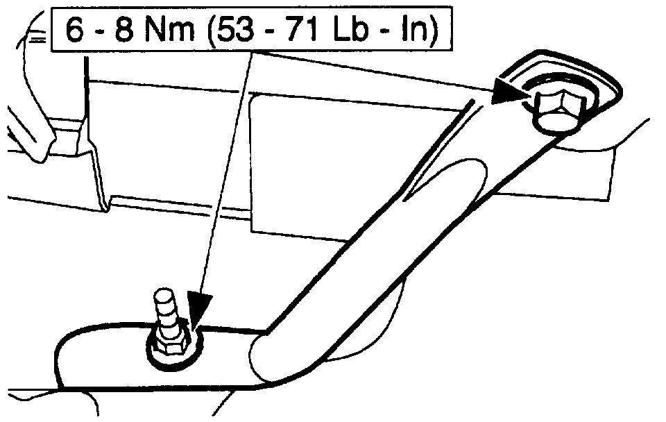

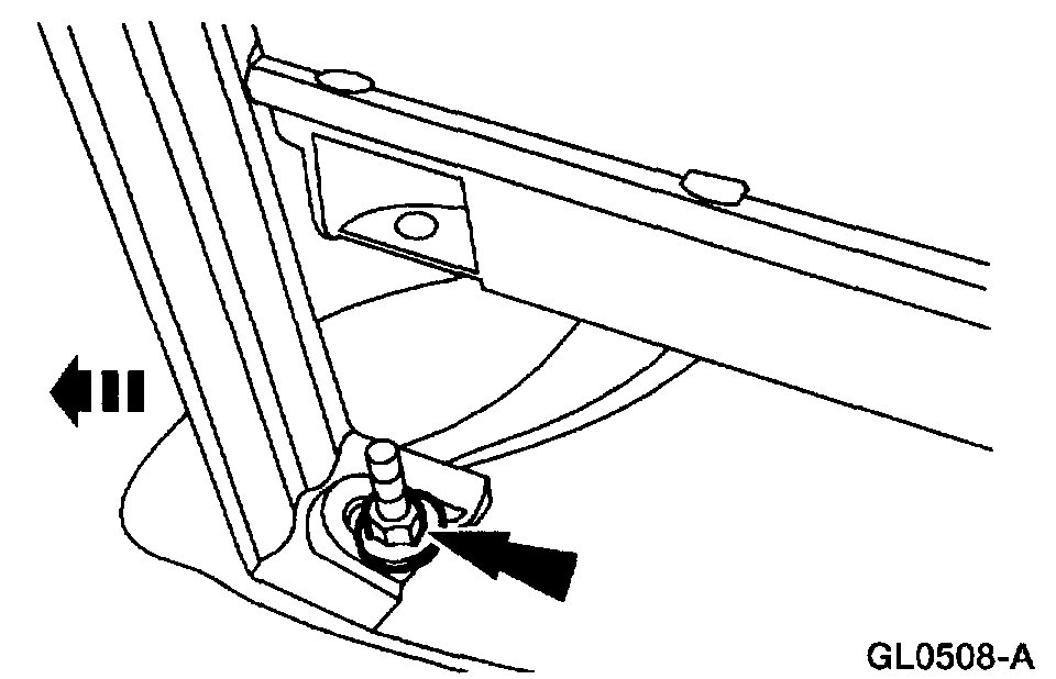

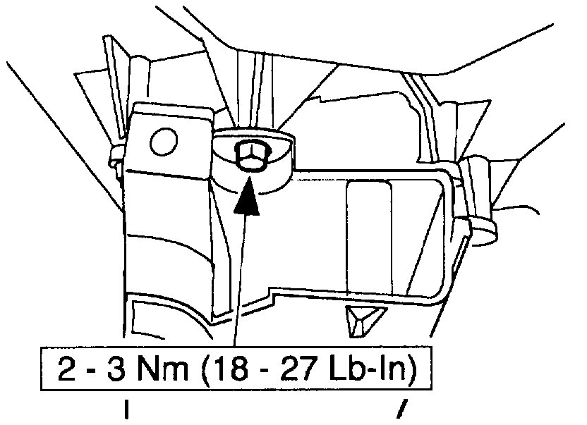

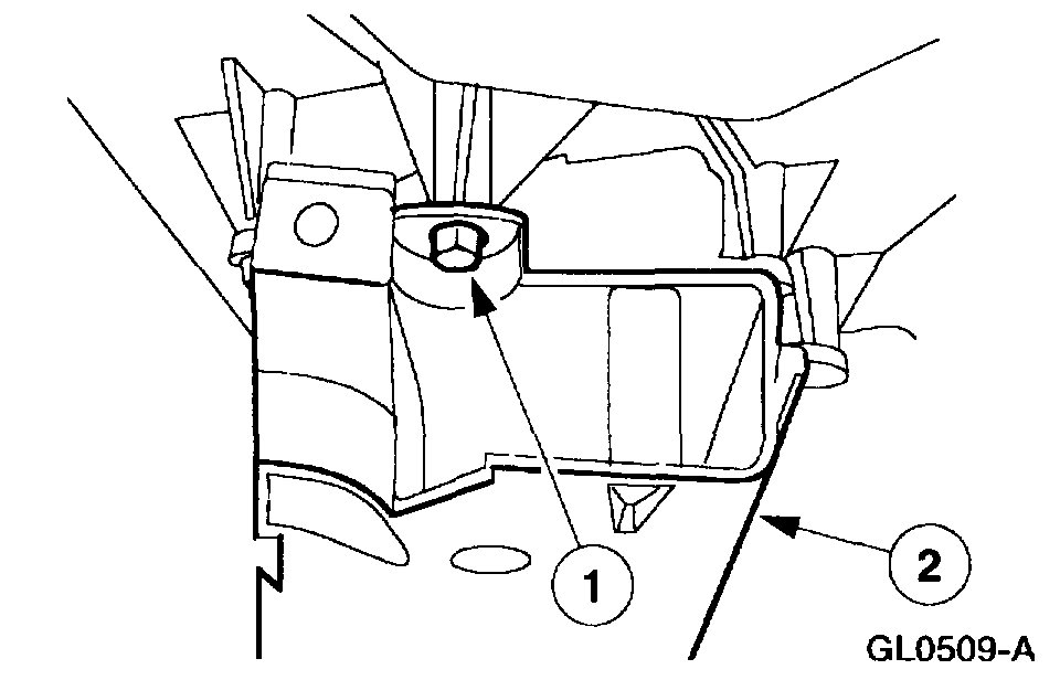

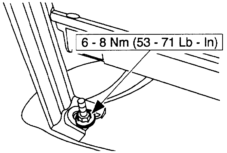

  • 109,885 POSTS

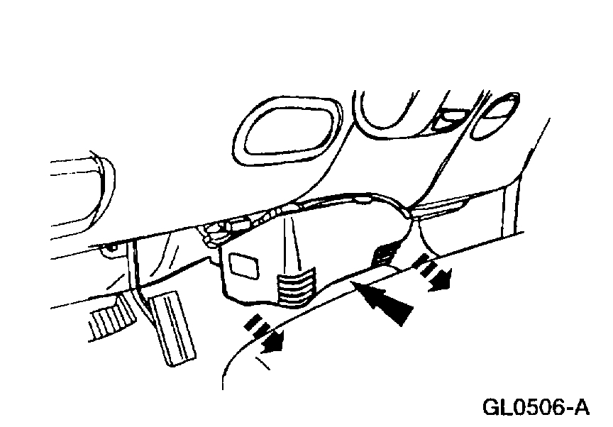

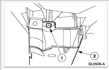

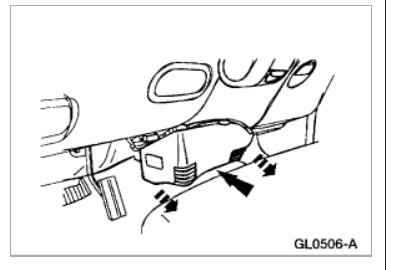

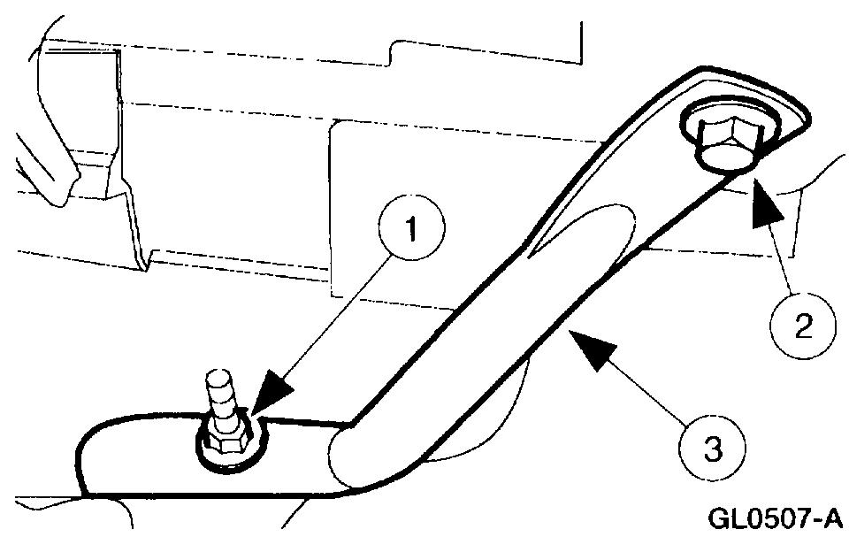

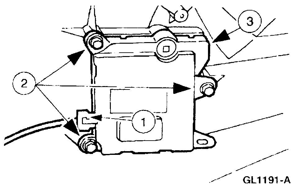

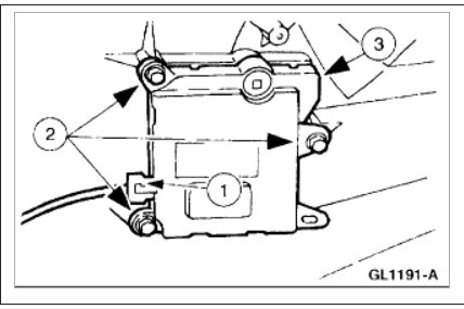

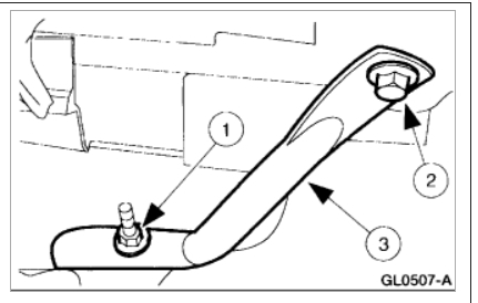

If you find the actuator is the cause, here are the directions for replacing the actuator. The attached pics correlate with the directions.
1. Remove the floor duct panel.
Remove the two plastic push pins (one each side) and release the expander clip.
2. Remove the RH instrument panel brace.
1. Remove the lower nut.
2. Remove the upper bolt.
3. Remove the brace.
3. Remove the LH instrument panel lower nut and position brace out of the way.
4. Remove the floor duct.
1. Remove the two screws (one each side).
2. Remove the floor duct.
5. Remove the electronic actuator.
1. Disconnect the electrical connector.
2. Remove the three screws.
3. Pull down to release the actuator shaft and remove the electronic actuator.
INSTALLATION
1. To install, reverse the removal procedure.
