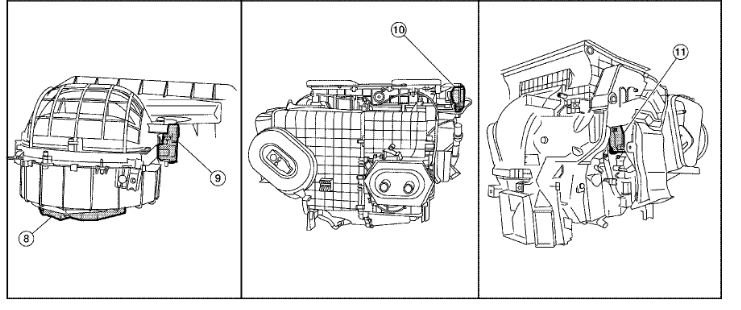

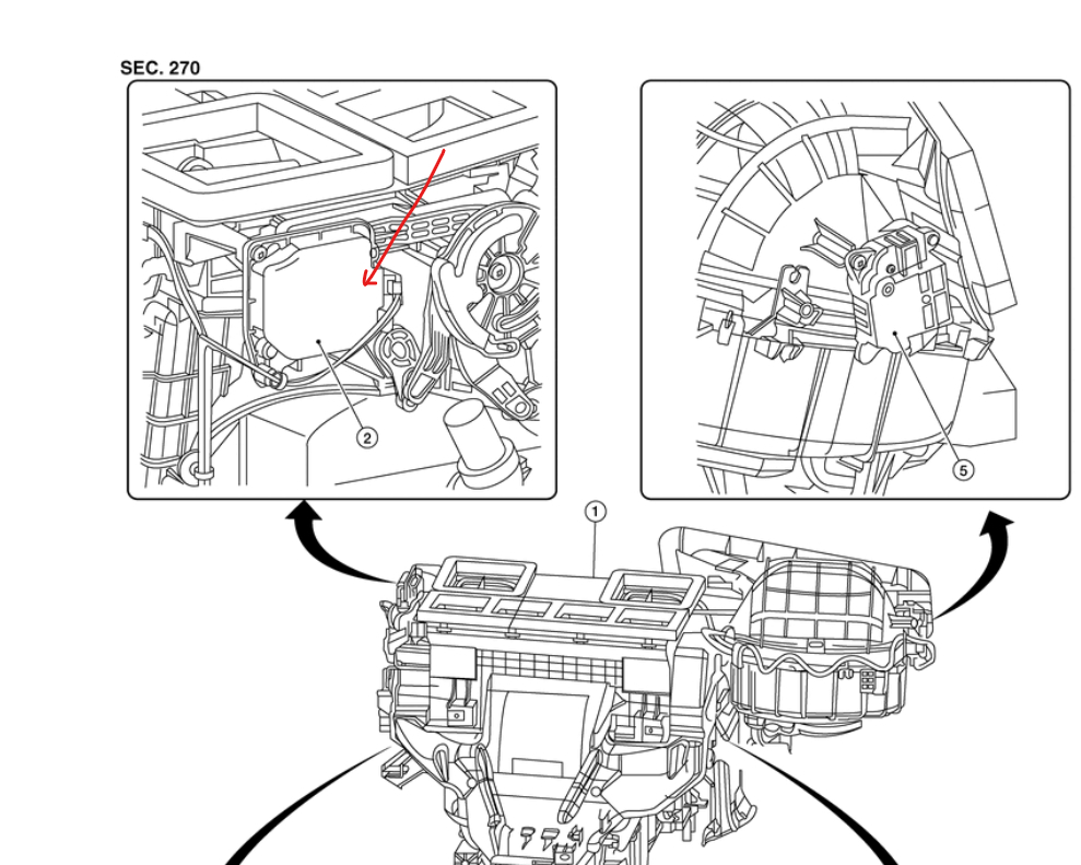

needed help locating blend and proper procedure for removal of available?
Oct 27, 2018 at 2:34 PM
STEVE W.
  • 15,413 POSTS

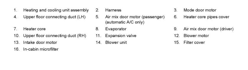

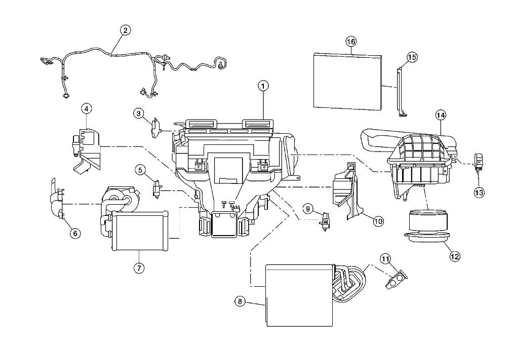

In the picture the numbers = 9 - intake air door, 10 - mode door, 11 - air mix door
Those are the actuators on the manual AC system. The mix/blend door actuator is reached by removing the glove box trim strip on the right, then remove the screws around the glove box, disconnect the wire connector and remove the box.
Inside you will see a duct connection that you need to remove and the blend actuator is behind it. The duct should have a plastic tab that you move to release it. The actuator is removed by disconnecting the electrical connector, then remove the screws and the actuator. Reverse this process to install the replacement. Check out the diagrams (Below). Please let us know if you need anything else to get the problem fixed.

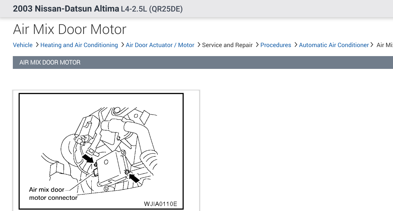

KENW1
  • 213 POSTS
Hi Tracy, it's our pleasure to help.
The actuator would be the blend door actuator. It's located behind the glove box. I'll post a diagram and instructions below. Let me know if manually moving it helps.
AIR MIX DOOR MOTOR : Removal and Installation
REMOVAL
1.Remove the glove box assembly. Refer to "Removal and Installation" See: Glove Compartment > Removal and Replacement > Removal and Installation.
2.Remove the upper floor connecting duct (RH). Refer to "Exploded View" See: Housing Assembly HVAC > Removal and Replacement > Exploded View.
3.Disconnect the harness connector from the air mix door motor.
4.Remove the air mix door motor screws and the air mix door motor.
INSTALLATION
Installation is in the reverse order of removal.

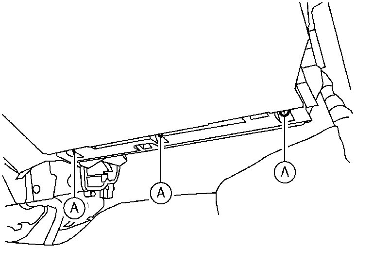

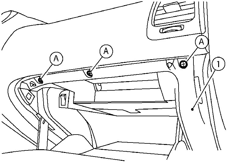

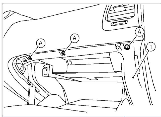

GLOVE BOX ASSEMBLY
REMOVAL
1.Remove the instrument side finisher RH using a suitable tool.
2.Remove the glove box assembly (1) upper screws (A).
3.Remove the glove box assembly lower screws (A).
4.Disconnect the harness connectors from the trunk switch and glove box lamp, then remove the glove box assembly.
INSTALLATION

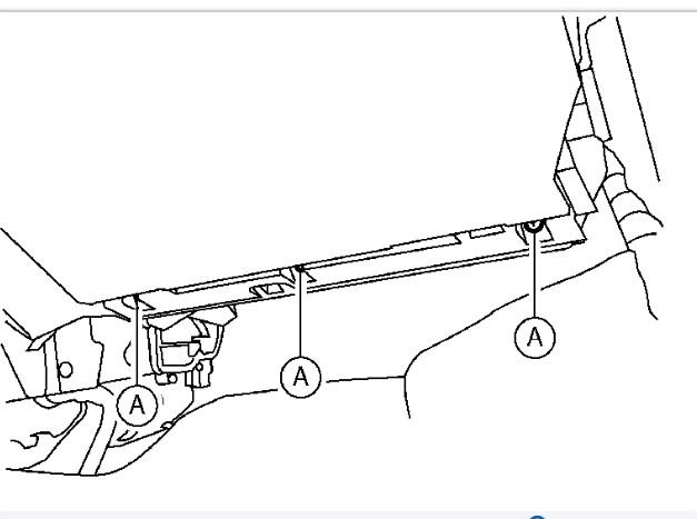

Please help me I’m so confused. Both diagrams that you sent me say take glove box out. I’ve got the glove box removed but I don’t understand what to do now and the diagram is so confusing. Is there any other instructions or diagram to better give me an idea of where it is exactly. Feeling hopeless
May 24, 2021 at 12:15 PM (Merged)
CHANNAT
  • 7 POSTS
I’m happy and excited to say I was successful at locating it, removing it and manually closing the heater door and opening the AC door. This was in fact the cause of my AC suddenly no longer working and blowing hot heater air whether turned on or off. I’m so excited to have my AC is working again and I was able to save $300.00 plus dollars. Thank you so much for all your help. Your awesome. thank you again.

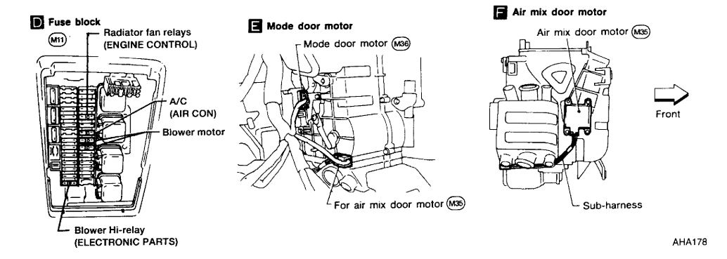

Hello, I have a '13 Altima 3.5 SL with dual climate control. will the above instructions apply to my model/trim Altima? I also need to replace the actuator. the passenger side blows cold air regardless of temperature selection; the driver side blows warm air as expected.
Nov 17, 2022 at 7:18 AM
  • 110,248 POSTS
The directions will likely be different. I have a favor to ask. Could you copy your post and start a new thread? We try to keep these specific to one topic/vehicle type so that it helps others. I hope you understand.

NOKILASKHAN

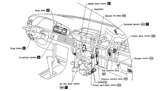

Hey guys I also have a 2015 nissan altima, it’s blowing out hot no matter the temp, won’t change where the air flows from, and if i have it on full blast, it blast for an minute and then loses power and blows softer but i still have it on full blast. What should I do? I’ve changed the A/C actuator, blower motor and checked everything
Jul 14, 2026 at 11:03 AM
  • 55,721 POSTS
It sounds like the mode actuator is bad which is common, here is the location so you can swap it out. Check out the images (below). Please let me know what happens.
