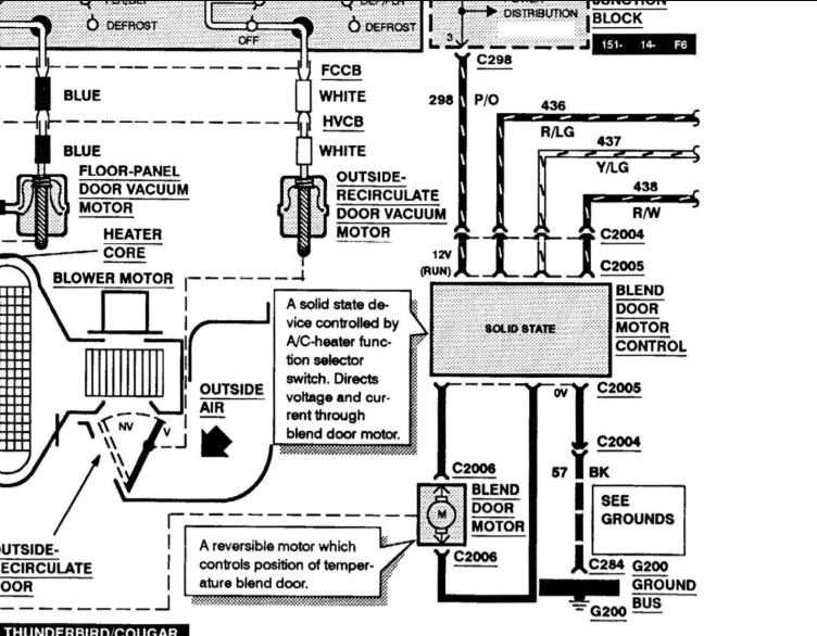

In the beginning I heard clicking coming from behind the dash, accompanied with the inability to change temperature. After taking out the glove box, I noticed the source was from the blend door actuator, which went bad. I went to rockauto.com and got a replacement, and quickly replaced it. It may have been foolish not to disconnect the battery, but I figured that it would not be that big of a job. After plugging it in, I found out that no power goes to the new actuator. Any advice that I could get?

Good afternoon
The battery does not have to be removed for this repair. they key should be off.
I will attach a wiring diagram for you to view. make sure there is power to the blend door actuator when you command cool or heat. make sure the connector is not damaged as well. inspect the pins for any damages or burned pins.

This diagram is for inside the dash, correct? The air also only goes through defrost and and floor, no matter what I set the climate control to. I checked the wires connected to the BDA, and surrounding areas, including fuses. No issues.

If you verified all voltages to the actuators, then you either have a bad actuator or the doors they are moving are seized.

Used a ratchet to see if the doors have any move, they work perfectly. New actuator I ordered must have been damaged on shipping or something because the replacement works great! Thank you.

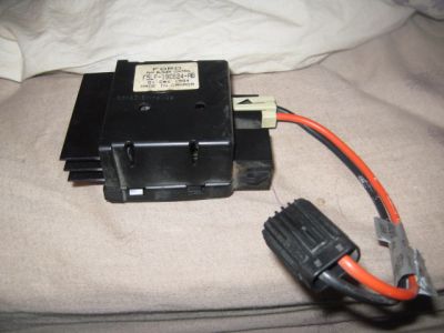

Heater problem
1994 Ford Thunderbird V8 Automatic ? miles
if i turn the heater on it doesnt come on right away almost like it sticks what would be wrong

Is this an automatic system or manual? The resistor is called that, a resistor or fan speed controller if it is solid state

it is a automatic so what is a blower control then

here is a pic of it

Blower motor speed controller
try motor first
