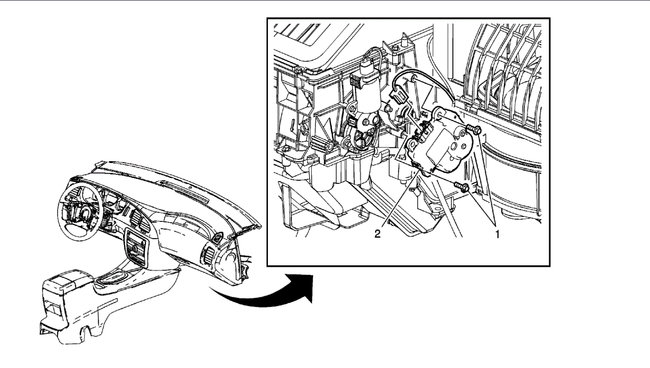

My blend door actuator on passenger side was clicking so I replaced it and it still doing same thing. is the new one bad also or am I doing something wrong?
Dec 11, 2021 at 6:58 PM
  • 110,194 POSTS

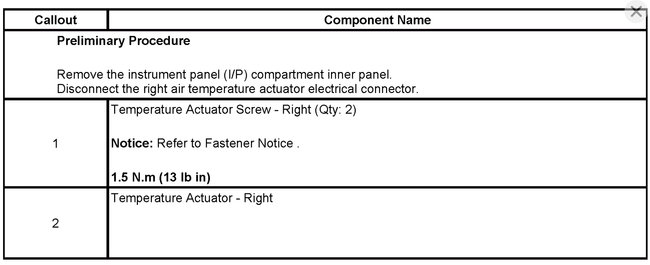

Replacement is just removing and replacing. I attached the directions below for your vehicle. Also, here is a link that explains in general how it is done:
If you are getting the same noise, there is a chance you got a bad one. Remove it and check to see if you can move the door by hand to confirm it isn't stuck. Also, while it is out, actuate the actuator and see if it is turning. There are plastic gears in them that break and click. See if it works smoothly.

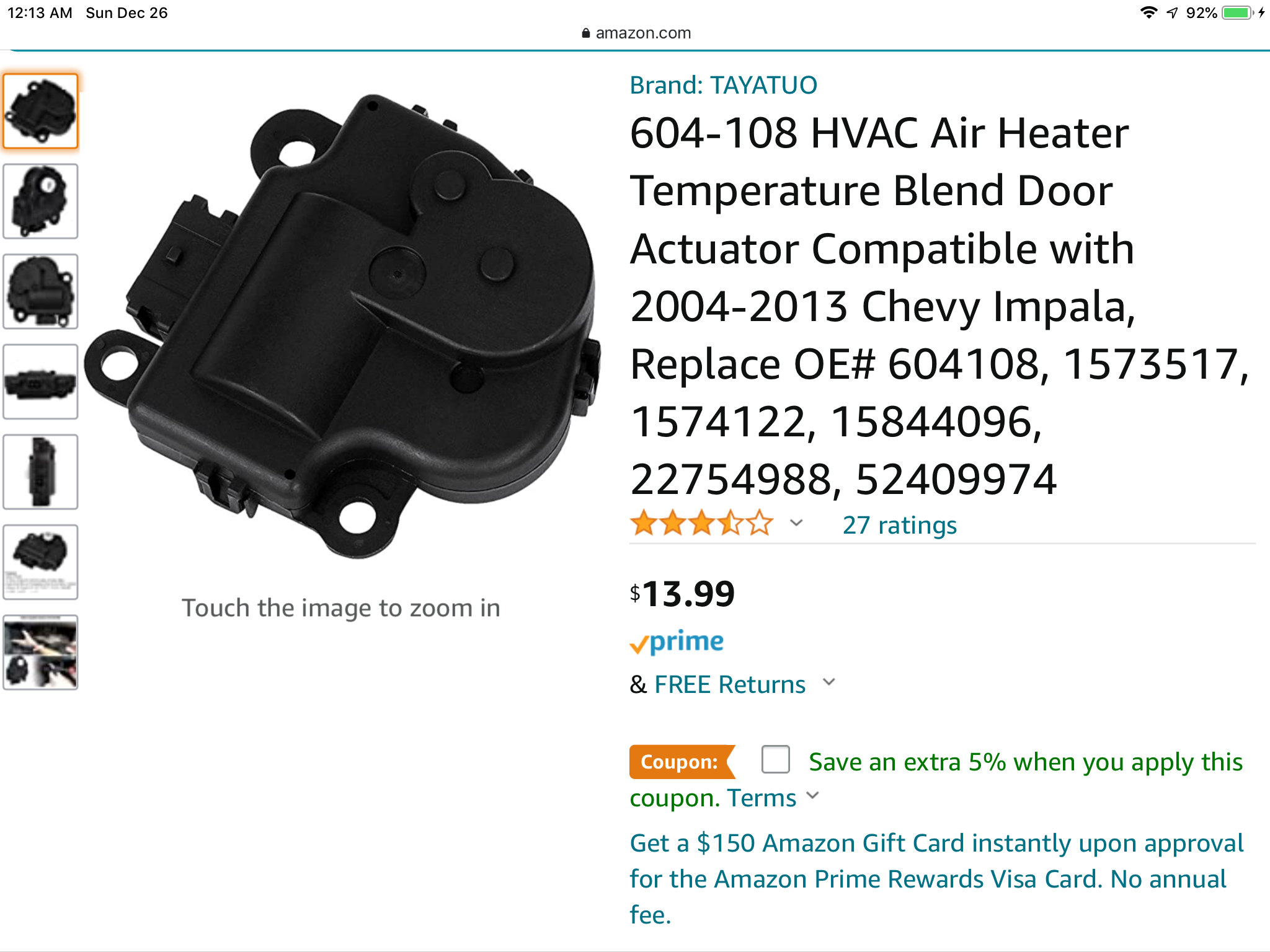

It’s a cheap one from Amazon.
Dec 25, 2021 at 9:14 PM
  • 110,194 POSTS
Oftentimes, the parts online don't last. Looking at the pic, there are several OEM part numbers this replaces. However, I believe the OEM part number for your vehicle is 16451370. The part number isn't listed. The number may have been changed, but I can't confirm that.
You may want to consider a different brand. I can't guarantee that is the issue, but likely, it is. If you search the internet, type in GM part number and the number I indicated. If you can get an OEM one for a good price, that would be the best choice. However, there are others that make reliable parts such as Dorman.
