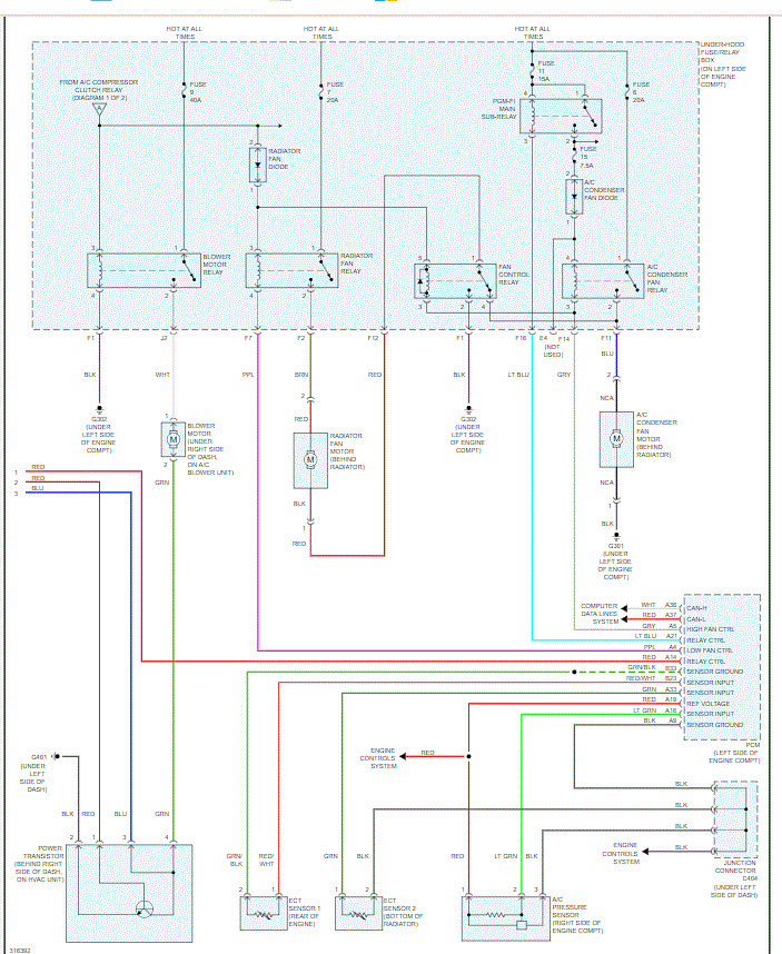

Blend door actuator not working
2009 HONDA CRV
180,000 MILES
BUBBALUV
Soon as I connect new one before I completely install it. The blower quits working.

Do you mean the blower motor stops working when you replace the blend door actuator? Since they aren't directly related, I suspect you are moving a bad wire around while working under the dash causing it to lose connection. Are you able to make the blower motor work at this point?
Nov 3, 2019 at 12:38 PM
BUBBALUV
Nope. I plugged in new actuator. Turned on car. Turned system on. Nothing happened. I unplugged new actuator and the system comes in and blower starts blowing. No other wires under there.
Nov 3, 2019 at 8:42 PM
  • 110,244 POSTS

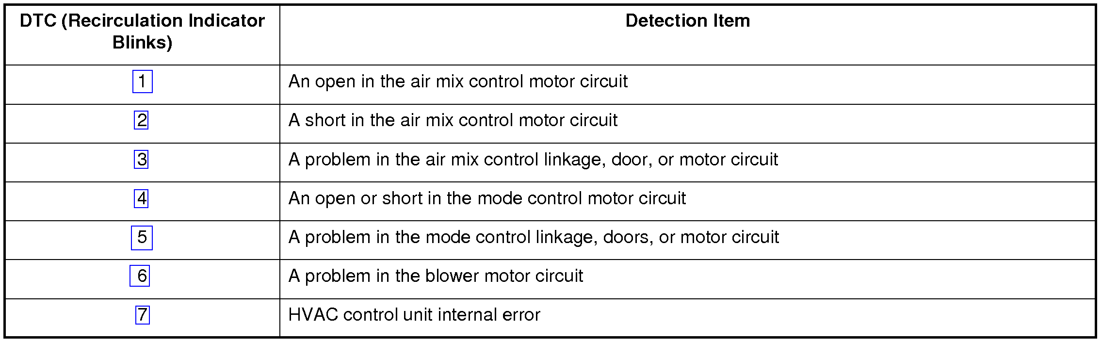

Do me a favor. Try putting it into self diagnostic. Here are the directions. The two attached pictures correlate with the directions. Also, the second pic lists what each code indicates.
I looked through the wiring schematic, and the only thing I can suspect at this point is the control unit. If you unplug the fan, can you tell if the actuator is working?

- In the case of multiple problems, the recirculation indicator will blink the lowest number DTC only.
- If no DTCs are found, the indicator will not blink.

Hey Joe, it didn't look like OP responded, but I am having the same problem, I run the self diagnostic with my old blender actuator plugged in and I get 2 blinks back, meaning a short in the mixer. Then I have the same problem when I plug in a new mixer actuator the light goes off on the ventilation button, and come back and starts blowing again as soon as I unplug, which sounds like a short to me. I also purchased a tested replacement temperature control unit and have swapped that out as well.
Any other thoughts with this new input?
Thanks in advance!
P.S. Possibly sharing the wiring diagrams with me could help, i'm an electrician who works with PLC's myself.

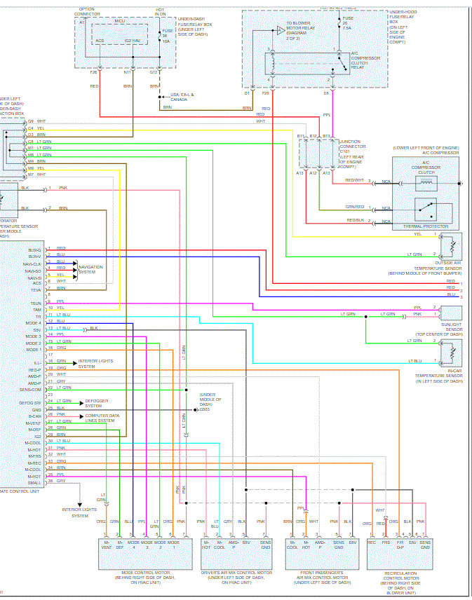

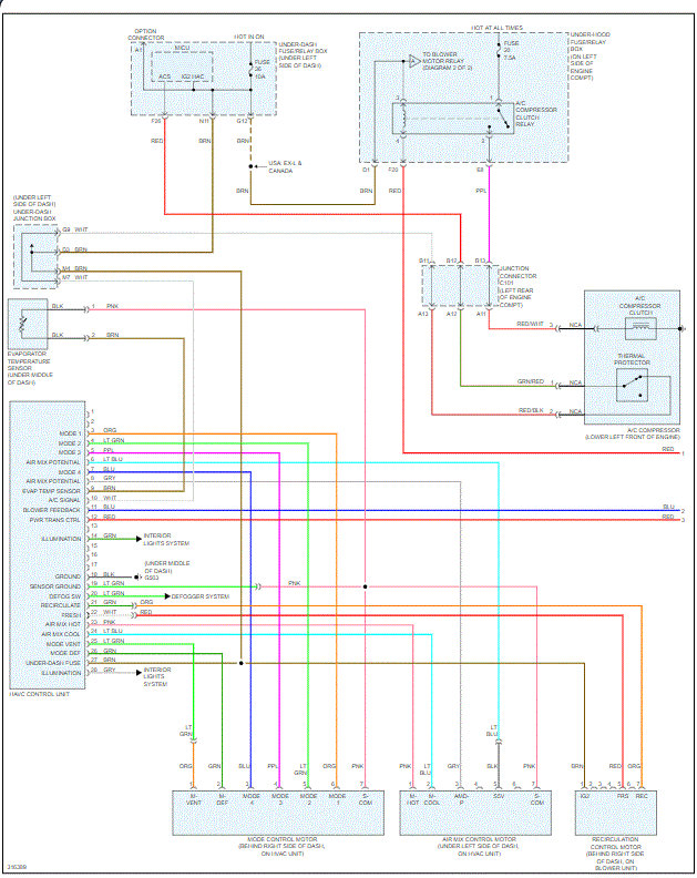

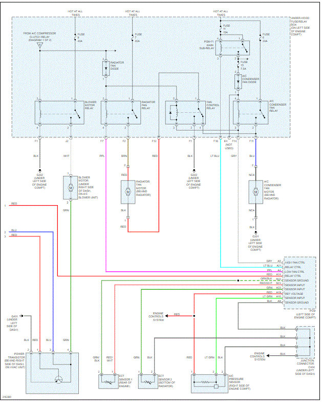

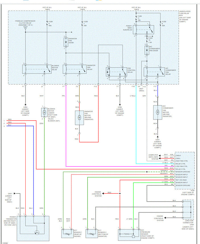

I attached pics below for the HVAC on a 2009 CRV. Just making sure your vehicle is the same year and model. Pics 1 and 2 are for manual climate control.
Pics 3 and 4 are for an automatic climate control system. I'm not sure which one you have.
