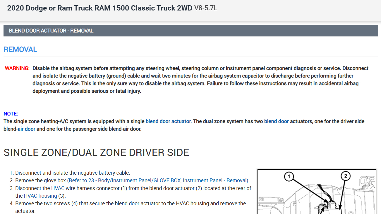

Where is the driver side blend door actuator located?
Nov 25, 2024 at 1:12 AM
  • 55,748 POSTS

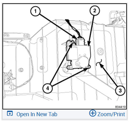

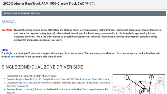

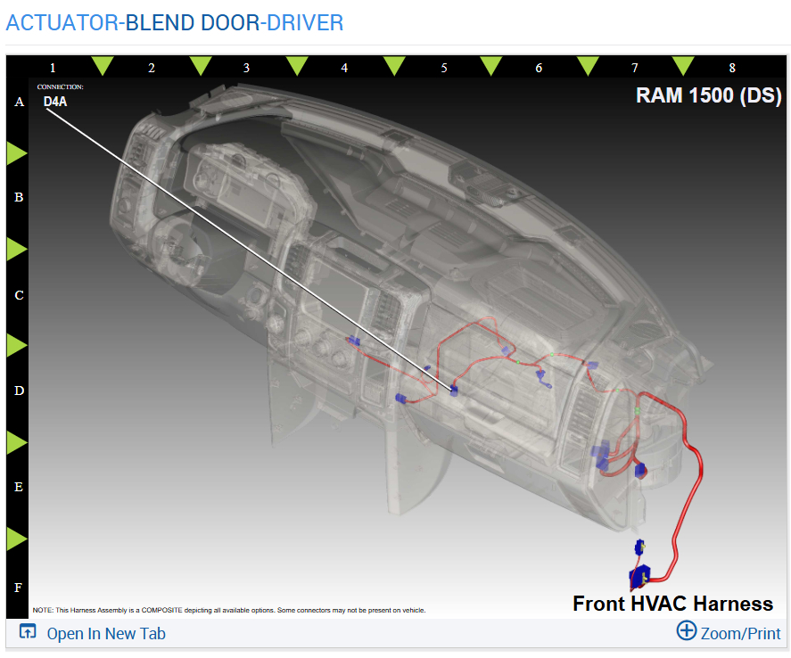

The driver side blend door actuator is located behind the dash down low on the passenger's side. Here is the location and how to change it out. Check out the images (below). Please let us know what happens.
Nov 25, 2024 at 5:26 AM
SSHAFFER92
  • 22 POSTS
I have taken the glove boxes off, but still do not see it.
Nov 25, 2024 at 9:54 PM
  • 55,748 POSTS
It must be above or to the side of the HVAC plenum, I would use a flashlight and small mirror on a stick to find it. They only give .5 hours to change it so it can be too difficult.

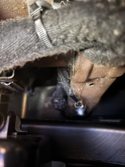

I just had my heater core replaced and that is when the hot air stopped working. I found this connection missing a plug while looking for the actuator. Any chance you can tell me if it should be plugged into something? It is right above the heater core.

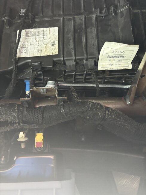

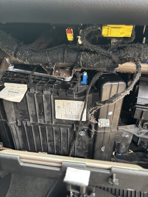

I think I found it on the bottom Of the box closer to the center. It is just tight squeeze. Is it possible for you to tell me what that other connection is for?
Nov 27, 2024 at 6:08 AM
  • 55,748 POSTS
Nice work, I can tell you what the wiring does, can you start a new thread also include an image of the connector and the wiring color.
Nov 28, 2024 at 3:36 AM
SSHAFFER92
  • 22 POSTS
I was able to replace the actuator, and everything is working properly. I just started a new post about the connector. Here is the link https://www.2carpros.com/questions/connector
