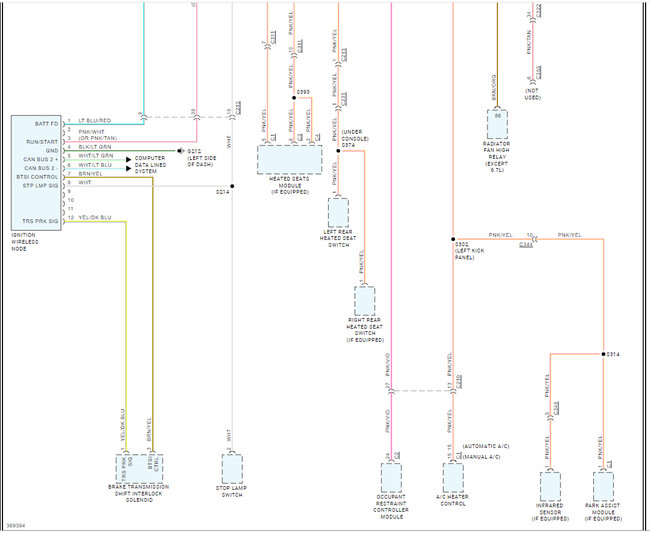

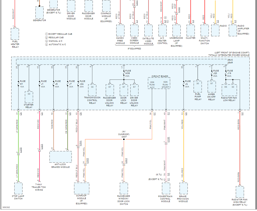

I am from Poland and just bought an imported Ram 1500 5.7 HEMI 2012yr. Well, I have to make some changes in exterior lighting due to our regulations. One thing is to install rear fog lamp. I found in the TIPM configuration menu this:
Configuration of #10(F12) output -rear fog lamp: enable.
I just cannot identify which pin is #10(F12) to connect my fog lamp to it.
The second question is if there should be a possibility to set bulb type to LED in the TIPM configuration menu as it is possible in 2013+ models? To tell the truth I can't find those settings for now and I am wondering if it is a problem of my OBD interface/hardware or my car doesn't give that possibility...
I will be very grateful for any answer.

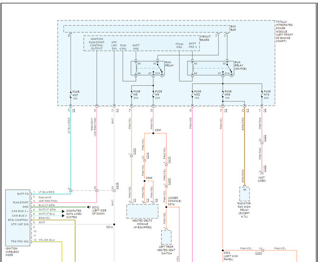

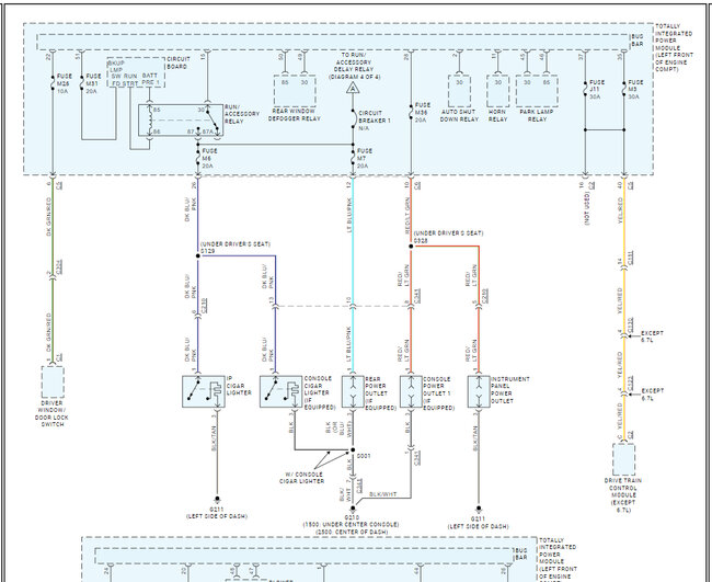

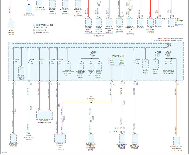

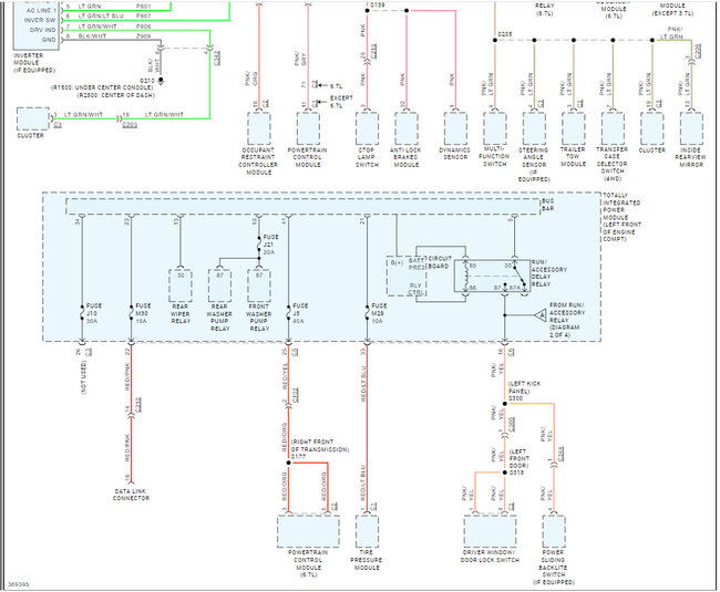

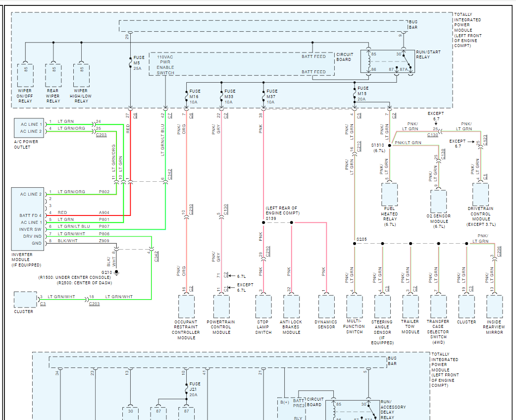

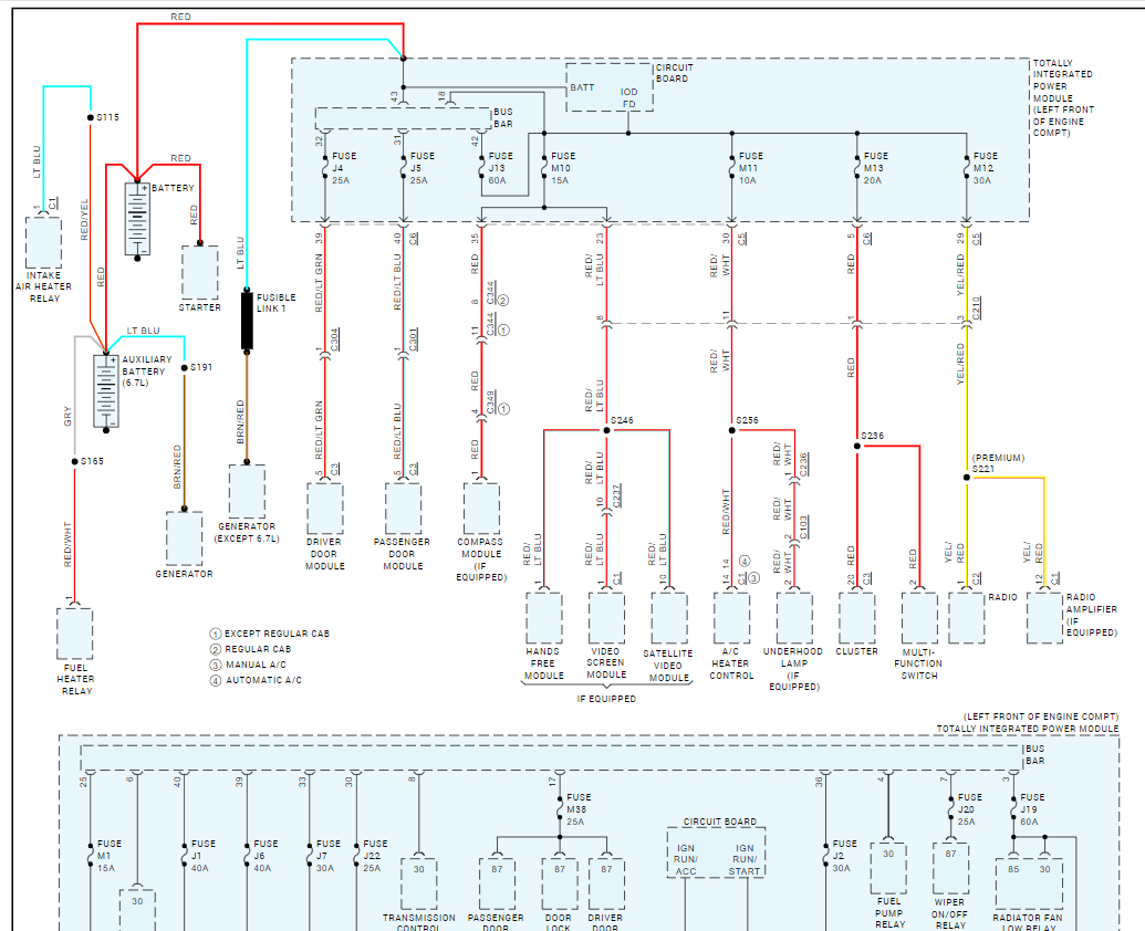

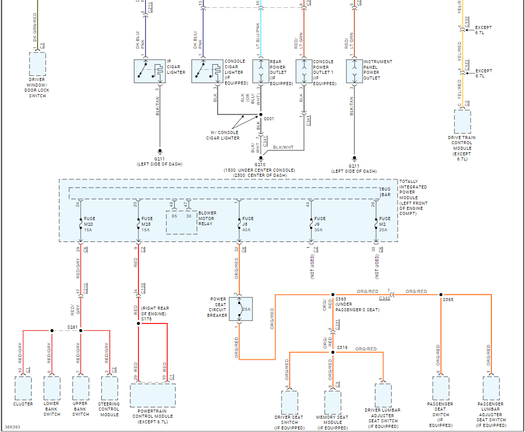

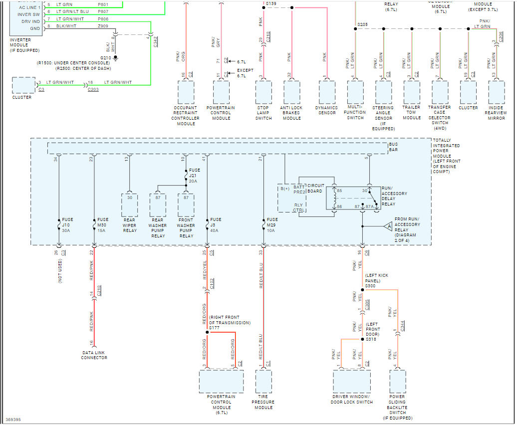

Unfortunately, for the 2012 RAM 1500, the Totally Integrated Power Module (TIPM) does not have the ability to configure bulb types (like LED). I am not sure where you got the fog light info but all I see for pin TIPM configurations is "J" and "M" ? Here are the TIPM wiring diagrams so you can see what I am talking about. Check out the images (below). Let us know how it goes.

Thanks for the answer and the data. I couldn't find the pin on which the new rear fog signal was supposed to occur. I have installed new separate switch to operate the lamp. Anyways thank You very much for help!
