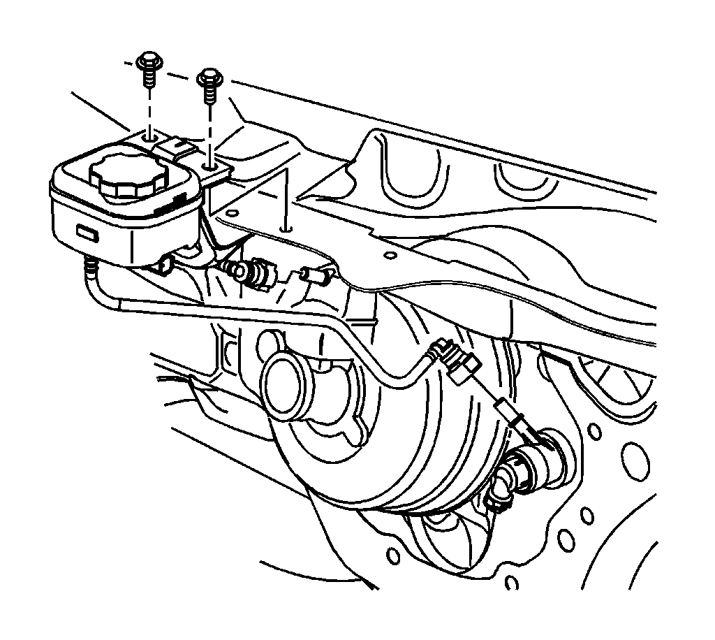

I have a feeling you didn't get the push rod properly installed. With that, I am going to provide all the steps for replacing the part. Read through them to confirm you did it correctly. After that, I will provide the directions for bleeding the system. All attached pictures will correlate with these directions as indicated.
__________________________________________________
PROCEDURES
Clutch Master Cylinder Replacement
Removal Procedure
Picture 1
1. Remove the clutch pedal retainer from the front of the clutch pedal assembly.
2. Pull the clutch pedal upward in order to disengage the clutch master cylinder pushrod from the clutch pedal.

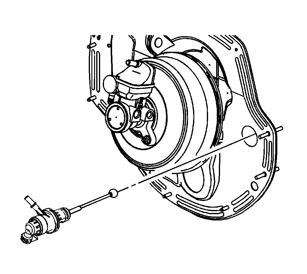

3. Remove the UBEC.
Picture 2
4. Place a shop towel under the clutch master cylinder in order to catch any fluid loss.
Notice: Refer to Brake Fluid Effects on Paint and Electrical Components Notice in Service Precautions.
5. Disconnect the clutch damper from the clutch master cylinder.

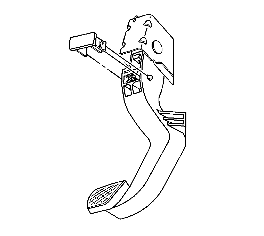

Picture 3
6. Disconnect the reservoir line from clutch master cylinder.
7. Cap the reservoir and hydraulic lines in order to prevent fluid loss and contamination.

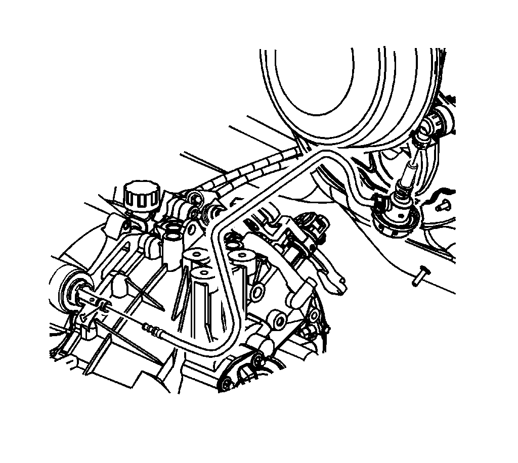

Picture 4
8. Rotate the clutch master cylinder one 1/4 turn clockwise and remove the cylinder from the vehicle.
Installation Procedure
Picture 4 again
1. Install the clutch master cylinder while rotating 1/4 turn counterclockwise.
Important: While installing, ensure that the clutch master cylinder pushrod is aligned with he clutch pedal.
