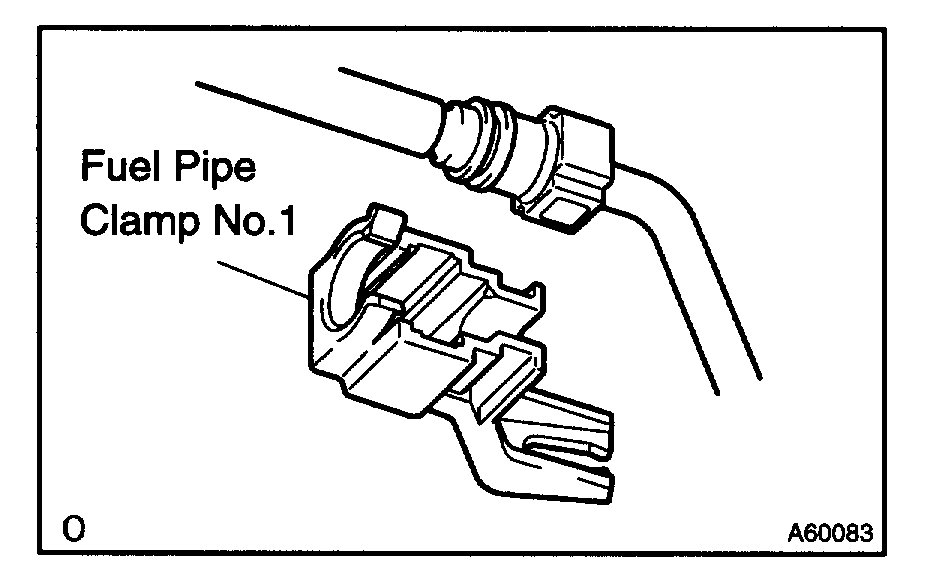

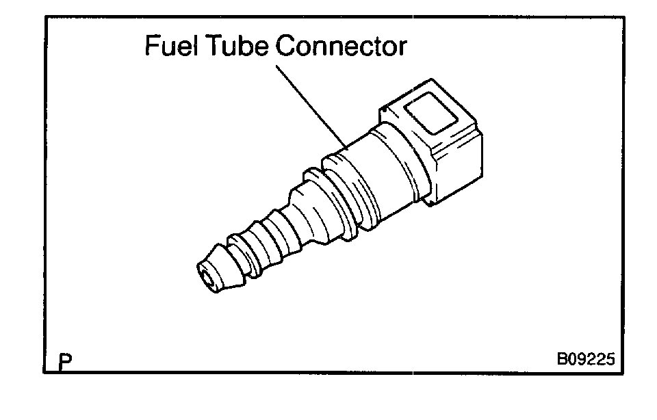

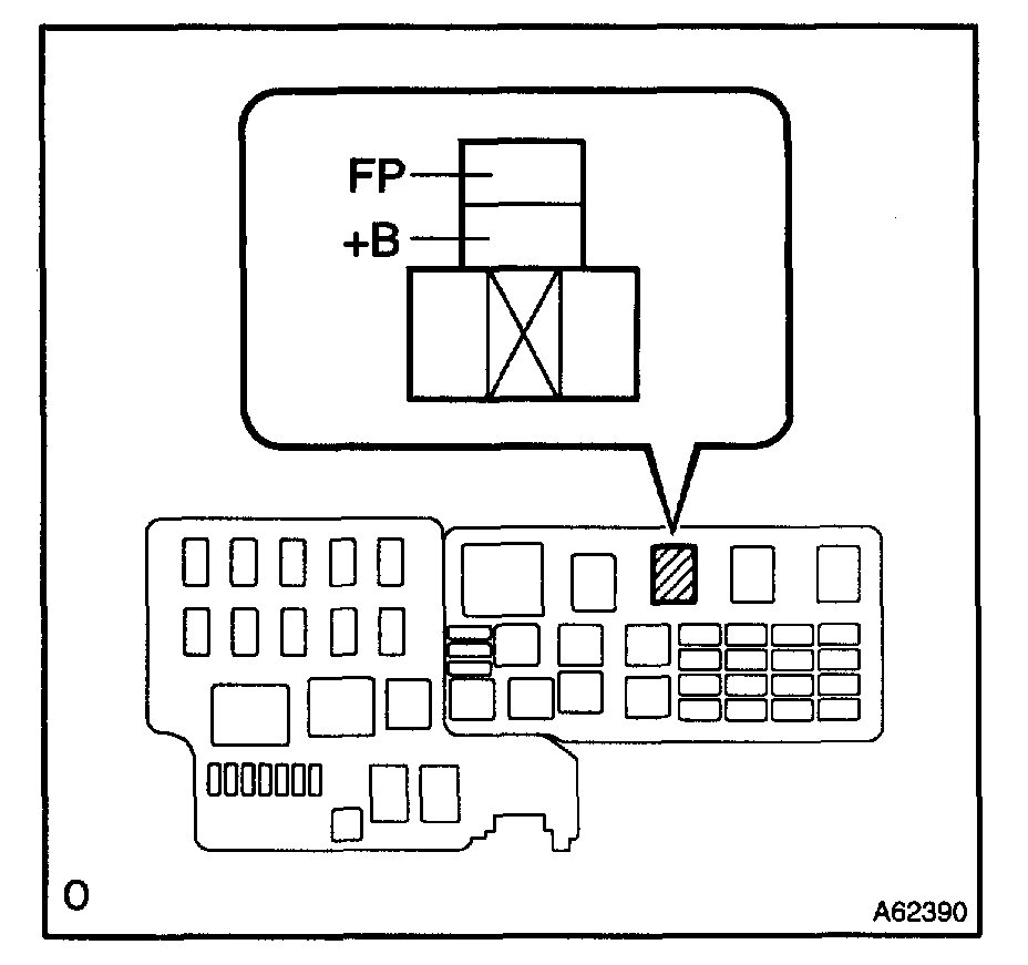

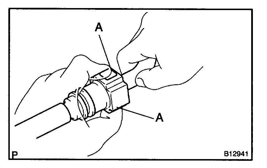

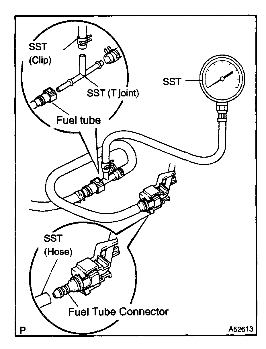

Here are the directions for checking fuel pressure specific to your vehicle. The attached pics correlate with these directions.

1. Purchase the new fuel tube and take out the fuel tube connector from its pipe.
HINT: Part No.23901-28130
b. Work for prevent gasoline from spilling out.
pic 2
c. Remove the fuel pipe clamp No.1 from the fuel tube connector.

d. Disconnect the fuel tube connector from the fuel pipe while pinching part A with fingers as shown in the illustration.
CAUTION:
- Perform disconnecting operations of the fuel tube connector (quick type) after observing the precautions.
- As there is retained pressure in the fuel pipe line, prevent it from splashing inside the engine compartment.
pic 4
e. Install SST (pressure gauge) as shown in the illustration by using SST and fuel tube connector.
SST 09268-41047 (90467-13001, 95336-08070), 09268-45012 (09268-41250)
f. Wipe off any splattered gasoline.

2. CHECK FUEL PUMP OPERATION AND FUEL LEAK
a. When using hand-held tester
1. Connect the hand-held tester to the DLC3.
2. Turn the ignition switch ON and hand-held tester main switch ON.
NOTE: Do not start the engine.
3. Select the active test mode on the hand-held tester.
4. Please refer to the hand-held tester operator's manual for further details.
pic 5
b. When not using hand-held tester
1. Remove the circuit opening relay.
2. Using a service wire connect terminals FP and +B of the relay block.
NOTE: Pay due attention to the terminal connecting position to avoid a malfunction.
3. Turn the ignition switch ON, and check that the fuel pump operates.
