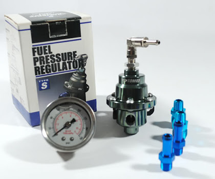

Can I put Tomei fuel pressure regulator type s on the fuel rail entrance pipe and I do have a return back pipe plus I wanted to ask u where would the vacuum hose be attached to and do u have courses for people to teach them about cars.....?
Aug 11, 2015 at 10:51 AM
KHLOW2008
  • 41,814 POSTS
You can put any fuel pressure regulator as long as it can regulate correctly.
The vacuum hose can be from any part of the intake manifold after the throttle plate.
There are courses available for vehicle repairs.
Aug 11, 2015 at 11:15 AM
M WAHAB SULTAN
  • 11 POSTS
what if i dont attach a hose? and can u send me a link to the courses.... if i change my engine which should i put in a b12? sorry but can u also tell me should i dril a hole and weld a small pipe after the trottle plate to install a vacum hose
Aug 11, 2015 at 12:07 PM
KHLOW2008
  • 41,814 POSTS
Sorry but can u also tell me should I dril a hole and weld a small pipe after the trottle plate to install a vacum hose
Without a vacuum hose, the fuel pressure at idling would be too high and that would result in too rich a mixture.
Sorry I don't have any links for automotive courses but if you search around, you should be abkle to find one. It is best to get an acedemy or school near you place of residence as automotive repairs needs to be hands on and not via the web.
You already have the engine in, do you still want to change ?
For the vacuum hose, there should be available lines that you can tap from. On the manifold you should fine at least one or 2 that is suitable. If not, you can use an adapter and tap it from the PCV hose.
