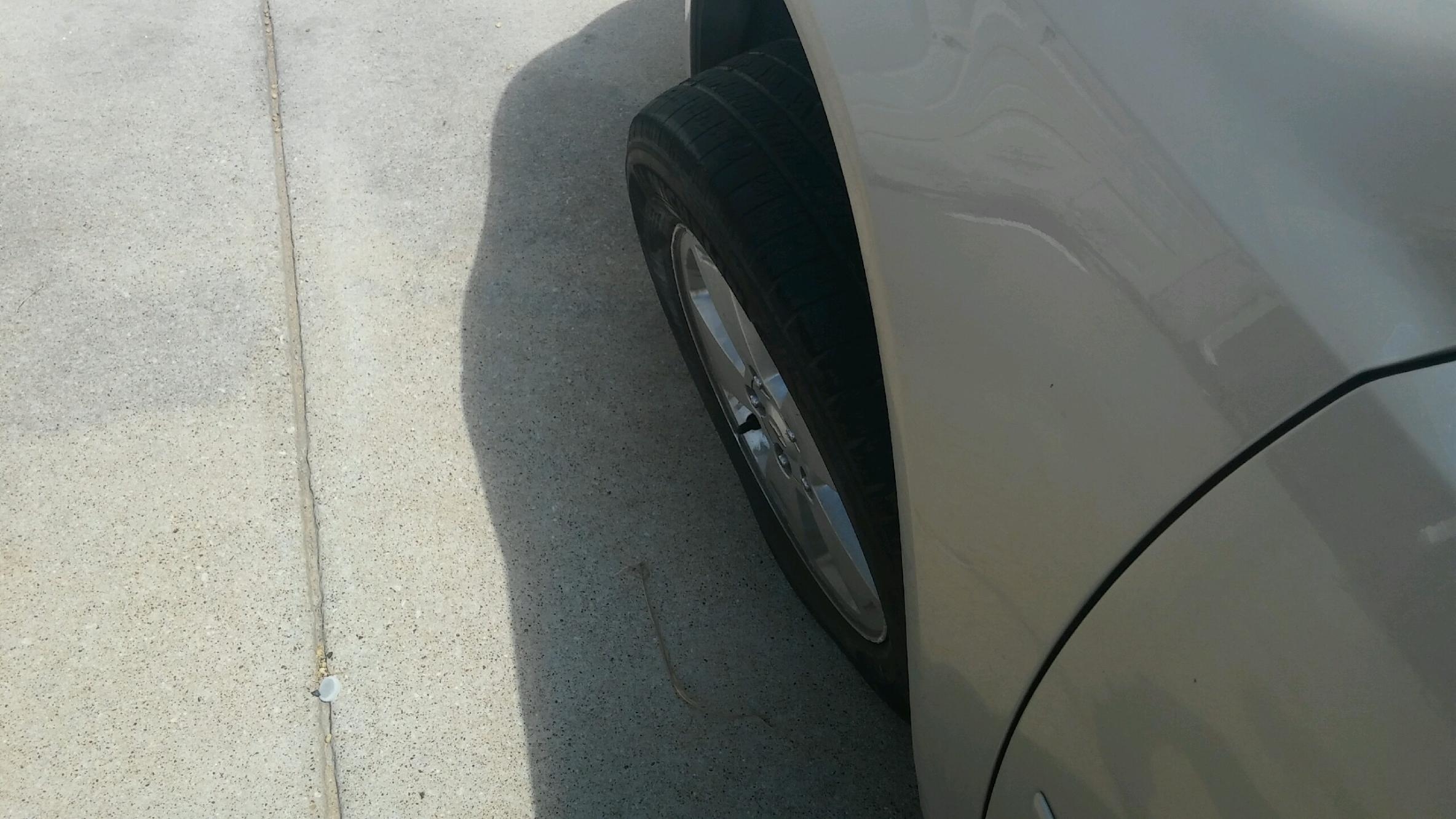

Here is the background i went to customers house to change the driver side lower control arm which obviously was bent at the bottom due to impact with the curb, i checked the sub-frame all the welds are in tact, no visual bends, but what noticed after i changed the lower control arm the drive knuckle also has a huge crack so i told them they have to change that, now the main question i have is am i going to have to change the strut too? The wheel is still slanted due to impact on the driver side the lower control arm is new. The wheel is poked out at the top a lot.

I am going show you a picture @cardiodoc.
Jun 28, 2016 at 12:45 PM
MONEYSAM83
  • 32 POSTS
This is with the wheel straight.
Jun 29, 2016 at 2:29 AM
HMAC300
  • 48,601 POSTS
check your tie rod ends inner and outer they are either way out of adjustment on one side or bent badly. do not drive this car like that it will shred the tire in no time flat. have a professional look at it to see what is really bent you may have wasted your money on the control arm.
Jun 29, 2016 at 3:17 AM
CARADIODOC
  • 34,342 POSTS
Yup. Your last sentence in your original post said, "The wheel is poked out at the top a lot." This is turned to the left and that is not a strut or control arm issue. If that was the case, you solved that already. This is something different, and as brother HMAC300 said, it is a tie rod issue. The wheel is turned too much for this to simply be out-of-adjustment. There is not that much adjustment in the threads. The tie rods on this car are behind the wheels, so one that is bent will cause that wheel to turn away from the center of the car, like this one is. You wont bend the outer tie rod end. It is too short. The inner one is real long and it is the weakest part in the system.

I changed the spindle/drive knuckle that solved the problem
