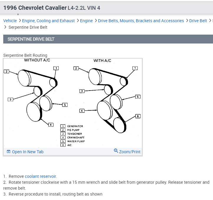

I'm using proper tool for it and all that's happening is that the pulley and the 15mm bolt will turn in its stationary position but will not move tensioner to unload tension from belt (as if belt was too loose or bolt was loose). yet the belt has full tension and there are no symptoms of any type of noise/squeal. The belt is new and no sign of abnormal wear or cracking. It feels like the bolt is coming loose or stripped but again the bolt is secure. Is it possible that spring is broken or worn out and still retain tension on the belt? This is left me at a standstill. Please reply ASAP. Thanks, Mark

Yes, it's possible something has frozen up internally in the tensioner. Here is a tutorial showing how to replace:
https://www.2carpros.com/articles/serpentine-belt-tensioner-replacement
Sounds like you know what to do already but I've attached that and a picture below for reference.Hope this helps and thanks for using 2CarPros.
