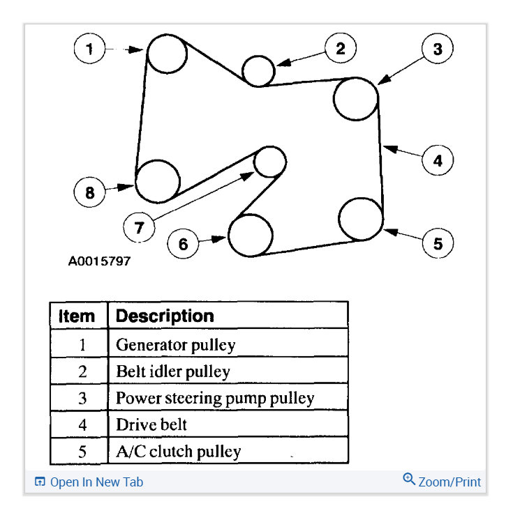

I just replaced the alternator on my vehicle and I cannot for the life of me get the belt back on. Can you help?
Wednesday, December 9th, 2020 AT 2:08 PM (Merged)
HMAC300
  • 48,601 POSTS

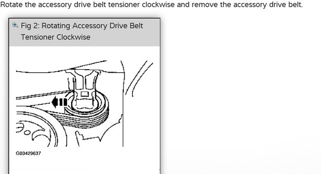

See picture. The one pulley needs to be move clock wise to get belt on it will say removal in picture but same to reinstall.

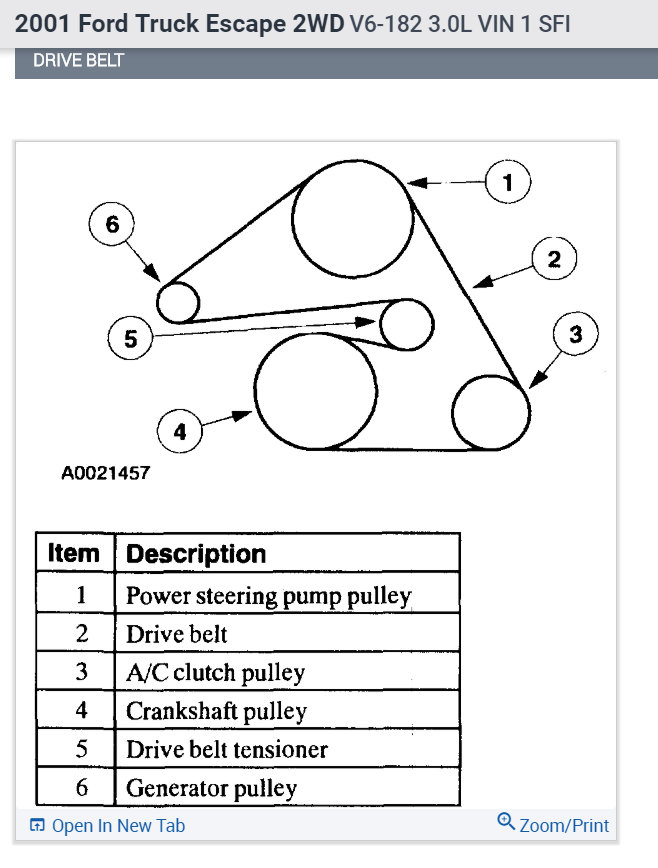

So I'm having some trouble getting my serpentine belt on. I have the right diagram and set the belt up as it is supposed to, then when I pulled the tensioner as far as I could there wasn't enough slack to put the belt on. So I'm stuck Ive been racking my brain for the last few hours and need some help. Is there anyway to adjust that even more? As a side note I did double check that I belt and diagram I have are for my truck.

Do you still have the old belt? If so, stretch the new belt next to the old belt, and verify the new one is the same length. If your belt routing is correct, that means one thing. The new belt is too short.
SPENCERFAM
Thanks for the reply, I did have the old belt and its the same size and the diagram that I used is for the 2wd 3.0 Escapes. I went back and tried to see if there were any other sizes but that was the only size they had for my truck. I spoke to the tech there and they told me that I was able to adjust the AC compressor pulley (BTW had the compressor unit pulled its just a pulley there now) to help it fit, is this possible?

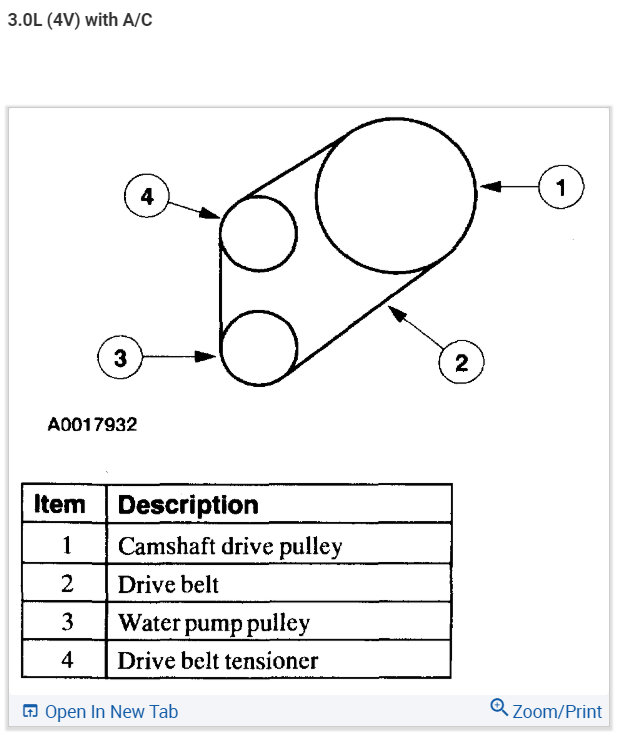

Need to bypass AC compressor pulley with a shorter belt. What length is the shorter belt?
  • 109,885 POSTS
Hi and thanks for using 2CarPros. Com.

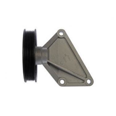

The vehicle came factory with AC. It was not an option. The result is there is no exact way to route the belt to ensure everything will turn the correct direction and work correctly. What I suggest is to get an AC bypass pulley. They take the place of the compressor and you do not have to change the belt or routing. The part is about the same price as a new belt, so you are better off replacing the bad compressor. An after market parts manufacturer by the name of Dorman makes the part. I believe the part number you need is 34223. Please confirm that is correct for your vehicle with the parts store. I attached a picture of what one looks like.

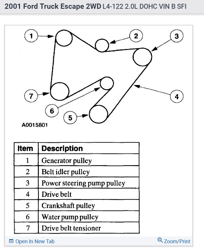

XLT model. How do I put the serpentine belt back together after installing a new alternator, and removing the tension-er?
SATURNTECH9
  • 30,869 POSTS
Here is a guide to walk you through the steps of changing the belt and the belt routing diagrams below so you can see how the job is done:
and
https://www.2carpros.com/diagrams/ford/escape/2001
