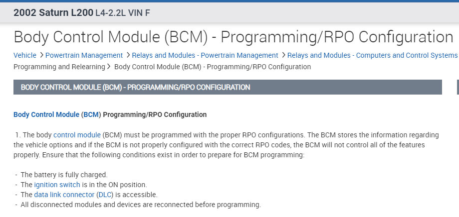

My BCM failed. Bought a new AC Delco OEM replacement from O'Reilly and brought it to the shop that was working on the car. They brought in a seasoned tech from the local Chevrolet dealer who has years of experience programming these BCMs. He could not get this one programmed. The car is in great shape otherwise and I don't want to see it junked. I read that there may be an issue with the security system blocking the new BCM from being recognized. Any thoughts on getting around this or is there no hope?
Aug 2, 2022 at 3:00 AM
  • 110,240 POSTS

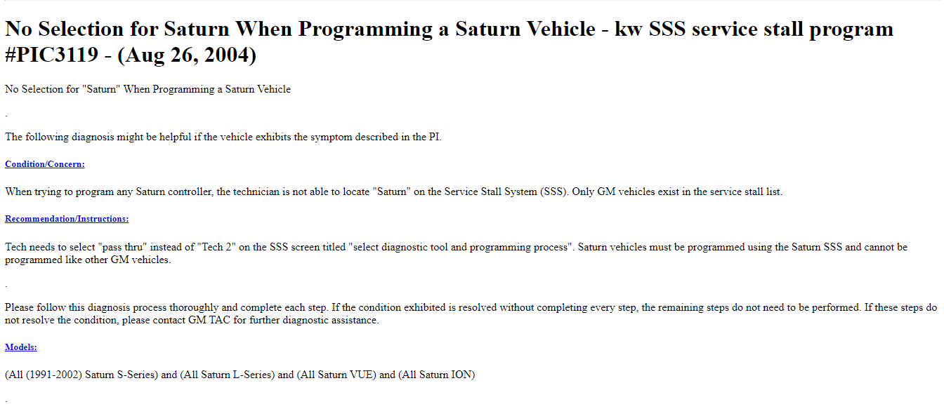

I'm not sure what was done. The only thing I can think of is if he isn't setting the scan up correctly. Is he selecting pass-through rather than tech 2? Otherwise, he won't find Saturn as a selection on the tech 2 scan tool. He needs to select "pass thru" instead of "Tech 2" on the service stall station (SSS) screen titled "select diagnostic tool and programming process". Saturn vehicles must be programmed using the Saturn SSS and cannot be programmed like other GM vehicles.
I attached the directions below.
Let me know if this helps.
Aug 2, 2022 at 2:57 PM

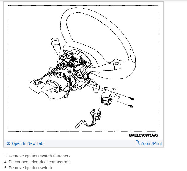

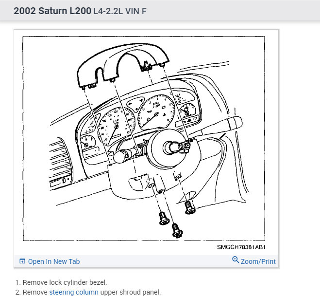

Supposedly the technician followed the correct procedure although this was secondhand information from the owner of the shop. The technician came from a Chevrolet dealership, and I have not met him. I went to get both BCMs, thinking I would return the new one to O'Reilly for credit. I also thought I would inspect the old unit for bad solder connections, etc. Well scratch that--it is all subminiature surface mount components. I don't have the tools or expertise to mess with that. Long story short, before they removed the old unit, which they had reinstalled after no success with the programming, the old BCM worked--door locks, dome light, power windows, etc., all working. They told me that they had started the car the day before and it was running normally. I read that the BCM could do weird things if the ignition switch is bad. The ignition switch is badly worn--I can remove the key when the engine is running. The engine cranks and even turns over until the key is released to the ON position. Then the engine dies. I ordered a new Delco switch (but not the lock cylinder assembly) thinking that this might be worth a shot. I am thinking the BCM may not be bad after all and if the ignition switch is bad maybe the new BCM wasn't getting enough voltage to allow programming. Any suggestions would be appreciated. Thanks! Corey
Aug 7, 2022 at 7:04 PM
  • 110,240 POSTS
Cory,

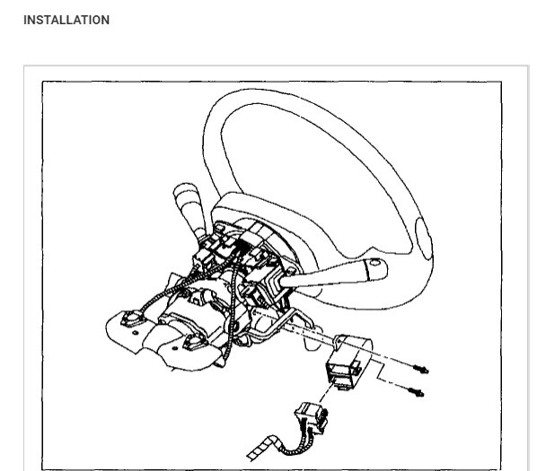

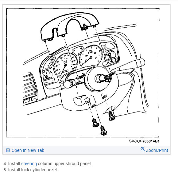

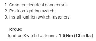

Anything is possible. If the old BCM is now working after being reinstalled, my first thought would be a poor connection. As far as the switch is concerned, it is possible that it is causing issues. However, keep in mind that the key being removable without turning the key off is a faulty tumbler.
I don't know if you need it, but I attached the directions for replacing the switch below. It appears to be very straightforward.
Let me know if that takes care of the issues.
Aug 8, 2022 at 1:19 PM

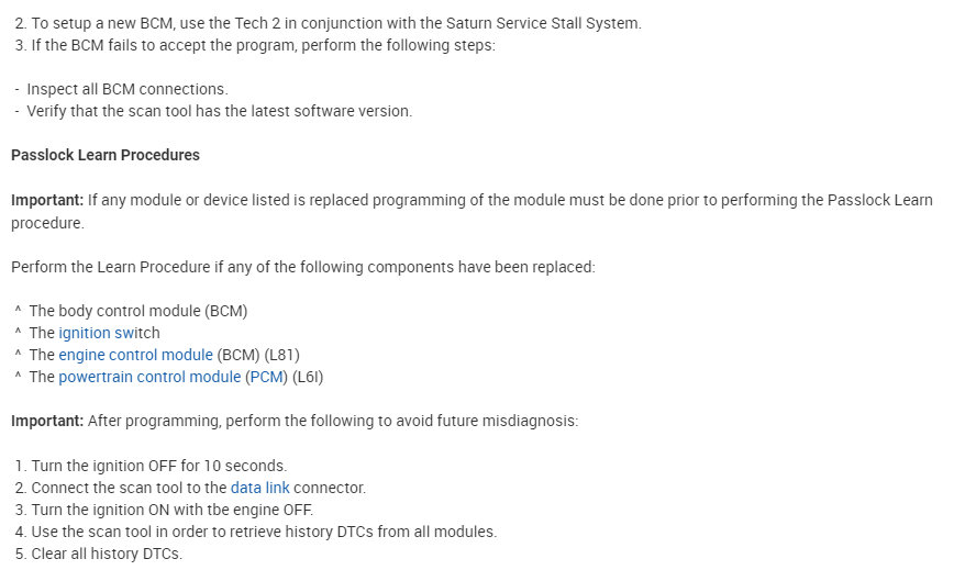

The saga continues. The shop brought in another technician who had a different programming device. Again, the scanner recognized the new BCM but attempts to program the unit resulted in no communication or response. Could I have a defective OEM Delco part? They declined to install the new ignition switch I provided (also a genuine AC Delco OEM part) saying the switch wasn't the problem and that the tumbler was worn out. The main ignition key is obviously worn and can be removed with the engine running but the valet key works normally since it has no wear. IMHO it's just the primary ignition key that is worn. The shop said if I replaced the tumbler it would invalidate the car's anti-theft system and that would be the point of no return. My understanding was that older GM cars could have the tumbler replaced without impacting the anti-theft system. Maybe I misunderstood. Problem is that these guys have little experience with Saturns. I am going to pick up the new BCM and return it to O'Reilly in hopes of recovering my $400 but beyond that I am at a dead end.
If the BCM interacts with other modules, and I'm sure it does, could the problem be elsewhere, say the ECM or an anti-theft module if there is one? I may have told you that I had to ride 20 miles on the rim of a rear wheel after I had a blowout on the interstate. The rim was shaped like a triangle by the time I got home and even at 10 miles an hour the car was shaken badly.
Should I have the car towed to another shop and start the process all over again? With the old BCM reinstalled the car starts and runs...sometimes. It's like Russian roulette I am two steps away from having to junk this car. It has 175,000 miles but otherwise is in good shape. There was an issue with the timing chain oiler (GM recall) but that was dealt with years ago, and what a surprise, the dealer said my VIN was not on the recall list. I had to pay $1500 out of pocket. The truth was every 2002 Saturn had the oiler problem. I should have contacted GM before caving and paying the dealer. They installed a kit which was provided by GM per the recall. I think the dealer made $1,500.00 on the deal. But I digress.
Aug 18, 2022 at 10:03 PM
  • 110,240 POSTS
Yes, there are other modules. I have a question. Did any of the techs have the Saturn Service Call programming?
Take a look below. I feel they don't have the right equipment.
See pic below.
Aug 19, 2022 at 2:33 PM
