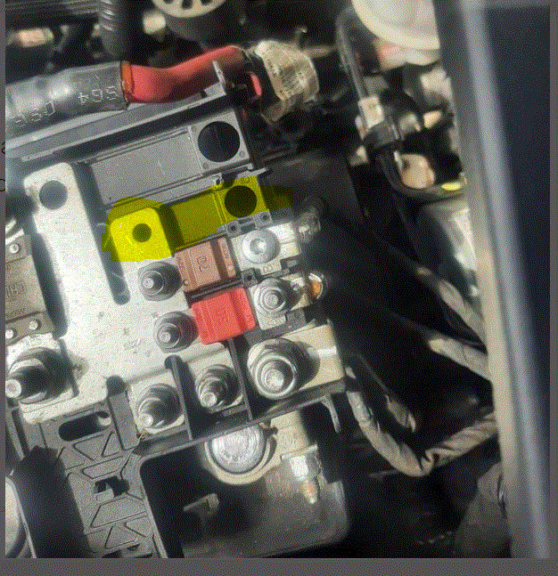

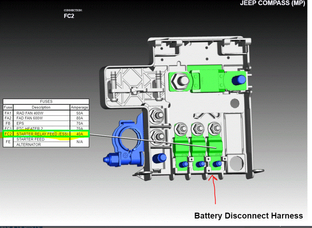

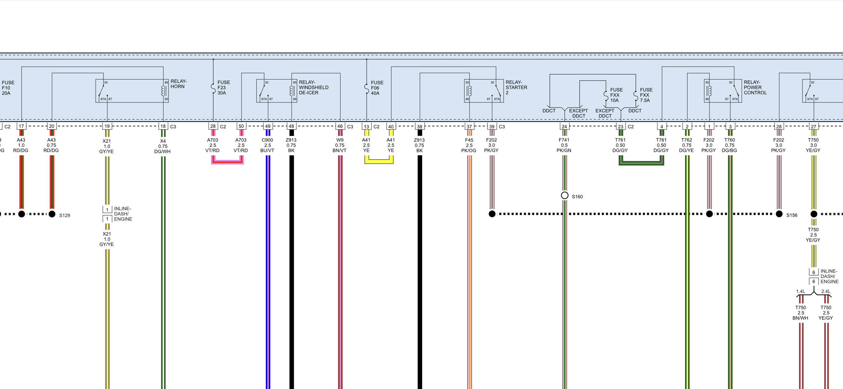

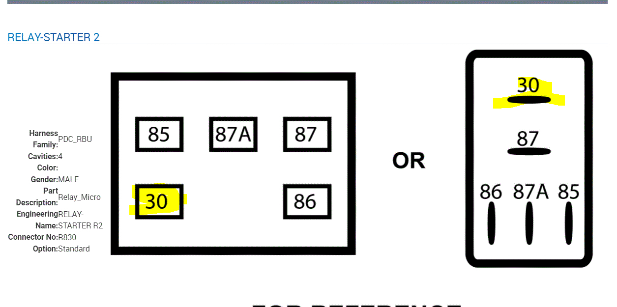

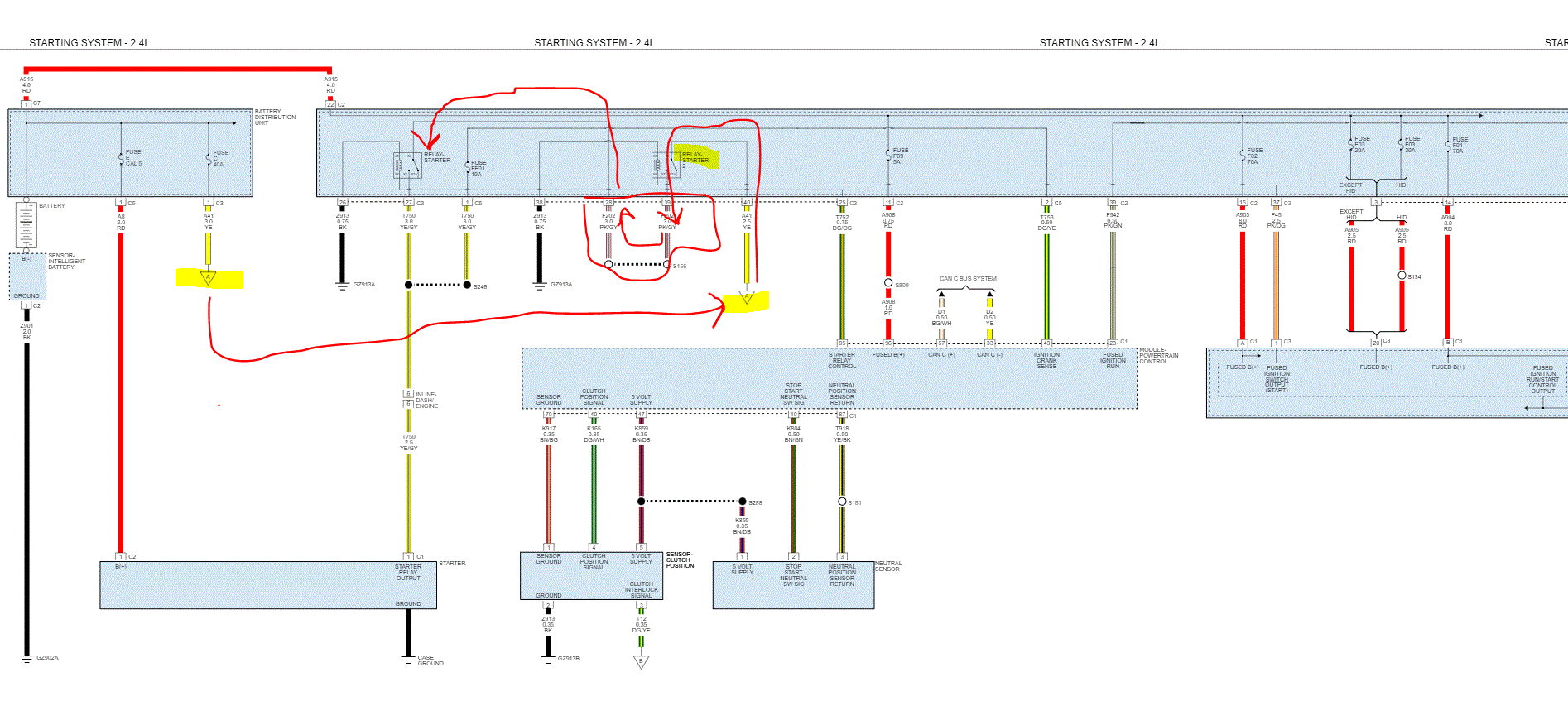

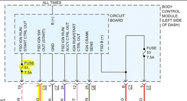

If the yellow wire has power now, does the pink/orange wire have power to the relay? That power comes from the ignition switch and is what causes the relay to actuate and send power from the yellow wire.

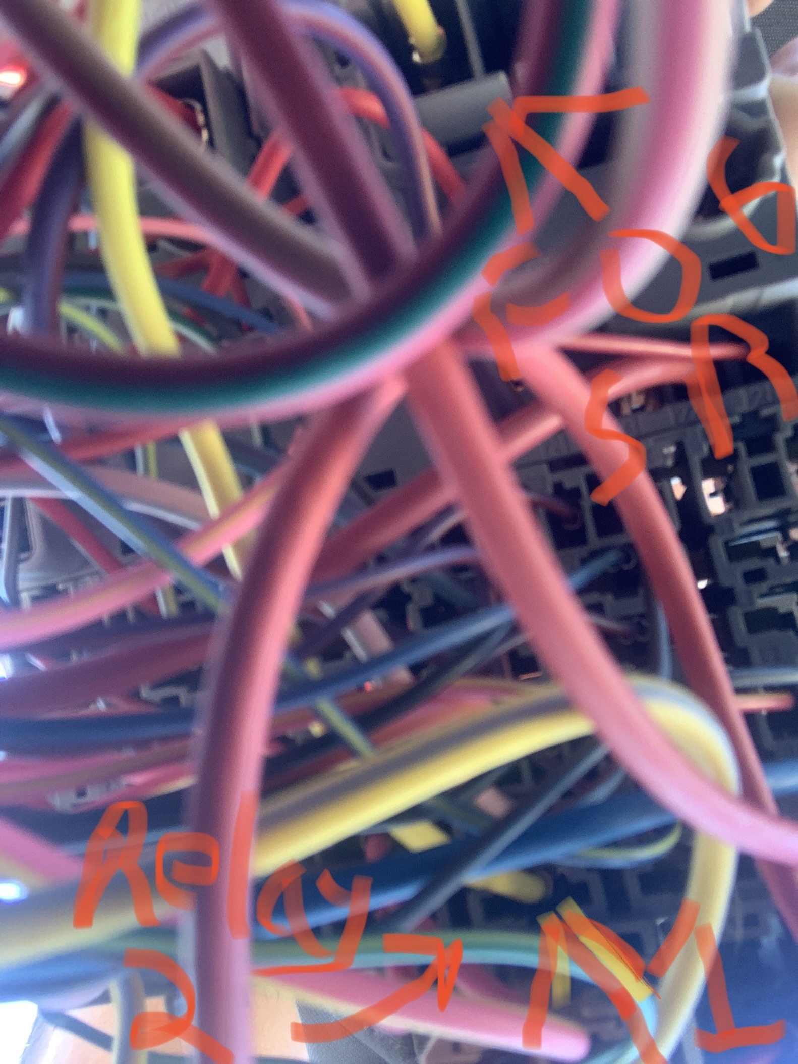

It was late when I got it wired up and tried it and when it didn’t work, I just gave up. It was clicking at the BCM at my feet when I would hit the start button.

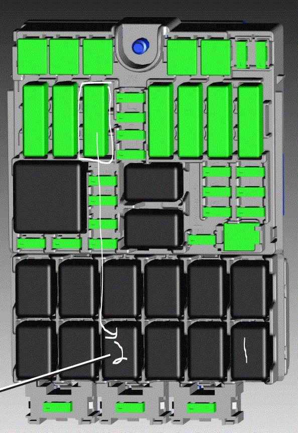

If you feel the BCM clicking, check to make sure the 7.5-amp fuse (fuse 51) is good at the BCM (fuse panel in vehicle).
See pic below.
