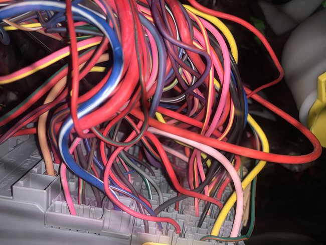

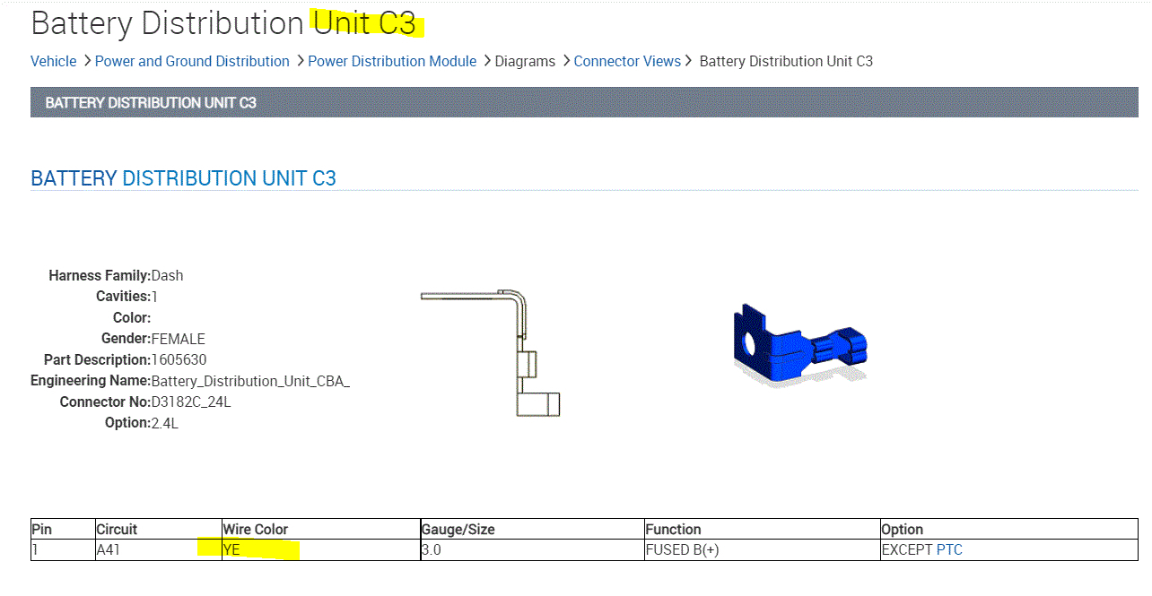

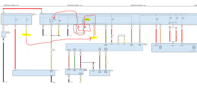

I need to know where the wire that goes to the 40-amp green fuse that connects to the battery, where does the other end hook up. I am the second owner and don’t know why but a few wires are put back with just self-tappers and the wire to this fuse fell off and I cannot start my vehicle. I had no issues until it fell off. I just need somebody to either tell me or go and look at their compass and tell me.
Jan 15, 2022 at 4:57 AM
  • 110,244 POSTS
Is the wire yellow in color? If it is, I suspect it is from the battery distribution unit to the power distribution center and powers the starter relay 2. See pic 1 below. That shows the wire I am referring to. Pic 2 shows what it should look like at the battery distribution. Pic 3

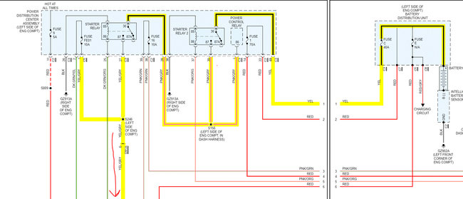

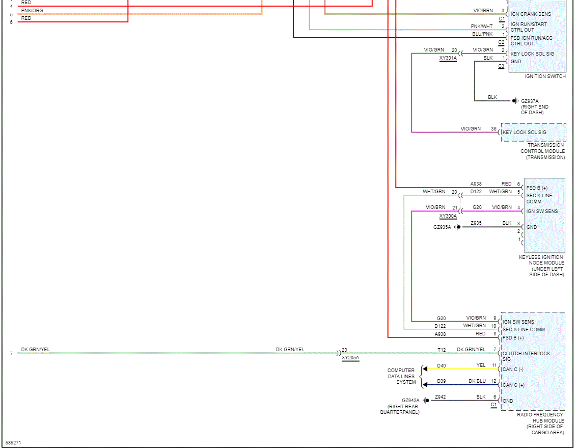

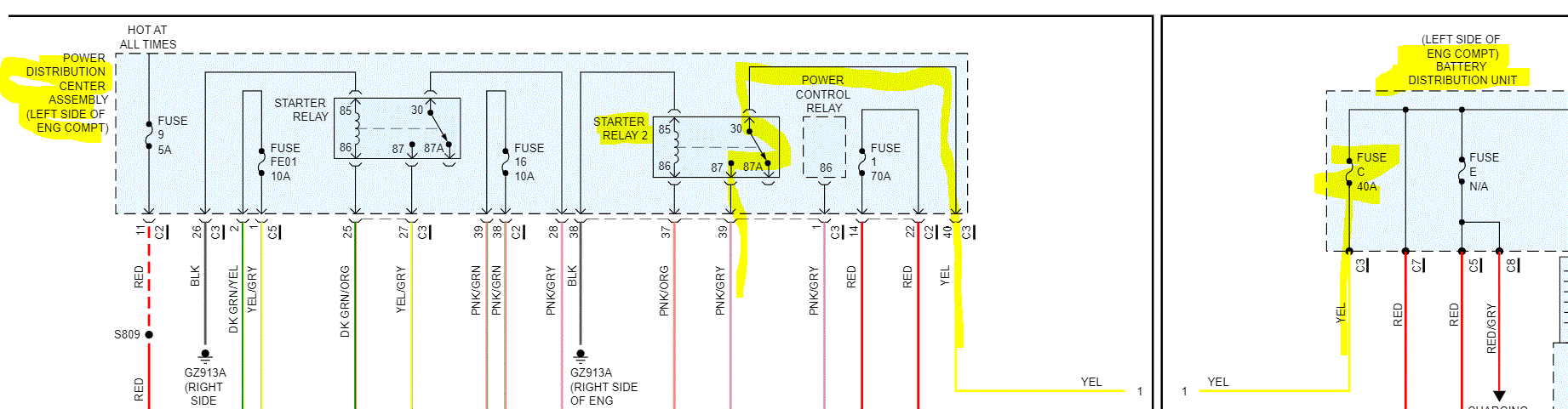

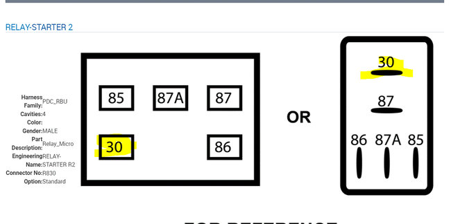

If you notice in pic 1 both distribution boxes indicate "C3" which is the connector number. Pic 2 shows the connector at battery distribution and pic 3 shows where it should be at the power distribution section. connector 3, pin 40.
So, the yellow wire should go from the battery distribution unit to the power distribution box. The 40-amp fuse is in the battery distribution box.
Let me know if this helps or if you have other questions. Note: If I am correct and it is the yellow wire, if Fuse C is good, that wire will have power at all times, so try not to short it. I would remove the fuse before starting to work on it.

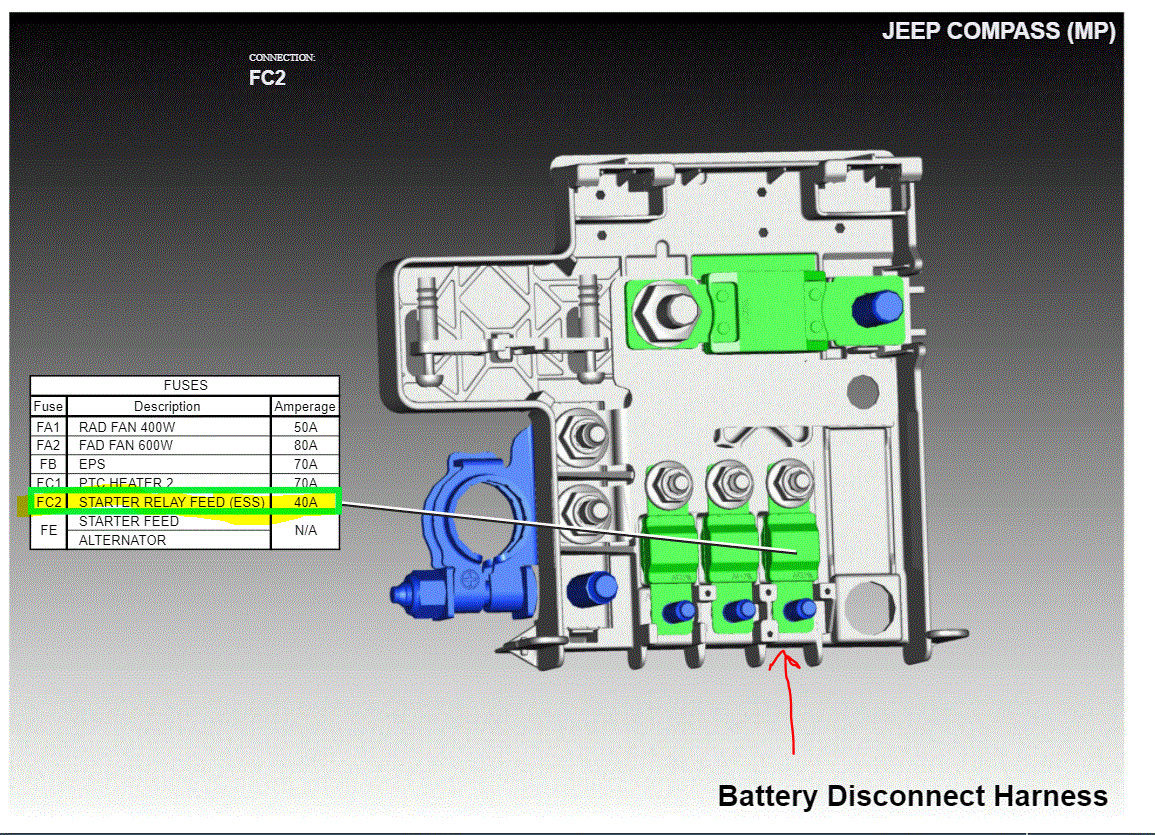

Additionally, the last pic shows where the wire should attach to the battery distribution center.
Here is a link you may find helpful when working on the wiring:
Let me know if this helps. Also, if the wire is attached with a self-taper at the power distribution box, that is a concern. Actually, there should be a stud in the battery dist that it bolts to. At the power distribution, the connector should have a connector for it to just plug in. If you can, take a pic of what you are seeing and upload it for me to see.

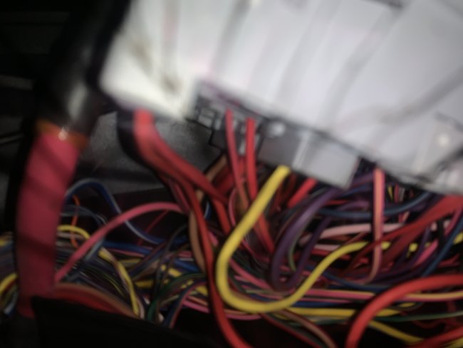

I am not sure of the color because it completely came off of the c3 connector. Before this happened it was loose and wouldn’t start and the next day completely just fell off.
Jan 15, 2022 at 9:42 AM
MECODY
  • 27 POSTS
I have honestly found the yellow wire in the bundle and in the fuse box in the engine compartment. But I cannot find the wire connector that hooks to the battery distribution itself. The fuse went with it. So if I start with the unit connection inside the dash and track it down I should find the end possibly?
Jan 15, 2022 at 10:07 AM
  • 110,244 POSTS

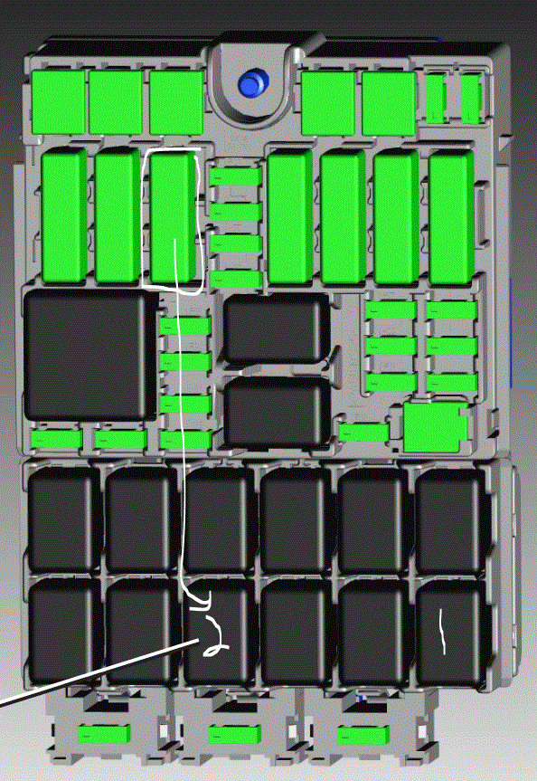

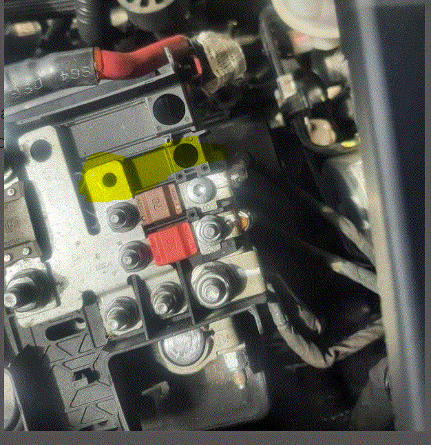

The yellow wire should be between the battery distribution (your pic above) and the power distribution under the hood. See pic 1 for location. It should be right behind (approximately) the battery. The yellow wire is direct power from the battery, which is fused but powers a circuit in the power distribution box.
Since the nut had to fall off for the fuse to come off the terminal, chances are the fuse is still attached to the wiring. Just make sure when you replace it to get the correct nut to hold in in place.
Let me know if you find the wire. It won't be a long wire. It's there somewhere unless it fell out of the power distribution box as well, but that's unlikely.
By the way, which is certainly why the starter won't engage. LOL
Let me know,
See pic below.
Jan 15, 2022 at 10:31 AM

Okay, so the only yellow wire that goes to where you highlighted ties right back into the distribution box. I have looked high and low, and the wire is not there pic 1 is the bottom of the box turned sideways and pic 2 is where it connects back to the box. This is the only plain yellow wire. Maybe the second picture shows where it is supposed to exit the box and run to the battery, but that wire is missing.
Jan 15, 2022 at 10:54 AM
  • 110,244 POSTS
At the fuse box (power distribution in the pic you attached) that wire should connect to where the starter relay is located. If you open the box, does it appear that is where it goes? If you follow that wire in the opposite direction, where does it go? It should return to the battery distribution box where the fuse is missing.

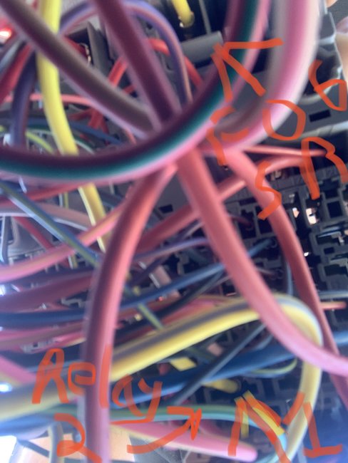

It’s like 3 inches long and that is the only wire connected to the back for the starter relays.
Jan 15, 2022 at 11:44 AM
MECODY
  • 27 POSTS
If you look at the second picture of the back of my box I posted earlier, it’s like an extra spot where the yellow wire connects. Could it go here, and it just be completely missing?

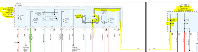

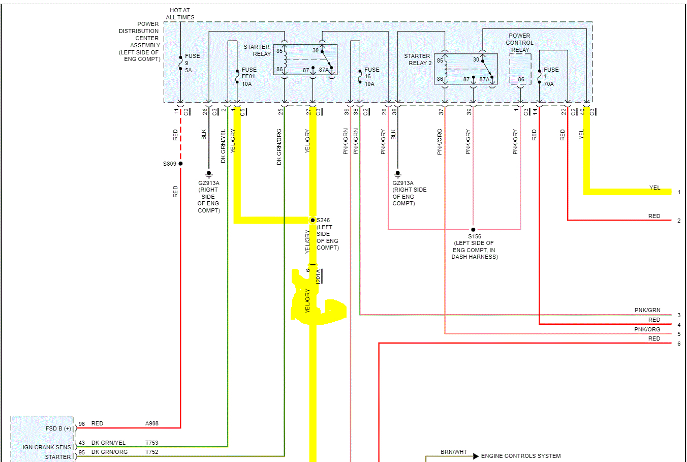

No, that wouldn't be a jumper wire. Looking at the schematic, the yellow comes from the battery to relay 2. When relay 2 is triggered, power from the yellow wire runs to the pink wire with a gray tracer which goes to starter relay 1.
The only wire colors at the starter relay (1) should be:
pink with a gray tracer
yellow with a gray tracer
dark green with an orange tracer
black
If the solid yellow wire from the battery isn't there, it must have fallen out of the vehicle.
Starter relay 2 should have the following wire colors to it:
Yellow
Pink with a gray tracer
Pink with an orange tracer
Black
Take a look below. Note that the power to relay 1 isn't provided directly from the yellow wire but rather indirectly when relay 2 is triggered.
Let me know if this helps. Also, if you can, take a pic of the box from a straight-on position of the bottom. I'm struggling to orient myself looking at it from the side.

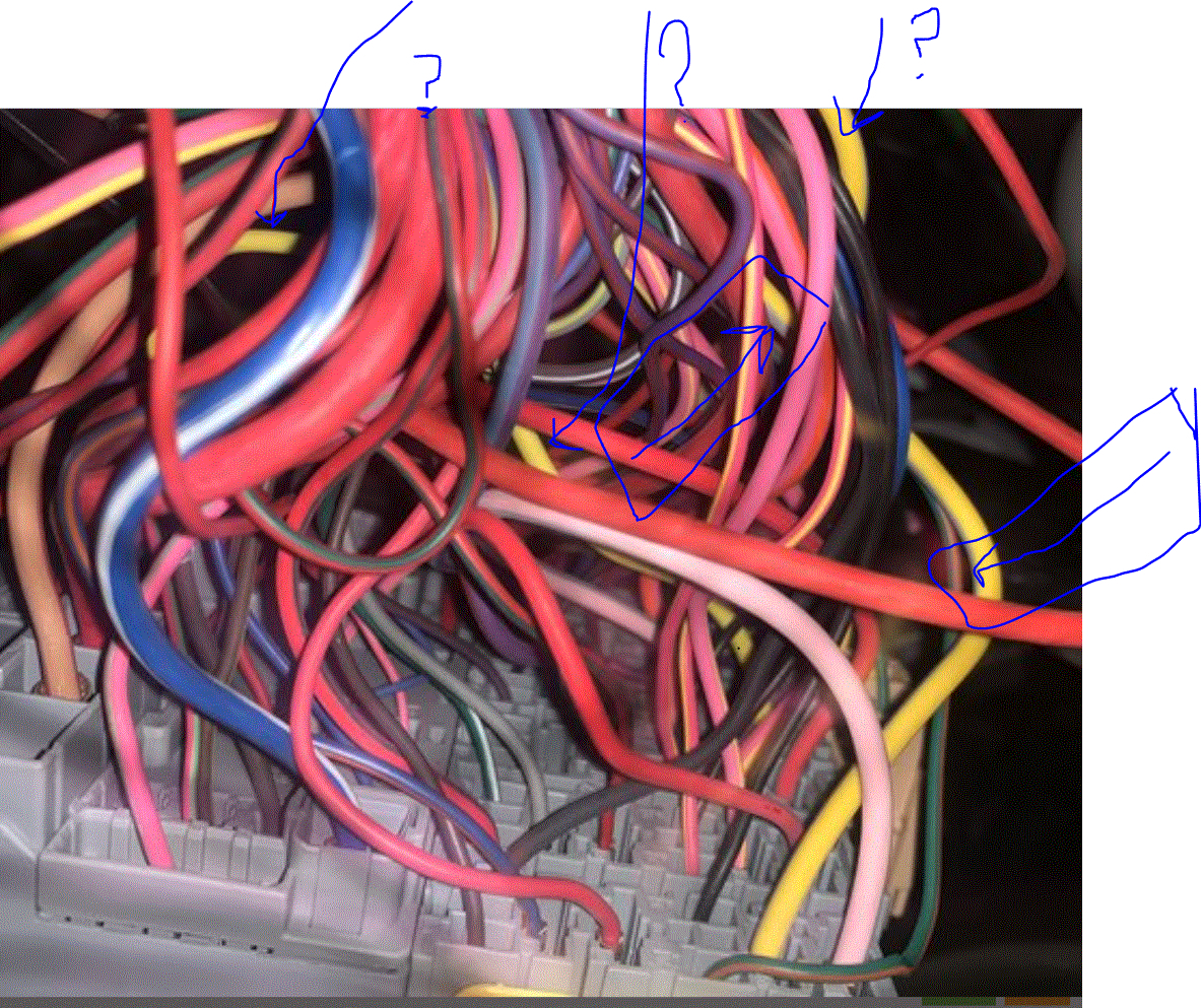

Also, I attached one of your pics below. I pointed and circled in two places which I believe are yellow with a gray tracer. That is what goes from relay 1 to the starter. I have arrows pointing to others. Are any of those a solid yellow wire?

The full yellow from starter relay ties in to starter relay 2, which looks to me to have to spots with the yellow wire that should run to the battery is not there.

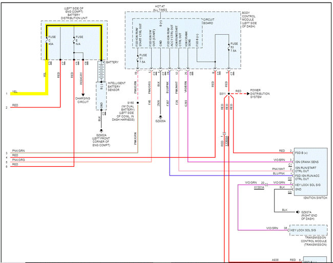

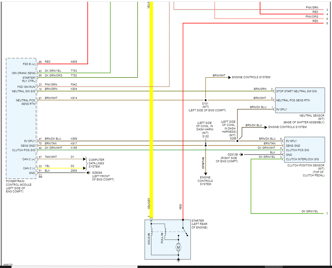

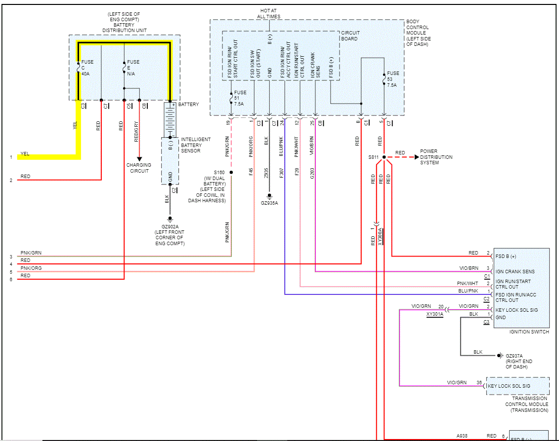

Not being there makes this difficult. I attached the entire wiring schematic for the starter circuit. According to the schematic, there is one solid yellow wire that runs from fuse C in the battery fuse box directly to relay 2. From the starter relay (relay 1) there is a yellow wire with a gray tracer that goes to the starter itself.
Take a look through this. I highlighted the yellow wire and the yellow/gray. The schematic was two pages long, but I had to cut each page in half to make it readable for you. I overlapped so you can follow from one to the next.
Take a look through them and tell me if any of the wires from the starter relay 1 are solid yellow. They shouldn't be.
I spoke with another tech. We agree if there is a yellow wire going to relay 1, someone had to have changed things to make it work with something like an aftermarket remote starter. By chance, is there one in the vehicle?

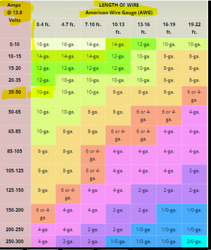

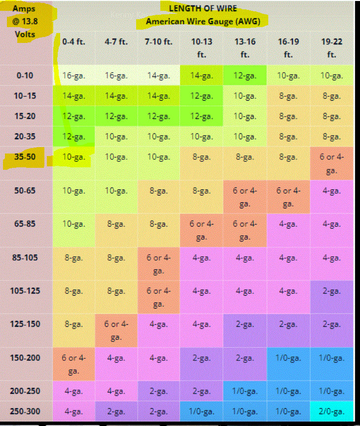

I have bought the 40-amp fuse just unsure about the wire part. Any idea how to tell what gauge wire?
Jan 19, 2022 at 10:10 AM
  • 110,244 POSTS
Absolutely. To determine wire gauge, it is based on the amperage it will receive and the length of the wire.
In this case, I don't suspect the wire is longer than 4 feet. So, I would use a 10-gauge copper wire. Don't use aluminum, tin, or copper clade wire. Make sure it is 100% copper.
If you look at the attachment below, I included a chart and highlighted what I'm seeing will work. Of course, you can get 8 gauge for added protection, but 10 gauge will work just fine unless for some reason the wire is longer than 4 feet. LOL Also, I just looked at it again and noticed 10 gauge will go up to 50 amps x 10' max length.
I hope this helps. Let me know how it works for you.

I'm not familiar with the schematics you have. I went back and looked up the manufacturer's schematic and attached them below. Normally, I don't use these because they are more confusing. However, if you look at the OEM schematic below, it shows the same as what my original one said. Yellow is from fuse C (40 amp) and goes to relay 2. From there, it goes to a pink/gray wire to relay 1. Next, it travels through a yellow/gray wire to the starter motor. The yellow/gray wire is the trigger wire to engage the starter motor. The pink/gray wires connection is indicated with a dashed line. In many cases, the position of one internal switch (relay in this case) will affect the position of another as between two relays. Such switches are called ganged switches and are symbolized by connecting them with a dashed line.
Not being there with you makes it much more difficult. However, all I have is the manufacturer's schematics. That is what I need to go with. If you have a jumper between the yellow wire to relay 2 and direct to relay 1, that is usually an indication that someone had installed a remote starter system. I can't guarantee it, but that is what I suspect. That would also explain why the wire/fuse was loose and fell out. Chances are when it was removed, they weren't too gentle with it. Again, that is only my theory. I wish I was there to help.
Let me know if this helps you in any way.

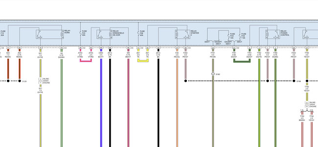

Hello, okay, so it’s not jumped from the actual “relay” at t20. Where the wire yellow wire hooks to relay 2 it jumps to f06 starter relay which is an orange 40 fuse.
Jan 22, 2022 at 10:07 PM
MECODY
  • 27 POSTS
I stayed up late looking through every schematic Chilton has, like what you have it shows it going from the battery to relay 2. But fuse f06 starter relay fuse I cannot find which wire runs to it other than what I just showed, and they have run that to it. And you don’t understand how much I appreciate everything you have helped me with.
Jan 22, 2022 at 10:37 PM
MECODY
  • 27 POSTS
And I’m sorry I was lost earlier in this because I thought the starter relay was actually just that mega fuse instead of the relay, but two wires can’t go in the same slot on relay 2 can they?
Jan 22, 2022 at 10:42 PM
MECODY
  • 27 POSTS
This is about as good as I can get. I marked where the wire jumps from relay 2 to the starter relay fuse at f06.
Jan 23, 2022 at 12:09 AM
  • 110,244 POSTS
Hi.
Do me a favor. Check the yellow wire from F6 to see if it has power. I suspect it isn't powered because of the missing link in the battery power disconnect box.
I guess it's possible that they may have run the fusible link to another fuse (F6) then to the relay. If there isn't power, we need to get power to f6. Then it will go to the relay with the wire you showed me. I'm just not sure why the schematics are different.

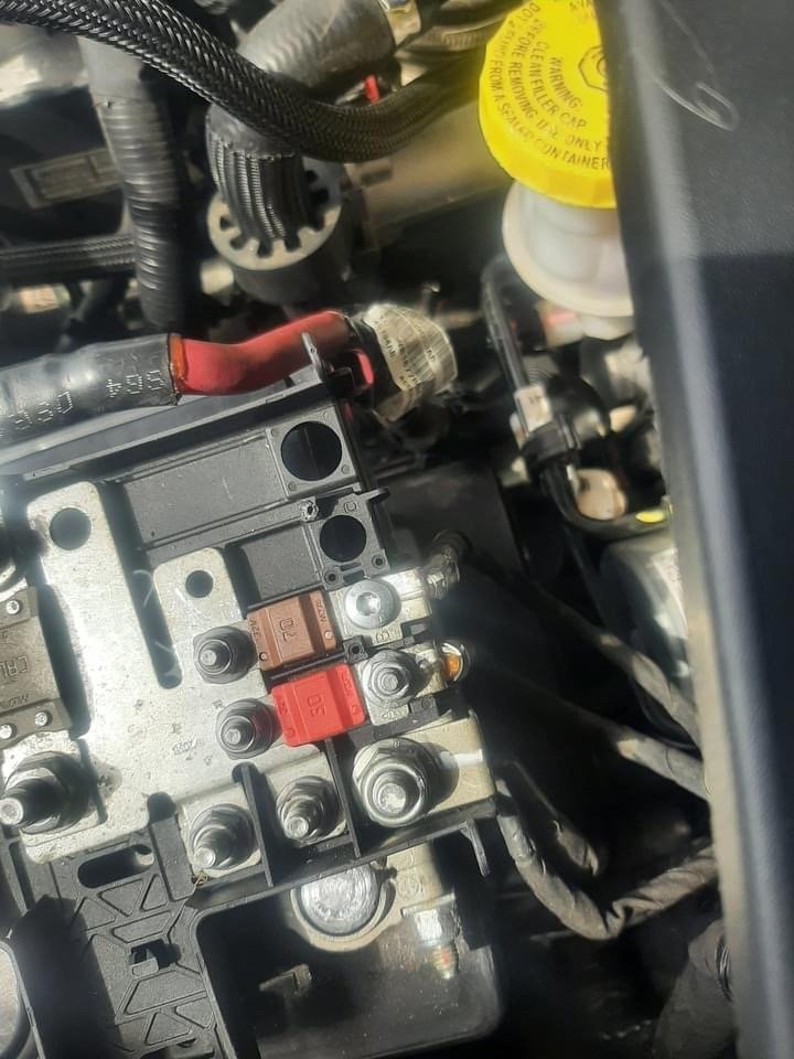

Pic 3 shows the two relays, and the green fuse indicates the starter fuse (40 amp). Is that where the yellow wire is running from to relay 1?

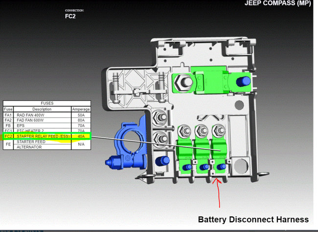

Since there is a 40-amp fuse in the battery quick connect box and basing it on what the wiring schematics are showing me, I would run it from the battery box to the relay. The yellow jumper doesn't show up in any of my schematics, but if there is a short, it should cause the 40-amp in the battery box to fail. Try it that way and let me know if it works.
I attached a pic below showing where the 40-amp fuse is I'm referring to.

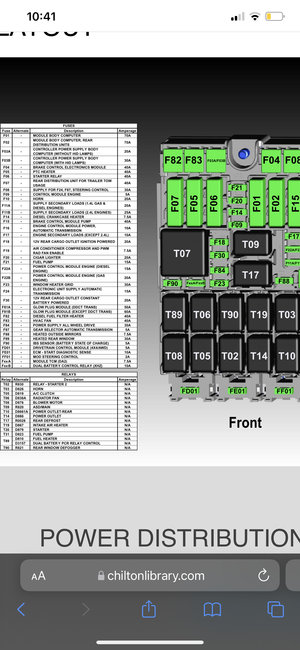

When you applied power to the relay, was it via pin 30? See pic below. There are two options for pin layout, but it's easy to tell which you have by just looking.
Also, could you give me the last 8 digits of the VIN number? I need to see if there is something different with your vehicle and this may help.
See pic below.
