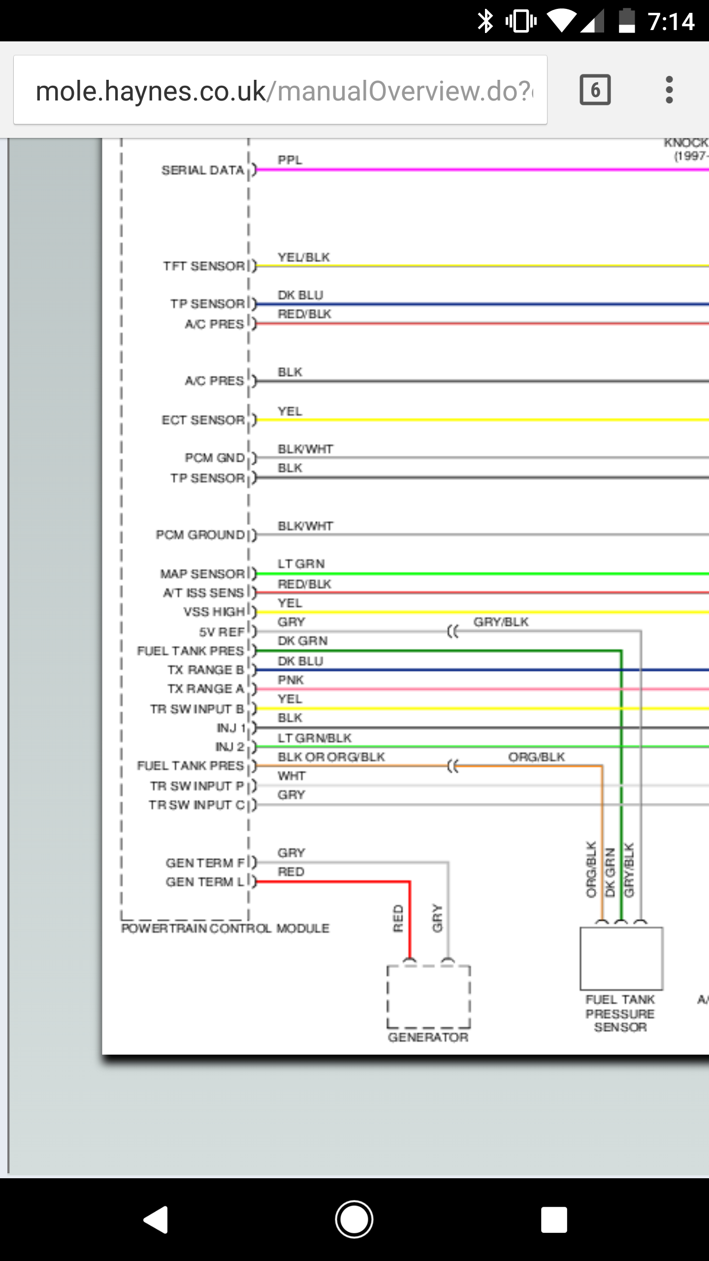

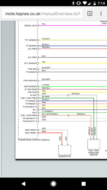

How many wires are there in the small connector at the side/rear of the generator? There will be a brown wire. Are there any others?
Feb 7, 2017 at 6:36 AM
PSBRANDON
  • 8 POSTS
There are two wires (see diagram). I will try what you suggested.
