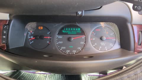

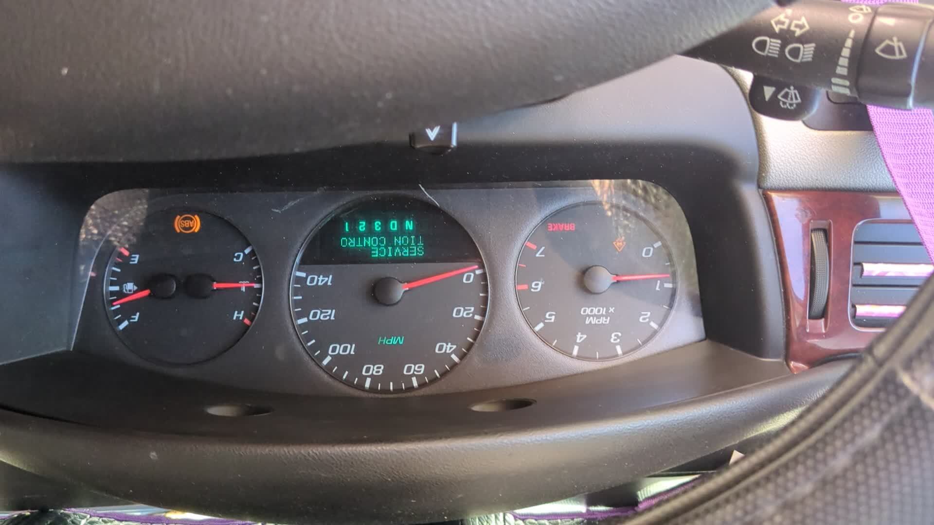

Check battery charging system message and then battery saver active message. Battery light is on solid. Car starts chiming then the ABS light, the traction control light comes on and then the vehicle shuts off. Replaced the alternator and the battery had them both tested 2 times and battery was fully charged. Drove the car for about 4 miles and then the messages started again and then it shut off. But the interior lights come on when you open the door, and the odometer shows the milage, but it won't start.

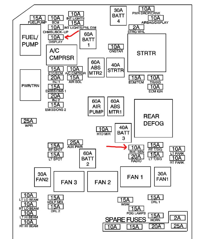

Here are the two fuses to be checked. RVC SEN fuse 10 amp and the DISPLAY fuse 10 amp as well under the hood. Check out the images (below). Please let us know what happens.

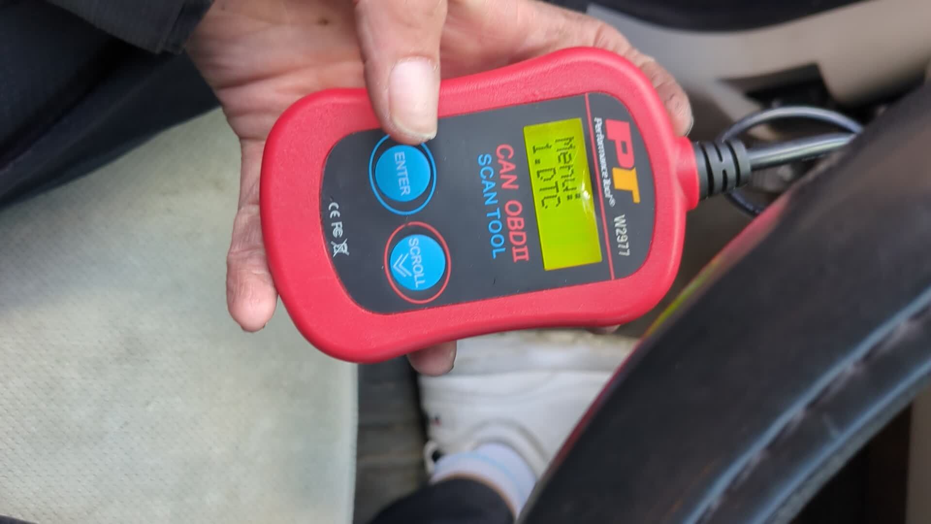

I checked the fuses, and they were good. I tried to jump start it and I also tested the circuits as well. I used a code reader nothing came up. Before I was able to get back out of the car to disconnect the jumper cables I noticed it was trying to shut off while it was still connected to the good battery.

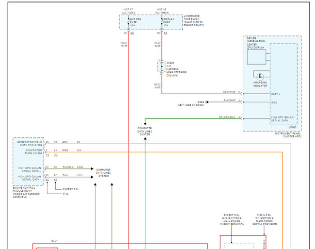

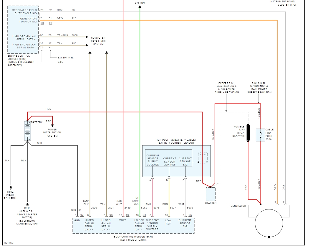

When the engine is running did you check the alternator output voltage? Here is the wiring diagrams for the charging system. You can see the instrument cluster, PCM and BCM are involved with the system. When you say there are no codes did you do a CAN scan? You can get a CAN scanner (Controller Area Network) which will work on most cars from Amazon here is a video to show you how.

The car won't turn over. When I turn the key there nothing no lights no nothing. If I connect it with jumper cables to another vehicle it'll start no problem but it doesn't stay started the battery light comes on and once the cables are disconnected it shuts off.

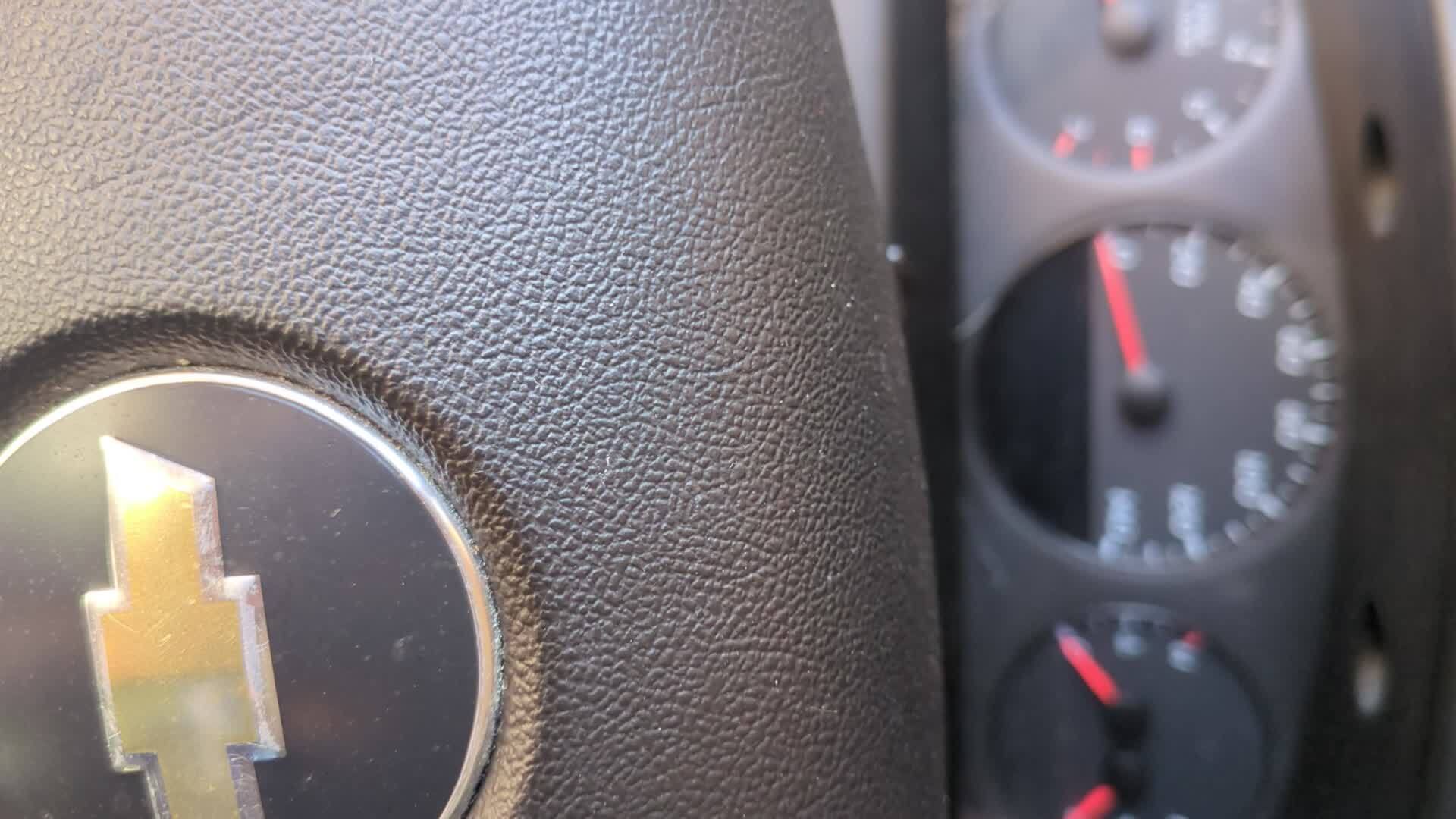

This is after disconnecting the cables was running by itself for like 5 minutes.
Sep 5, 2024 at 3:26 AM
  • 55,423 POSTS
That is a good one. I would start by having the battery tested and clean the cable ends. If the problem is still there you might have an ignition switch or BCM problem. I would do a CAN scan to see if any codes are stored. You can get a CAN scanner (Controller Area Network) which will work on most cars from Amazon.

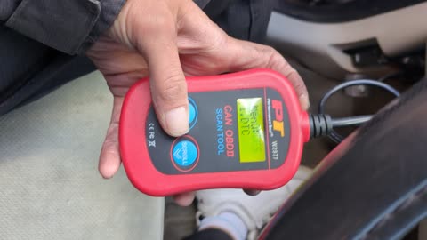

No codes keeps showing.
Sep 30, 2024 at 6:38 AM
  • 55,423 POSTS
When the engine is running does the alternator charge? Here is a guide to help us check it.
Also, that scanner says it does the CAN, but I am not convinced, some scanners say they can do the CAN but don't FYI.
