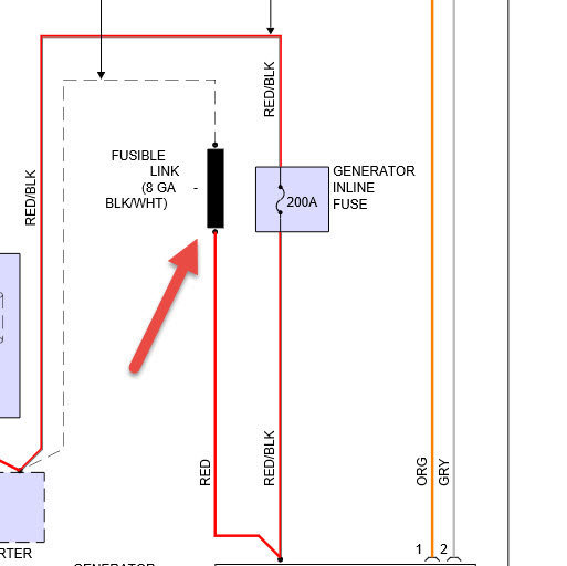

Battery is not being charged. so i unplugged the alternator connector and check for voltage the gray wire five volt the orange wire nothing no voltage. please help. i appreciate any help and i measured voltage while the car is running on the battery 12 volts.

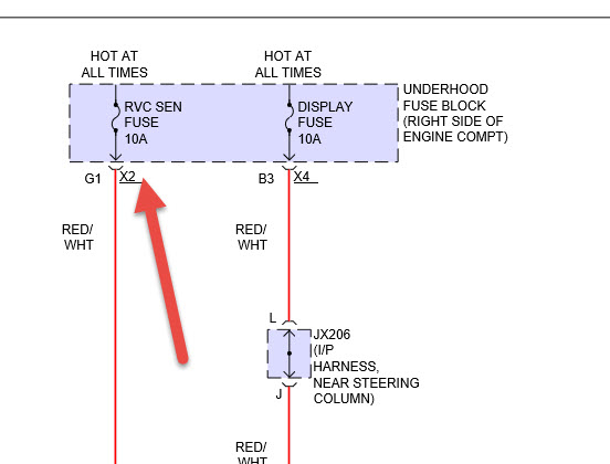

check the fusible link an d fuse in pics if that doesn't take care of it have a mechanic scan for codes as it may be a body module problem.
