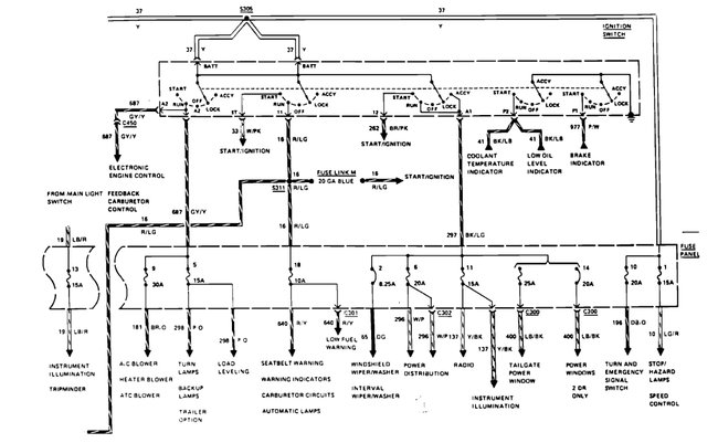

I attached a wiring schematic for you to review related to the charging system. It will help you identify the wires you have power to so you can tell me.

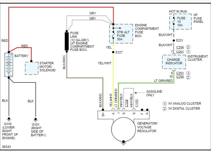

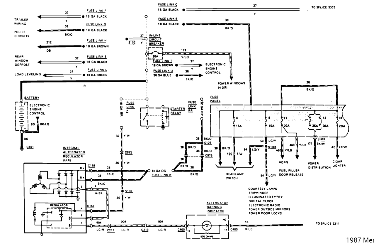

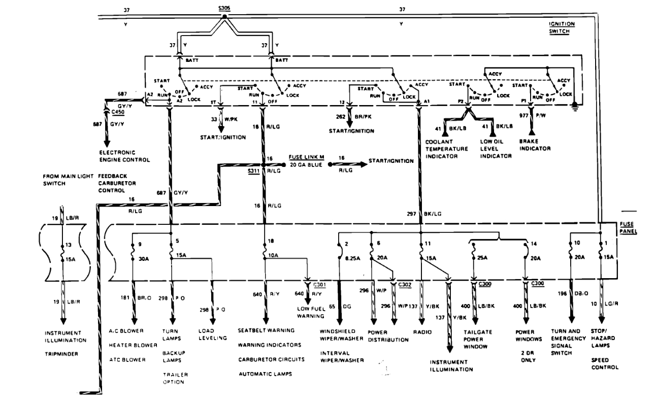

Thanks for visiting 2CarPros. It sounds like you are missing voltage on the yellow and white wire which is fed by a fusible link connected to the battery side of the starter solenoid which is on the passenger fender. it is a smaller 18 gauge fusible link. You can easily check them by pulling on them, a broken one will break easily.
If the yellow and white wire has power and the charging lamp is not on then either the bulb is blown, the inline fusible link is blown on the red and green wire, or there is a break in the wire.
I'll post the wiring diagrams below.
