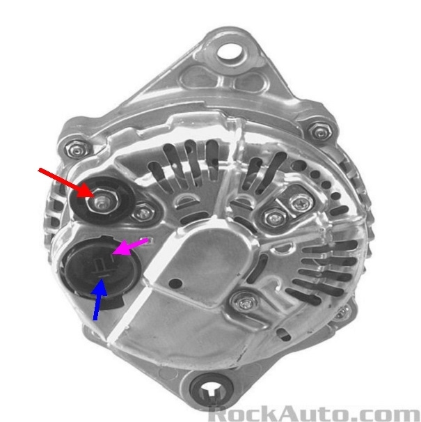

This first photo shows the back of your alternator. You'll need to measure the voltages on the two wires in the plug. Those are shown with the blue and pink arrows I added. There's two important points. First, to be valid, these voltages have to be taken with the plug connected. That means you'll poke the meter's probe in next to each wire until it touches the terminal. Second, this circuit is only live when the engine is running. No testing can be done with the engine stopped.
One of the two wires is going to have full system voltage. That will be between 13.75 and 14.75 volts when the charging system is working properly, or it will be near 12.6 volts or less when the charging system is dead. When dead and the "Battery" light is on is when these tests will give us the results we're looking for.
Once you find that wire with full voltage, it's the voltage on the other wire that we're interested in. During normal operation you're going to find between roughly 4 and 11 volts. The lower the voltage, the greater the difference between the two, and the harder the system is working.
When it's in the defective, or failed mode, expect to find 0 volts on that second wire. That is what happens when one of the internal brushes isn't making good contact due to wear.
A second possibility is to find exactly the same voltage on both wires. That's much less common, but it indicates a break in the circuit after the alternator. We can pursue that later if it appears necessary.

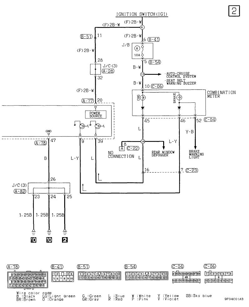

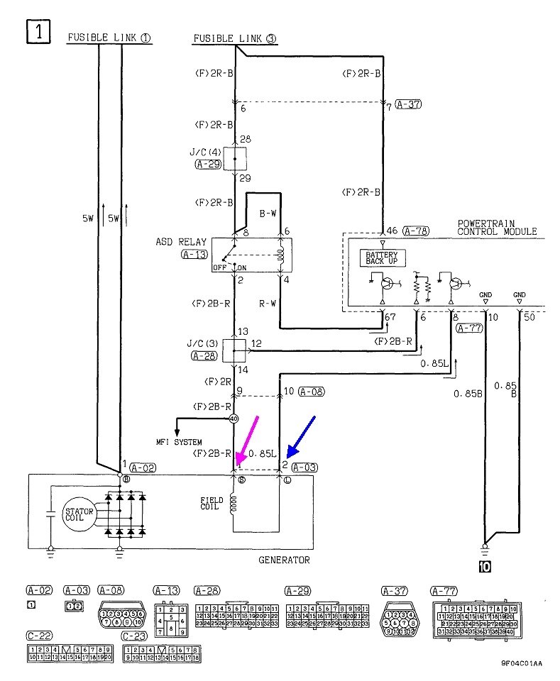

The last two diagrams are of this charging system. The blue and pink arrows are pointing to the wires you'll be taking the voltage readings on.
