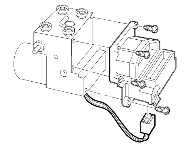

Every time I attempt to start my vehicle, the battery is dead. It started doing this about 2 months ago, and it has become an everyday thing. Also, the E- brake warning light is on. It comes on at least once every day while driving. The first time that the E-brake light ever came on was also the first time my battery ever went dead.

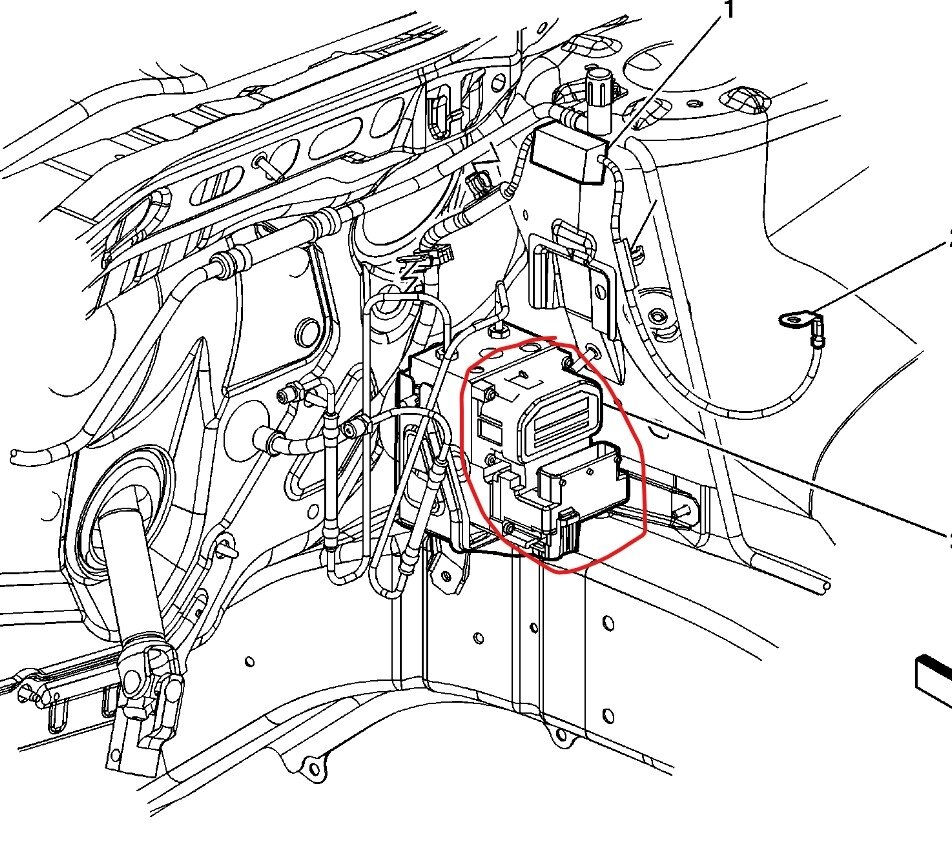

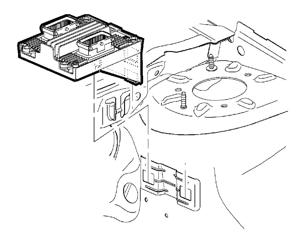

Okay, if the Brake warning is on but you haven't touched the parking brake there is a problem in the Electronic Brake Control Module. It is a fairly common failure item. They are not all that hard to change out and you don't need to bleed the brakes when finished. The first image is the module and its location on the hydraulic controller. To get to the module you normally need to disconnect the battery negative then remove the transmission control module to get clearance to work. Then it's a matter of disconnecting the electrical connector inspecting it for corrosion (corrosion in the connector can also cause this issue) and if the connector is okay, you remove the screws that hold the module to the hydraulic controller, then pull straight out to remove the module. Reverse the process to install the replacement module. Then once it's installed you turn the key on, but don't start the engine yet. Just pump the brakes twice. If they feel okay, start the engine. Now go for a short test drive and verify the brakes are still working and the light stays off. The module replacement should also cure the dead battery issue as it's a section of the module staying on that is causing the battery drain.
