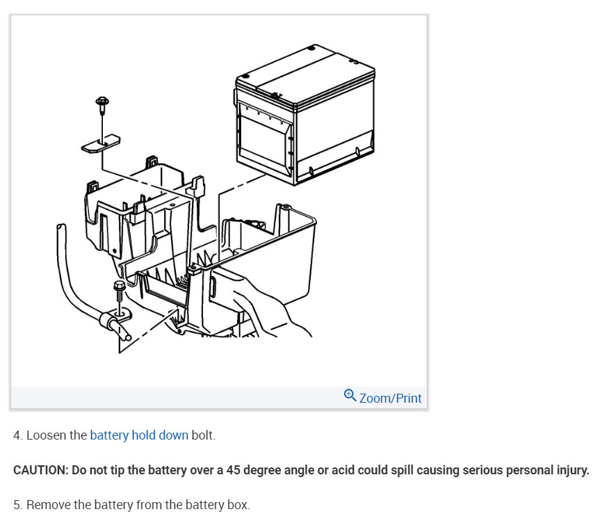

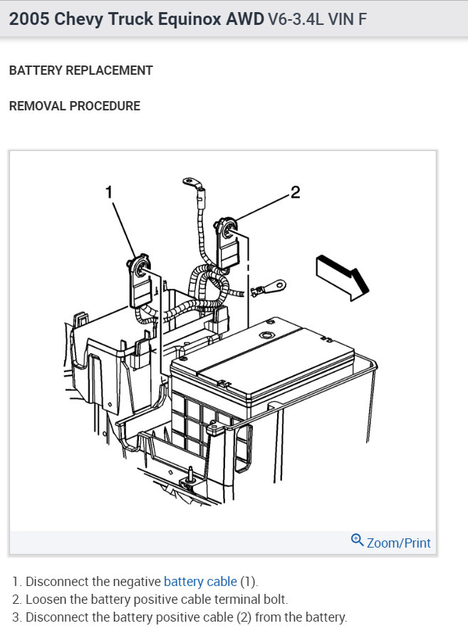

What size of battery do I need and where is it located so I can replace it?
Sep 19, 2009 at 2:10 AM
  • 110,240 POSTS
Here is a guide to help you change the battery out and diagrams below to help you see it location.
Here is the A/C Delco replacement for your vehicle
Battery
Part Number: 75-6YR
Product Notes:
6 Year Battery
All; Side terminal-Battery CCA rating 650; 75 BCI; 0600 CCA; LS, LT
Per Vehicle: 1; Years: 2005-2006
https://www.2carpros.com/articles/how-to-replace-a-car-battery
Check out the diagrams (below). Please let us know if you need anything else to get the problem fixed. Cheers
