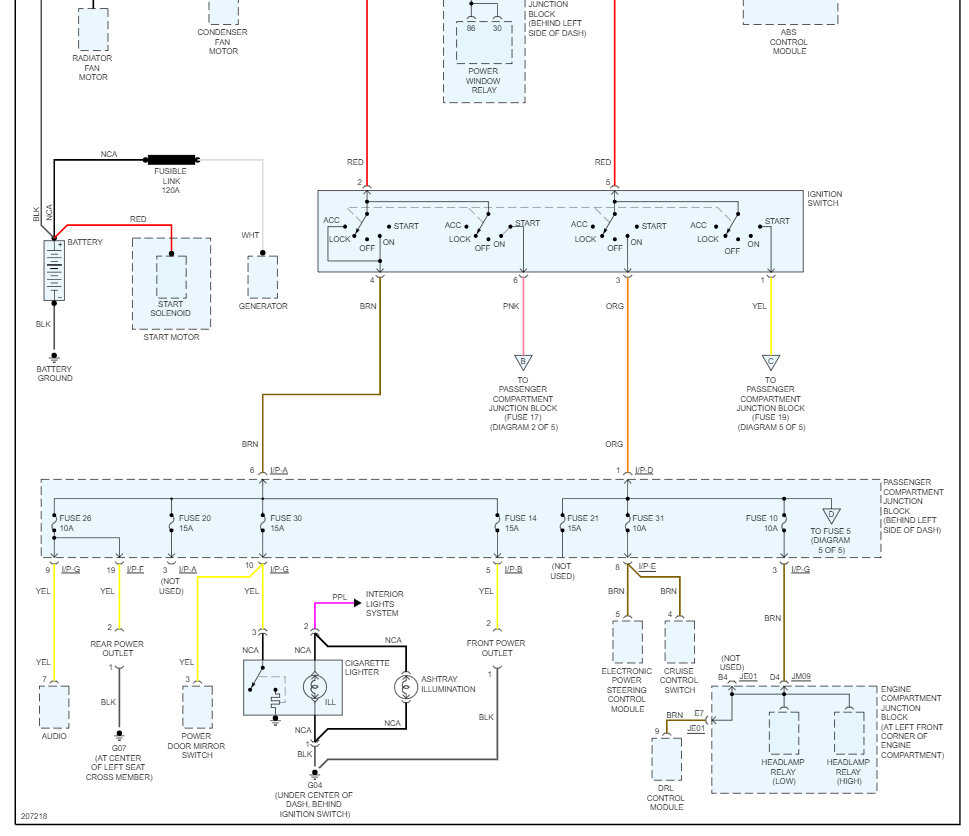

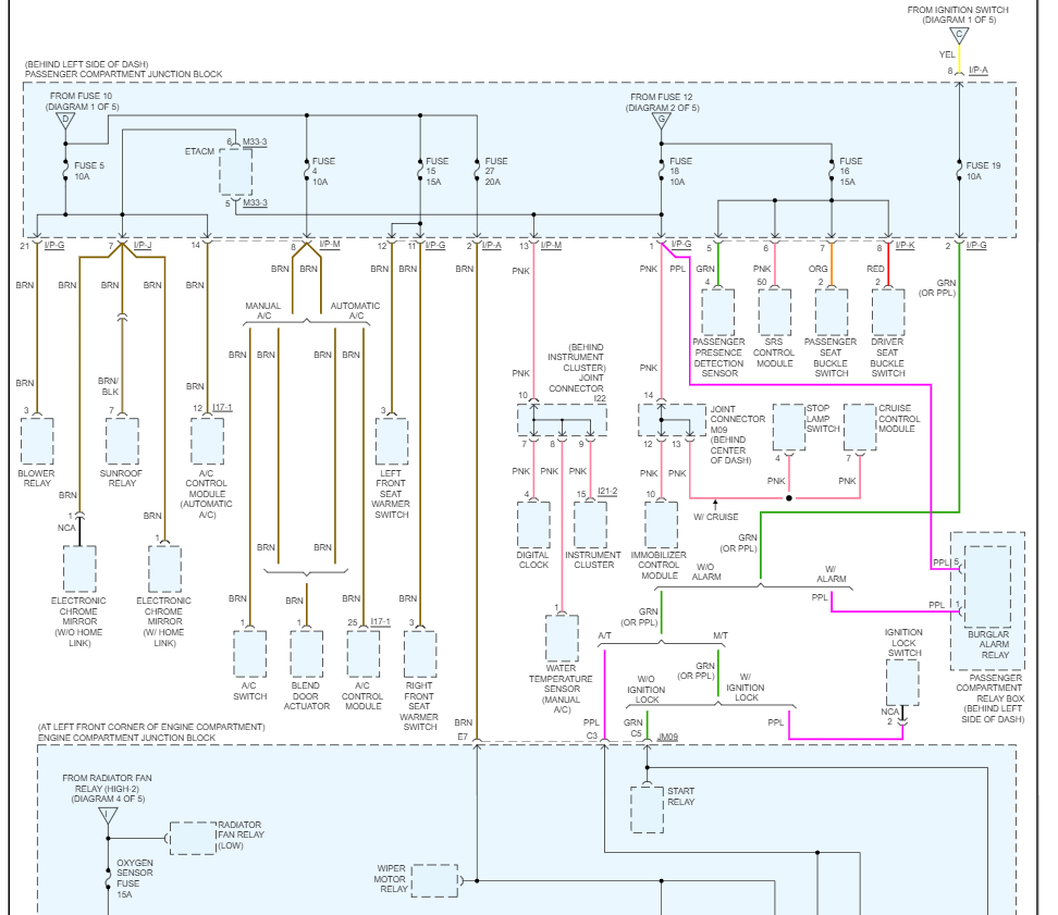

My son had a drained battery, so I went and bought him a new one. I didn't pay attention to when he put the new battery in, and he did negative to positive and vice versa. He did try to start it as well and it didn't work. That's when i checked a saw it was wrong. Once i corrected the issue the car would start. I did change out the fusible link on the positive side and the alternator is now working again. I replaced the ETACS, D/Clock, and ACon fuses in the interior. These were the only fuses that were bad. However, the A/Con fuse immediately pops when turning the key. The only symptoms I can see currently is the Climate Control Module doesn't turn on, and the cigarette power outlets do not work. I have a used CCM coming in the mail in case that is the cause. I don't find any broken fuses under the hood. A lot of the fuses under the hood, however the legs are a little black which is a little concerning. My fuse boxes look like the ones in this link https://fuseandrelay.com/hyundai/sonata-tagaz.html which is different than some videos I've watched. Any advice on other things i need to check or something I'm missing?

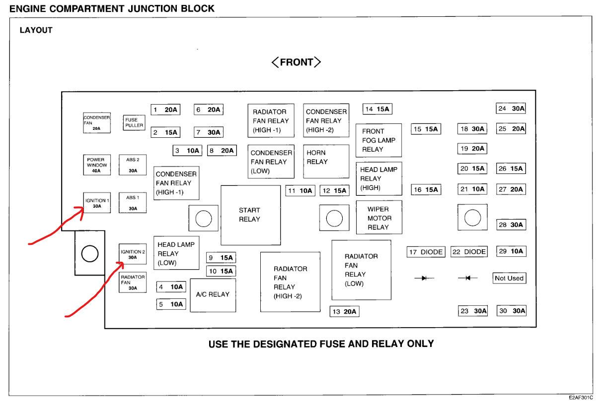

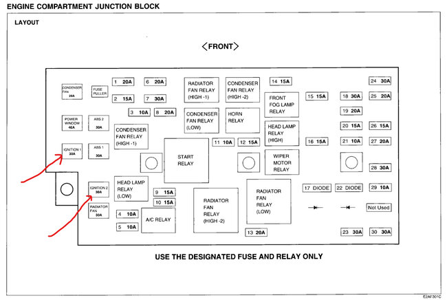

There is an ignition switch fusible link that needs to be checked for power under the hood inside the engine compartment junction block. This guide can make sure the fusible link is still good:

Hi, the 2 30-amp fuses identified check out okay.

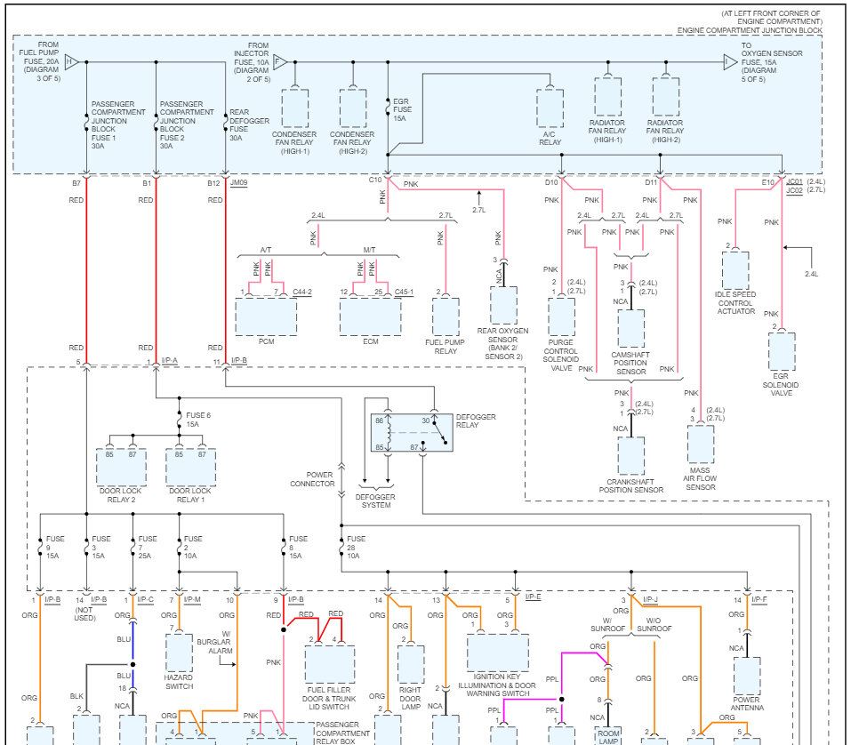

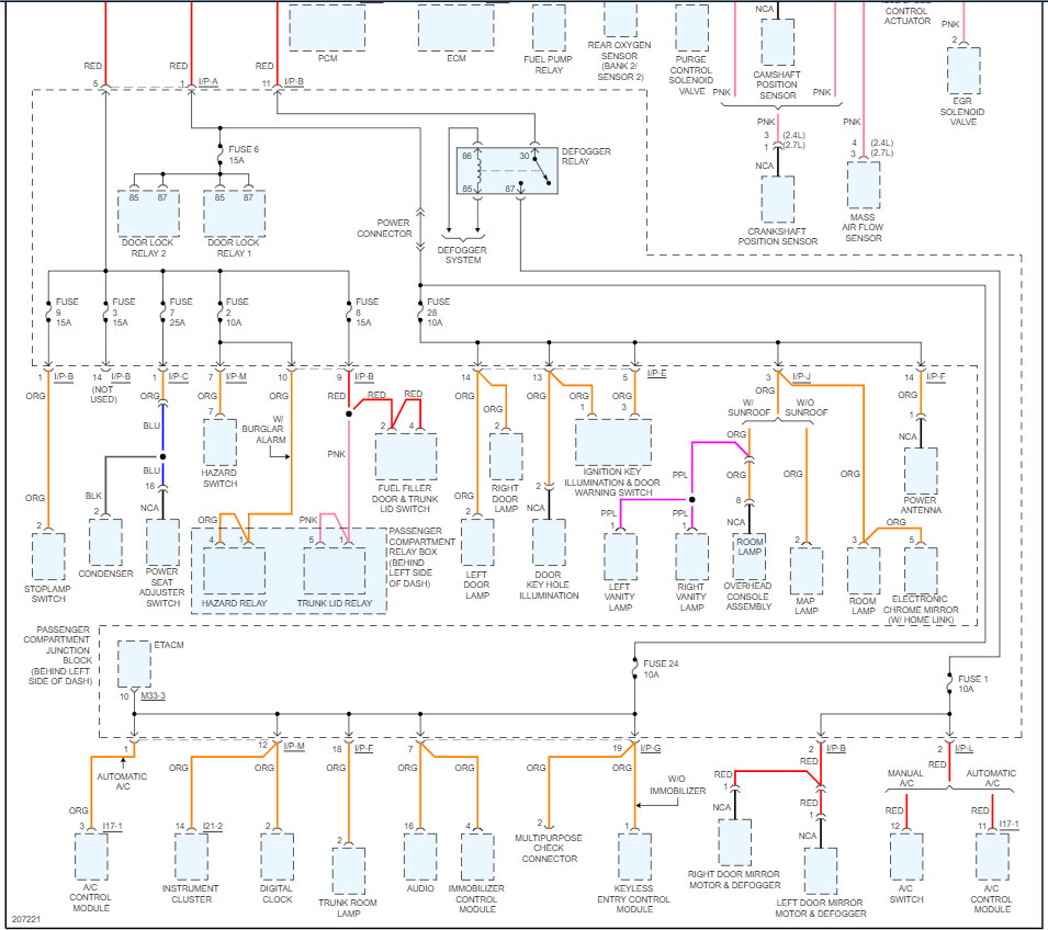

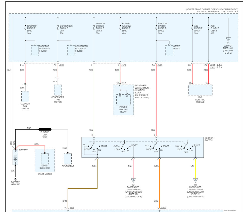

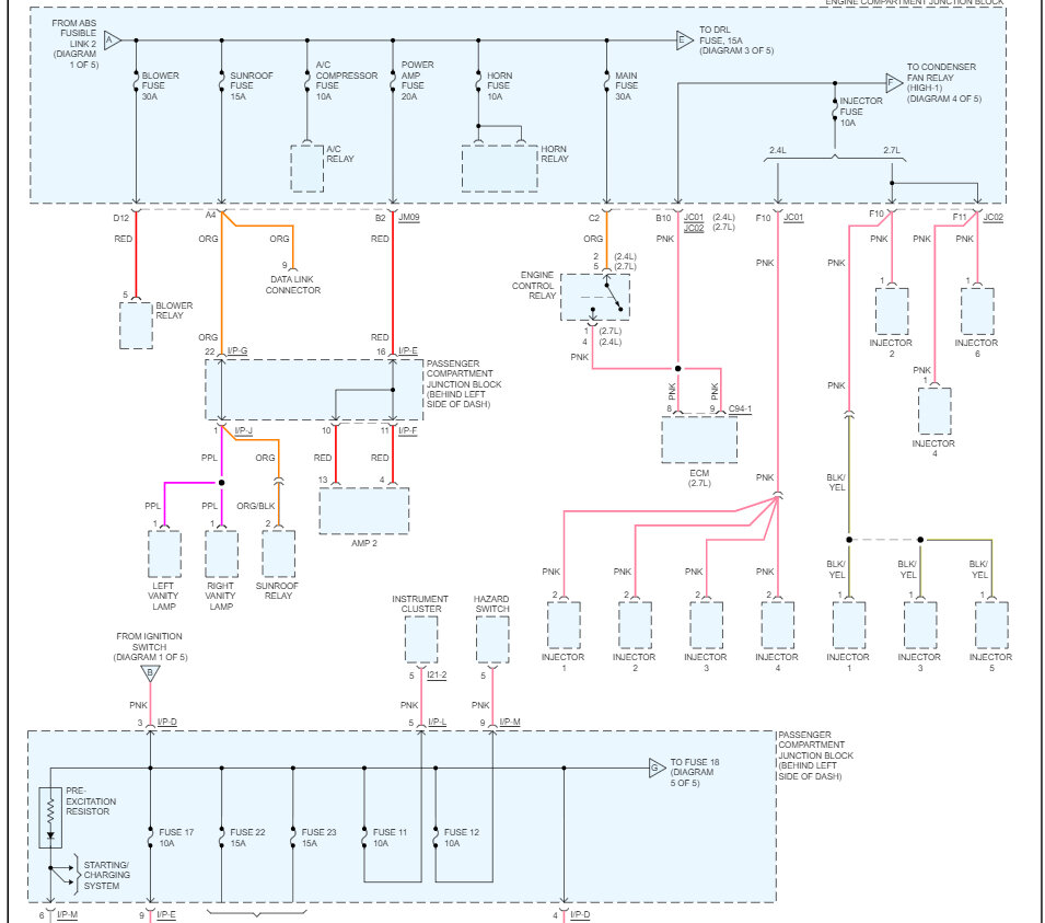

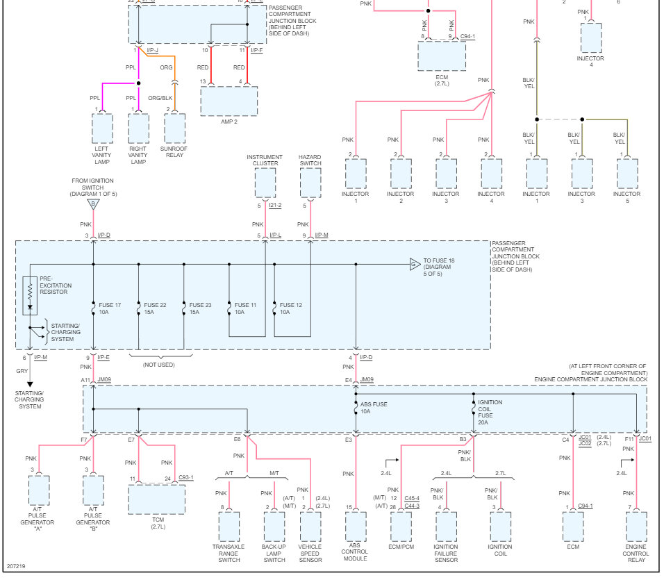

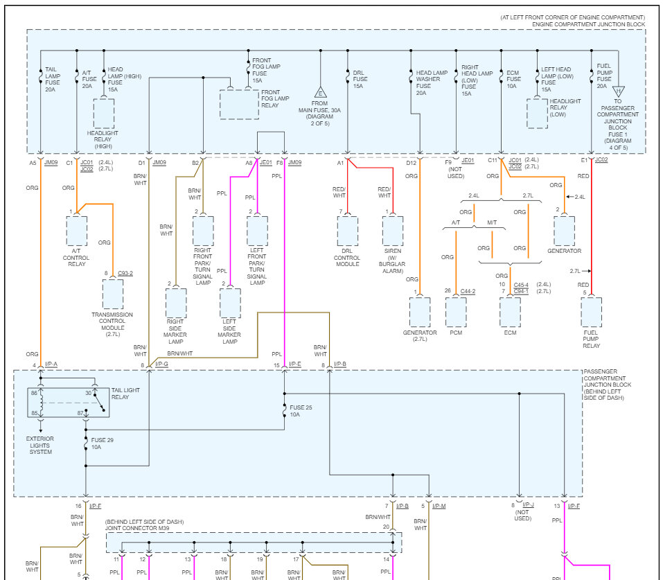

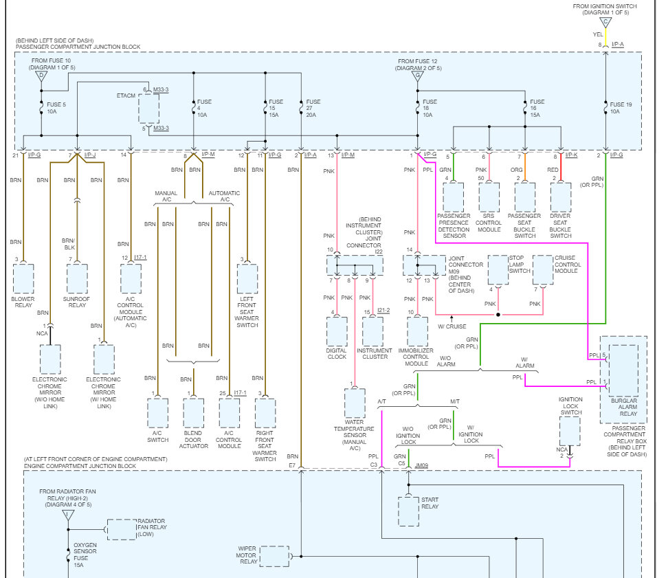

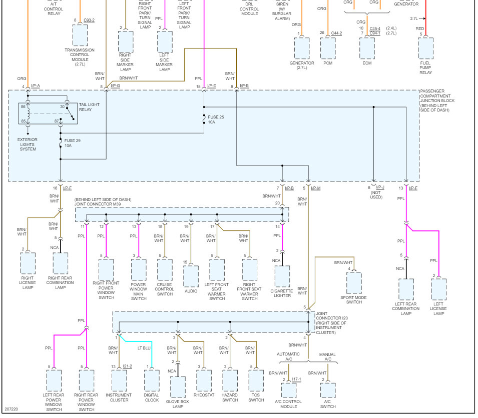

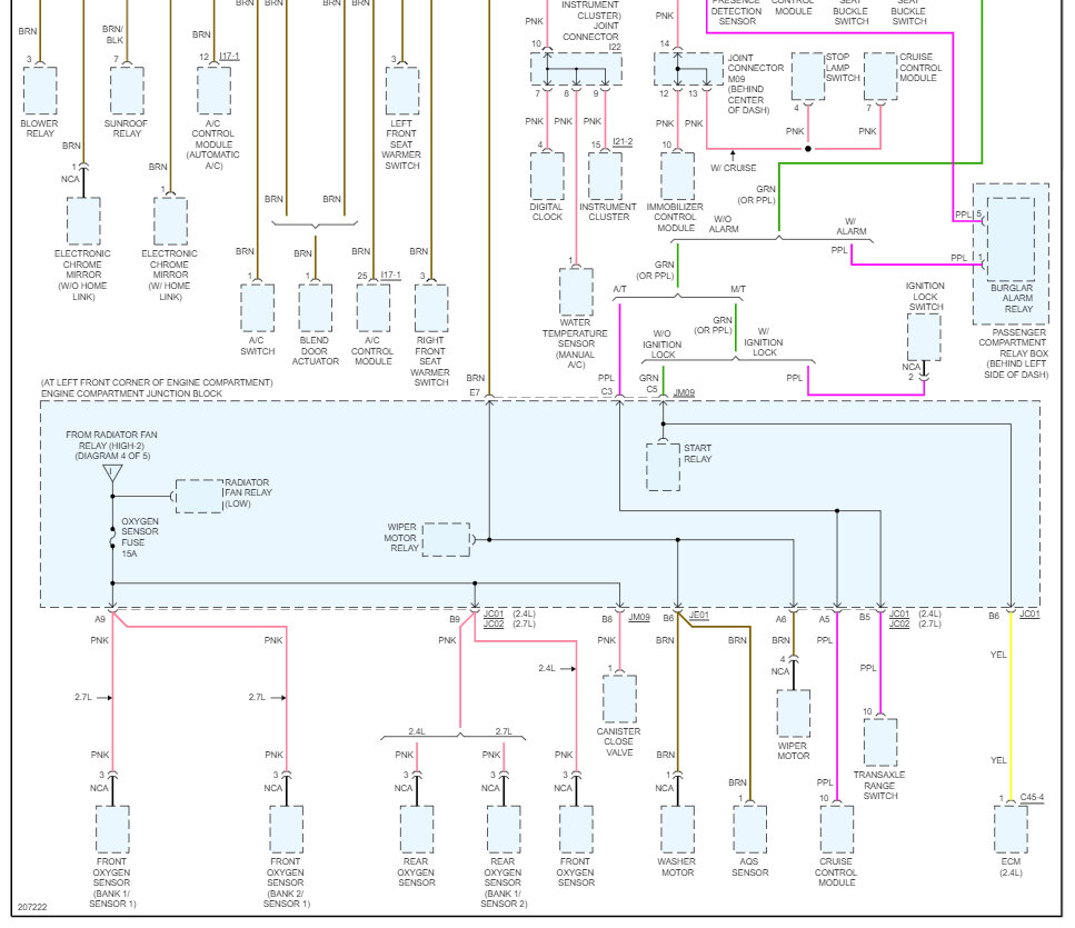

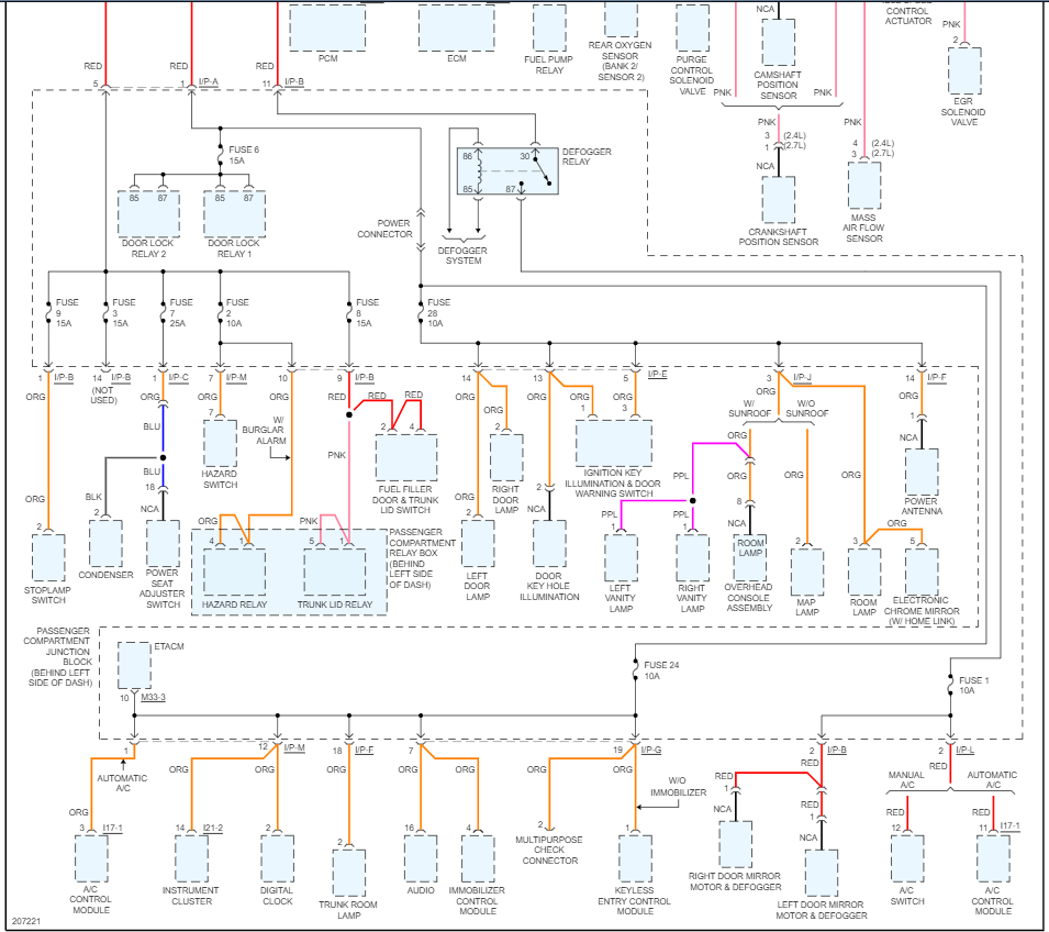

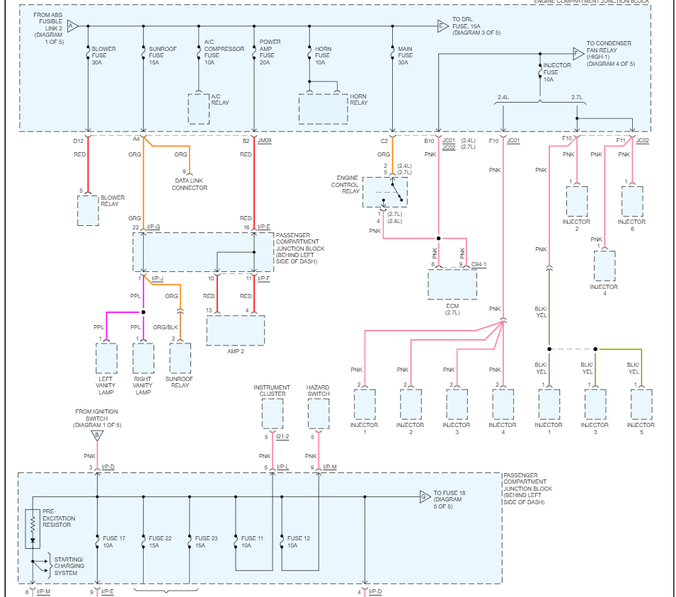

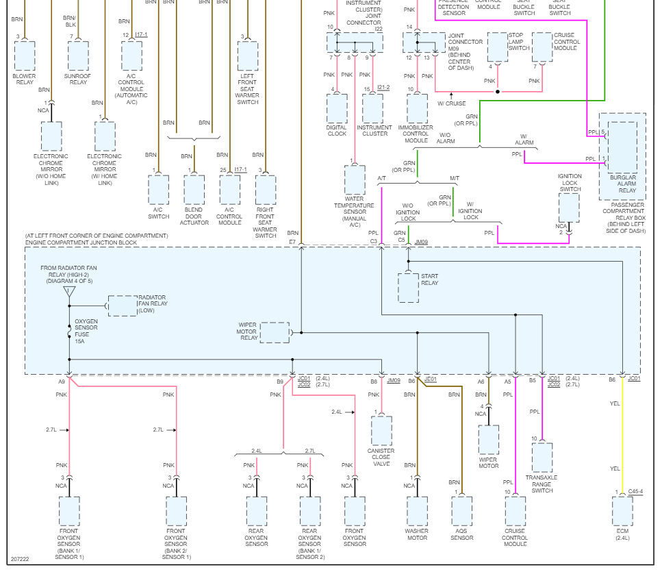

Okay, let's check the brown wire coming from the ignition switch when the key is on. You may have a burned-up ignition switch. Here are the power distribution wiring diagrams so you can see how the power is routed through the car. Check for power at each junction to see where it loses it. Check out the images (below). Let us know what happens and please upload pictures or videos of the problem so we can see what's going on.

I might be out of my league here. I've checked inside the hood fuse box and can't figure out where the wires go. The fuse box under the dash there's multiple brown wires. Is there some type of diagram/image that shows the location of this wire?

They don't have diagrams like that unfortunately, reversing the battery cables can cause weird damage. Does the engine start and run now?
