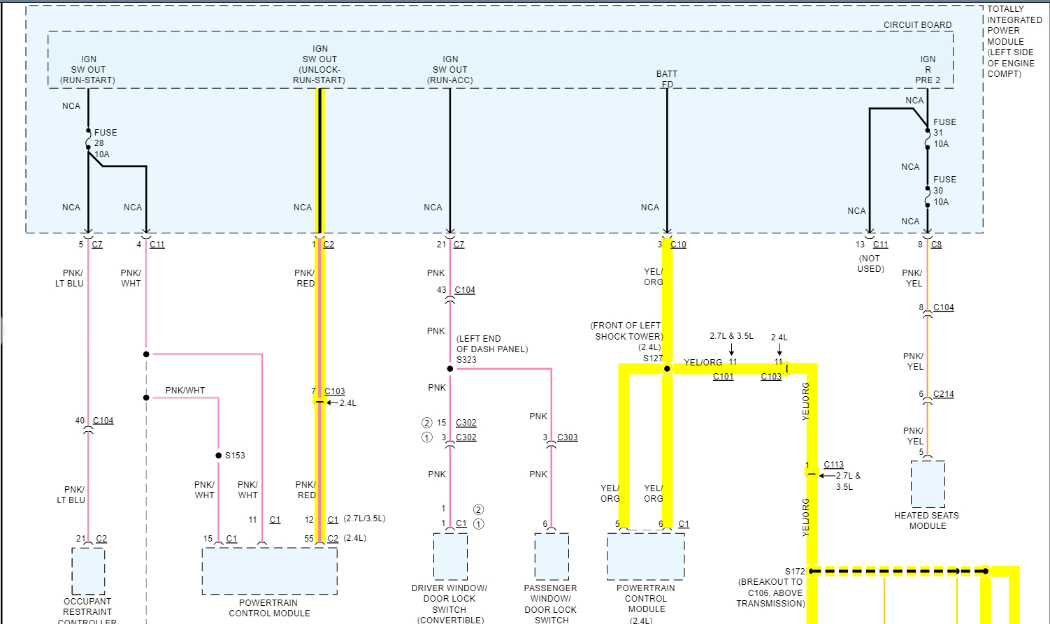

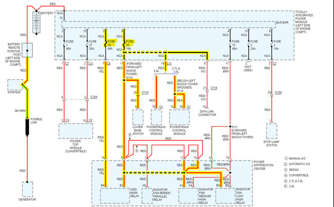

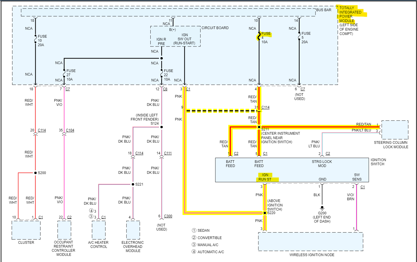

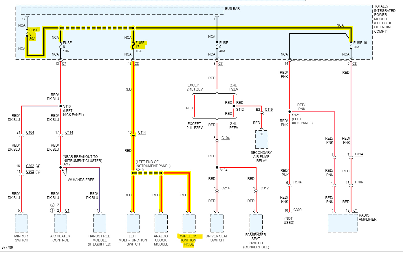

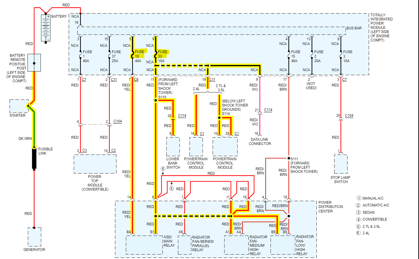

Okay, I have some diagrams here with some fuses to check, unfortunately there are no fuses on the ground side, so most of the time when this happens there is a module that is damaged. The Totally integrated power module (TIPM) is on the driver side engine compartment, it contains a lot of fuses and some relays, but it also has internal circuit boards. The main fuses that power up the engine computer are in the TIPM. Here are a few diagrams to start with, the fuses to check first are highlighted in yellow. I think there is one more page ill post that has a fuse and some other power feeds to the engine computer (ECM). If there are no burned fuses, then power to the ECM will need to be checked, I'm not sure if you have a basic multimeter or not, but hopefully the only module that took the majority of the current flow was the TIPM, and it might need to be replaced. Even with a used one.
Almost all the fused highlighted are for the ECM and the ignition node(module). So, check all these first and see what you find. Also take note of any connectors that look discolored or melted. I assume that charger was hooked up all night.

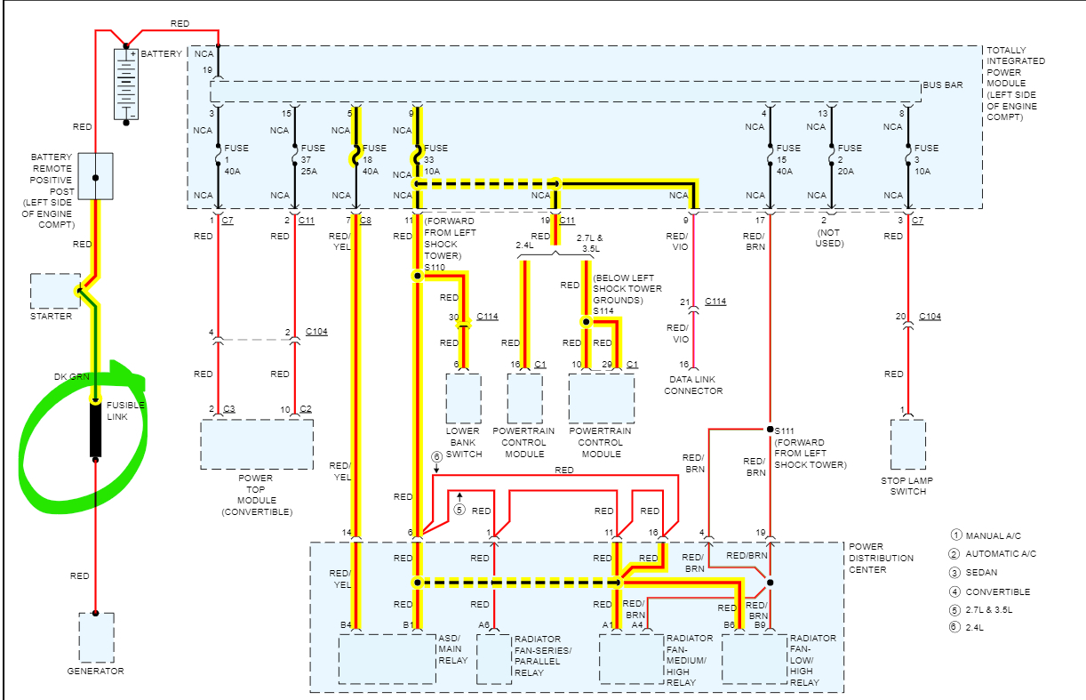

Did the battery push any acid out of the top into the battery tray? I would go buy a basic multimeter that can read 20vdc, so you can test the fuses before hooking up a new battery. Most likely that battery is no good. But you can check and replace any fuses that are blown first, and then see if the battery will take a charge afterwards.
This fusible link will need to be checked as well. I'm hoping there is a high amperage fuse somewhere that blew first, I'm just not seeing one yet in the diagrams. The fusible link coming from the Alternator is probably the highest rated fuse.

Okay, I'm sure you will find some blown fuses, and that fusible link may be down near the start motor. Sometimes they put them on the starter motor's main power stud. It will be a section of wire that is a different gauge than the rest of the wire, and most times they burn inside the shielding, so if there is no continuity from the Alternator to the battery positive, it's probably that fusible link, you can see it should change wire color before getting to the starter.
