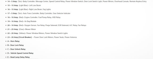

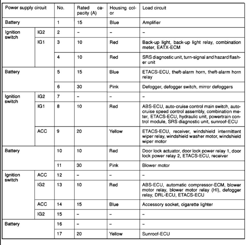

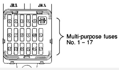

CARINFONAIF
Well, this is interesting, in a perverse sort of way. Went through the whole checklist (with the exception of checking the alternator again) and sequentially removed the fuses both from the box under the hood and the one inside the driver's side. I got a strong light on the test light for every one, except these two:
#5 - light went on, then quickly faded. This is a 10-amp red that runs the "power door lock and door lock arm/disarm switches; vanity, reading, map, rear seating, ignition and truck lights; illuminated entry; radio; power antenna (which I don't have); data link connector; body control module; and power amplifier." This sounds like the key to the problem.
#6 - Once I removed this fuse, the test light slowly "pulsed" brighter and dimmer, but never went out completely. This is a 20-amp yellow that runs the daytime running lights (Canada). I'm U.S. and I'm not even sure if I have daytime running lights. Don't know what year it became mandatory.
Now, I don't really know what a "data link connector," body control module," or "power amplifier" is. But here's a possibility or two--see what you think:
In late June I had a local stereo shop connect an iPod cable. They had to hard wire it because there's no auxiliary plug on the factory radio setup. I didn't have any problems for weeks thereafter (until early September), but maybe a wire has shaken loose? I haven't noticed any sound changes, however.
Also, because I have one cigarette lighter auxiliary port in the dash and one in the console, I put them to good use, keeping various items charged (GPS, iPod, etc.) on a frequent but not constant basis. Maybe there's something amiss with those systems. I stopped leaving things plugged in, however, and have still experienced the drain. So if it's that it would have to be the wiring I would think, and not the port itself.
If it were you, what would your next step be? Thanks for the tips. I'm learning more than I ever wanted to know about cars!

  • 110,244 POSTS
"I'm learning more than I ever wanted to know about cars!" LOL If you're like me and can't afford to pay others to do things, that is the way it goes. Hell, I built my own house from ground up. Had some help along the way to show me how to do things. It took 3 years, but I did it all. Even dug over 100 ton of stone out of the surface of the ground with a pick, shovel and a sledge hammar to stone case the house. Thankfully I live in the PA mountains where stone is everywhere. My 80 year old father taught me the trade. Picture a 5'2" Italian man still speaking broken English after being here almost 60 years yelling at me because I couldn't keep up with him laying stone. He was 5 scaffolding bucks high and seemed to forget, I was the one going up and down carring the stone and cement, mixing it... I don't even like to remember it. I thought I was going to die.
Regardless, learn as much as you can in life. You sound like a young man. My dad always told me to do that, and now I thank him for it.
Now, I'll shut up and get back to the problem at hand. Yes, I think you found the problem. Based on your description, I think I would have the stereo shop retrace their work or at least remove it to see if that changes things. It almost sounds as if power is backfeeding through the amp and stereo to ground. That will kill your battery over time.

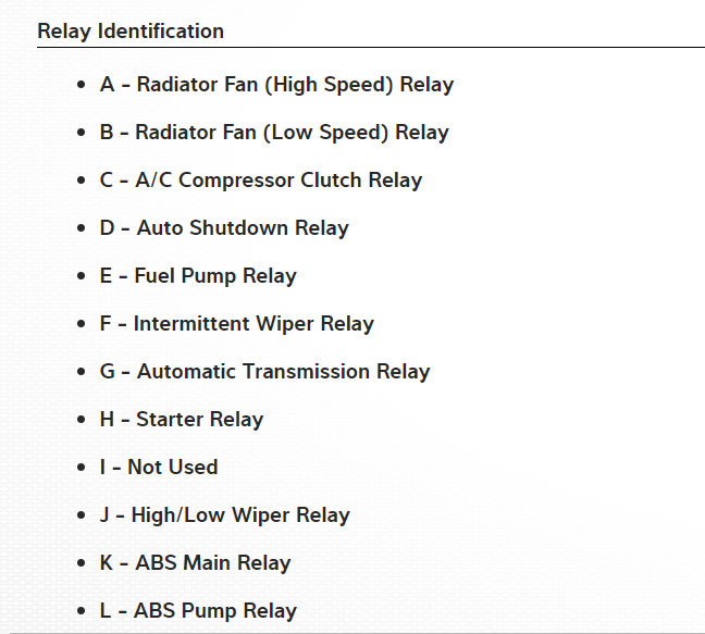

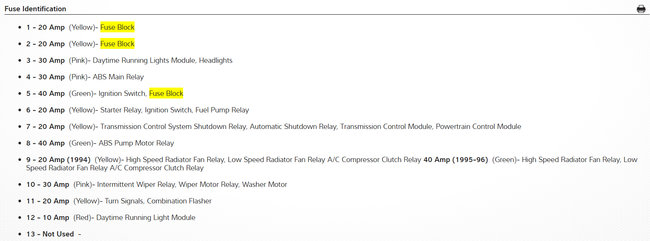

GW1200RIDER
It appears the ASD fuse (20 amp) is causing at least 120 mA of the draw. What does this fuse control? Should it be providing any current when parked?

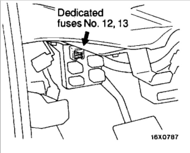

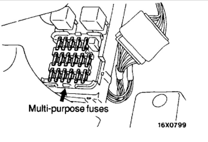

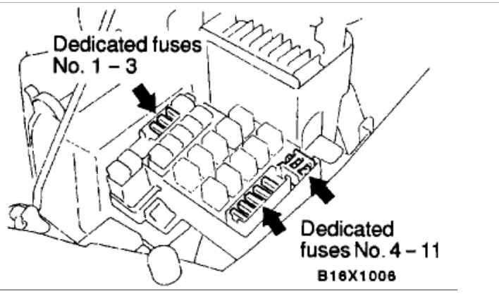

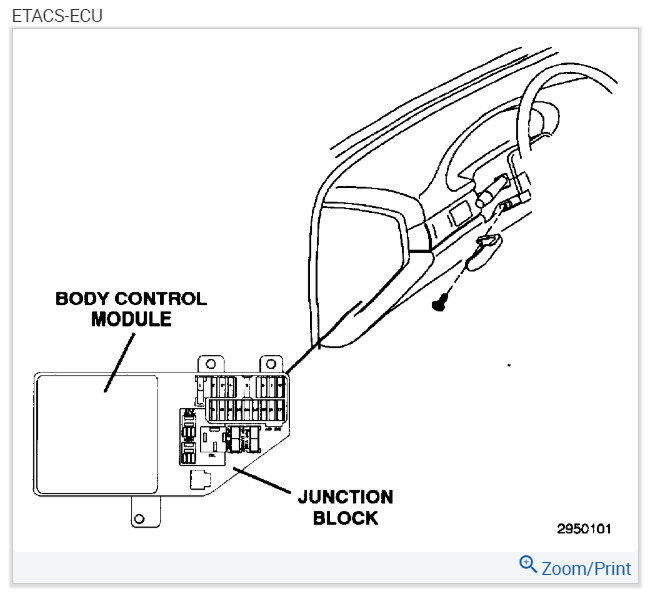

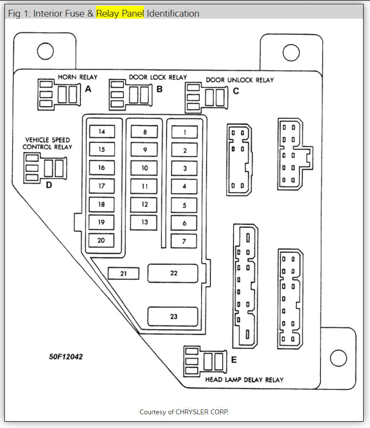

PAMELA MAHOWALD
There is battery drainage after the door is locked either by a fob or with a key. The fuse has been identified that controls the security system , etc. Of all the things affected by this fuse, the obvious thing is the arming of the security system by locking the driver door.
Is there a way to disarm the security system and leave in tack the door lock by key or fob?
Pam
Jul 29, 2020 at 12:29 PM (Merged)
  • 55,423 POSTS
It sounds like the BCM is having an issue which acts as the security system as well probably holding the locks down until the battery is dead.
I would try removing the electrical connectors from the BCM to see if the battery drains down. here is the location.
This guide can help as well.
https://www.2carpros.com/articles/car-battery-dead-overnight
I would remove it and look for water damage.
Check out the diagrams (below). Please let us know what you find.
PAMELA MAHOWALD
Ken, thank you very much for wanting to help with this problem.
By removing the BCM will I still be able to use my key to lock/unlock and my fob to do the same? Will its removal affect any other functions like horn, lights, etc. which seem to work with the door lock now? Do I need to replace or permanently remove it?
I like the diagram and know where the fuses are at the left end of the dashboard. Do not understand the position of the BCM in relation to the panel of fuses. And what does the plug that is shown pulled out from steering column do and is it necessary to remove it? Is it relevant here at all?
Thank you again for your help.
Pamela Mahowald

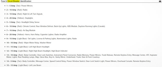

  • 55,423 POSTS
Hi Pamela
You can remove the BCM, this is just to test if the battery is not draining down. You cannot drive it or do anything accept let it sit to check the battery.
Here are the fuse panel diagrams you requested and a guide to help check them:
