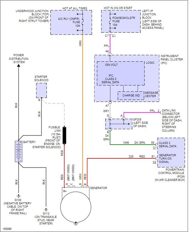

NAIRB123456
My battery light comes on and then car shuts off due to lack of power while driving. I have changed alternator three times had it tested both on and in system while running. Each time and it shows a bad voltage regulator while on car but when bench tested shows good. I have determined my problem may be a fusible link issue, but I am not sure where to look for this fusible link. Also, I have replaced the battery twice and had tested each time. It showed good, but they gave me a new one anyways.
Jan 20, 2021 at 11:35 AM (Merged)
PATENTED_REPAIR_PRO
  • 1,853 POSTS
There is a fusible link on the starter solenoid.
When the engine is running, the generator turn-on signal is sent to the generator from the PCM, turning on the regulator.
If while the engine is running at 2,000 rpm's, the charging voltage at the battery positive post is only twelve volts but at the back of the alternator B+ terminal it is 14 volts, then yes, I would say that fusible link may be bad.
If not, make sure that wire from the PCM is hot with engine running, the smaller gauge red wire to b of alternator and also check that D-orange wire is hot all the time with twelve volts.
