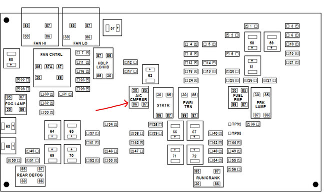

My car battery drains within hours to a day after it is jumped, or AutoZone fully charges my battery. I replaced battery 3 weeks new, alternator and starter 1 week new and alternator 175amp fuse 2 days new. Battery still drains after a few hours to a day later. What could it possibly be?
Sep 16, 2024 at 1:13 AM
  • 55,421 POSTS
Yep, I have seen the A/C compressor relay stuck closed and drain the battery on these trucks. Here is the location so you can remove it to see if the drain goes way, also here is a guide you can go over to help you see what other items can cause the battery drain:
https://www.2carpros.com/articles/car-battery-dead-overnight
The A/C relay is under the hood in the main fuse panel. Check out the images (below). Please let us know what happens.

So i charged my battery today to 75%. I just removed the ac compressor relay. I'll post an update tomorrow to see if the battery still drains. But it does explain why every time i disconnect and reconnect the battery, my ac is running even though i never turned it on before disconnecting the battery or jumping the car.

So, i waited two days to see if my battery would die and lo and behold i am once again charging my battery. The A/C compressor relay was blown but the battery is still draining.

It sounds like the battery is defective, is the alternator warm when the engine is cold? If so the alternator is causing the problem.
Sep 21, 2024 at 3:52 AM
MARCUSTSTAPES
  • 13 POSTS
Well, the alternator isnt warm, but i do remember now that the battery was very warm to the touch. It almost felt swollen to the point of exploding. I was almost scared to put it on the charger. But i put it under ventillation and did the reconditioning after charging it up. I feel like my BCM is bad too. Ill be replacing it soon too.
Sep 21, 2024 at 8:20 AM
  • 55,421 POSTS
The battery is bad, please be careful with it, they can explode, install a new battery.
