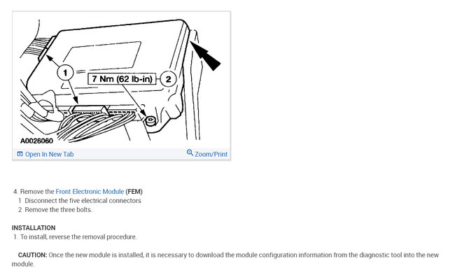

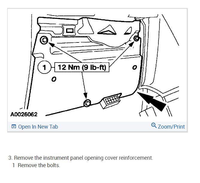

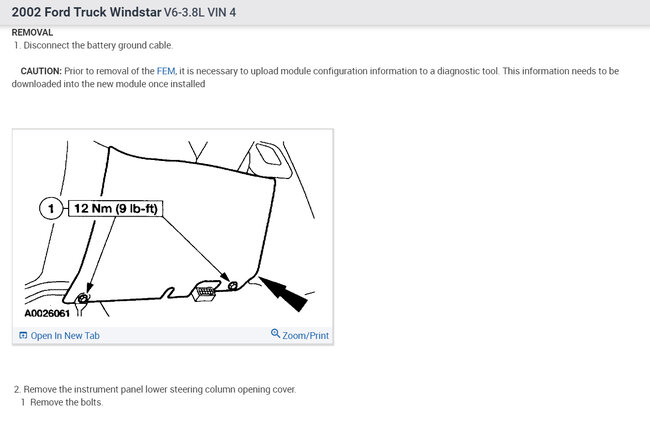

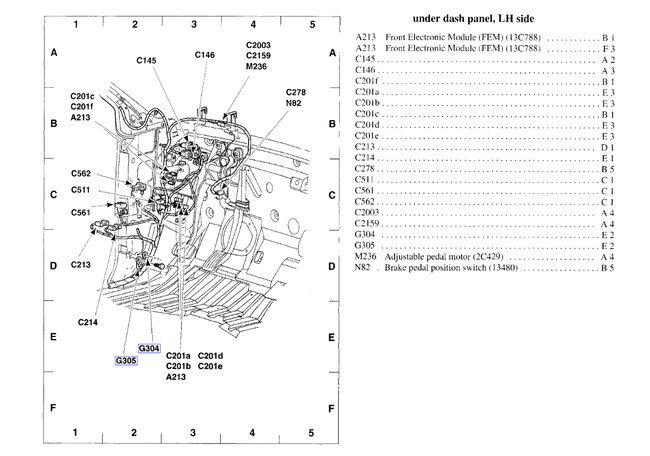

When I wash my van, it runs bad. It is a separate question so please start a new thread. It sounds like the FEM module has gone out which is common with these cars. Here is the location so you can change it out. Also, your battery sounds like it is bad, I would use this guide to see after the battery has charged:
Here is the location of the FEM so you can change it out to fix the problem. Check out the images (below). Please let us know if you need anything else to get the problem fixed.
