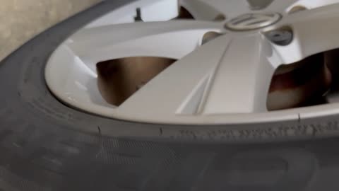

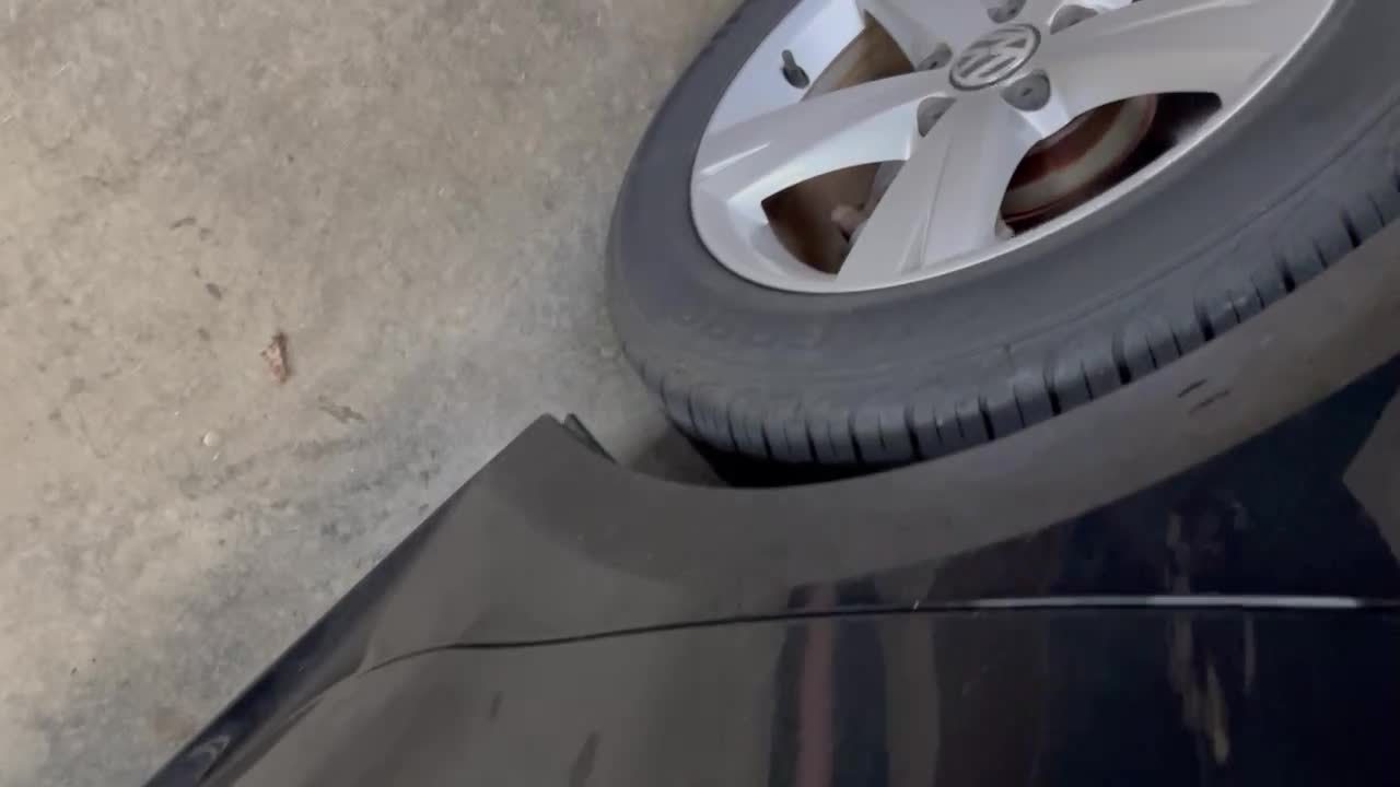

For the last couple of days i had to jump the battery and it works fine all day. Only overnight it drains. Just parked it in the garage and turned it off, notice something is still on and making a sound underneath the car, passenger side, by rear tire. What could be there that would stay on? Waited 15 minutes and didn't turn off. Went and turned ignition on and it stopped, turned ignition off and it's not there anymore.
