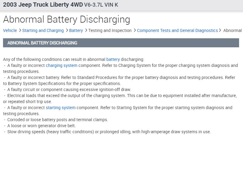

My battery keeps draining if it’s not used for more than a couple hours or more than a day. When I get out of the car, I turn off everything such as radio, ac, plugs. something is going on electrical and I’ve brought it to a couple mechanics, and nobody has given me an answer, it’s a brand-new battery and alternator. The starter, battery and alternator have all been tested and all came up perfect. I don’t know why the battery keeps draining.

Just to clarify, the battery loses charge if the vehicle is not driven for more than a day, right?
This sounds like the vehicle has an excessive amount of parasitic draw (current drain) on the battery. Every electrical circuit with a battery will have some amount of parasitic draw, but it can become excessive due to any number of faulty electrical components, which will lead to a fast discharge of the battery. For example, this can be due to a glove box light staying on or a shorted switch.
Typical acceptable parasitic draw is around 30 milliamps.
To find out what is causing the drain you will have to use a multimeter and check for the drain on the battery, while removing certain fuses to check if it changes the draw amount.
