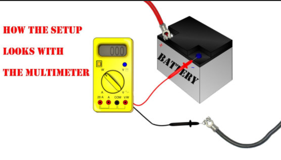

Any ideas on common issues with battery drain on 2004 Jeep Liberty? Things to check and how? After 2 day weekend not using vehicle, it is sluggish to crank on Monday, some clicking. Then cranks okay at lunch, but after going out to lunch, then trying to return to work, battery completely dead and have to be jumped off. Then cranked okay at end of day. The next day (afternoon), some clicking and almost didn't crank. Battery is less than 11 months old.

To check for this, we need to do what is called a parasitic drain test. You do this by disconnecting the negative battery cable and connect the red meter lead of your voltage meter to the battery post and the other to the negative cable.
Take a look at the diagram below for how to set this up.
Then set your meter to amps and it should read less than .035 amps (35 milliamps) with all the doors closed and the hood light/latch disconnected. If it is higher than we need to remove fuses until it drops and that will tell us what system is remaining on when the vehicle is off.
Please run through this and let us know what you find.
