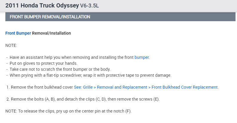

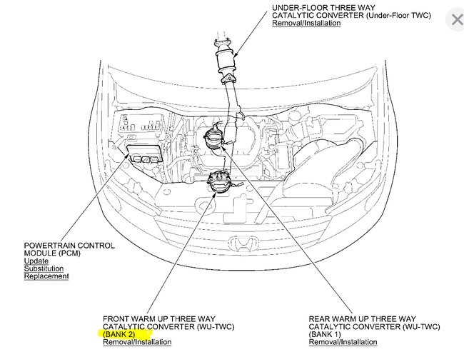

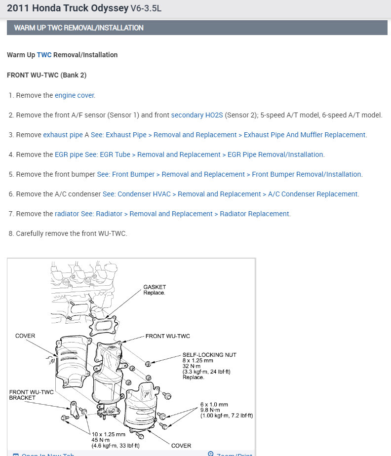

According to maintenance records, bank 1 catalytic converter was replaced at 188,888 miles but bank 2 was not (dealer only had bank 1 in stock). Dealer cleared codes and it's been fine until yesterday. Now I'm getting a check engine light and code reader is showing its bank 2 below efficiency.
How difficult would it be to replace the bank 2 catalytic converter myself? I tried watching a video and it mentions having to remove the front bumper?
Feb 24, 2022 at 9:58 PM
SQM
  • 6,383 POSTS

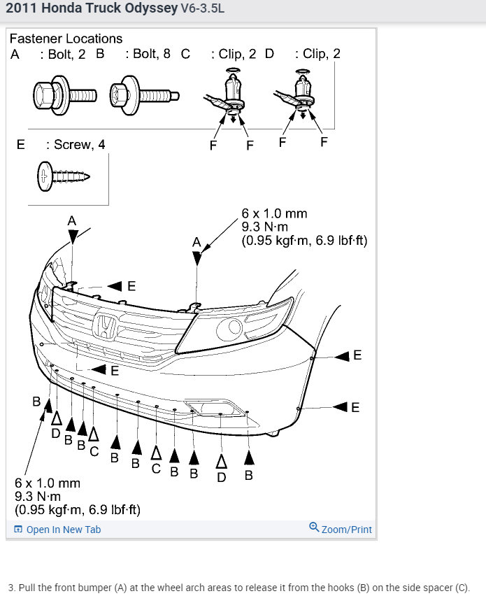

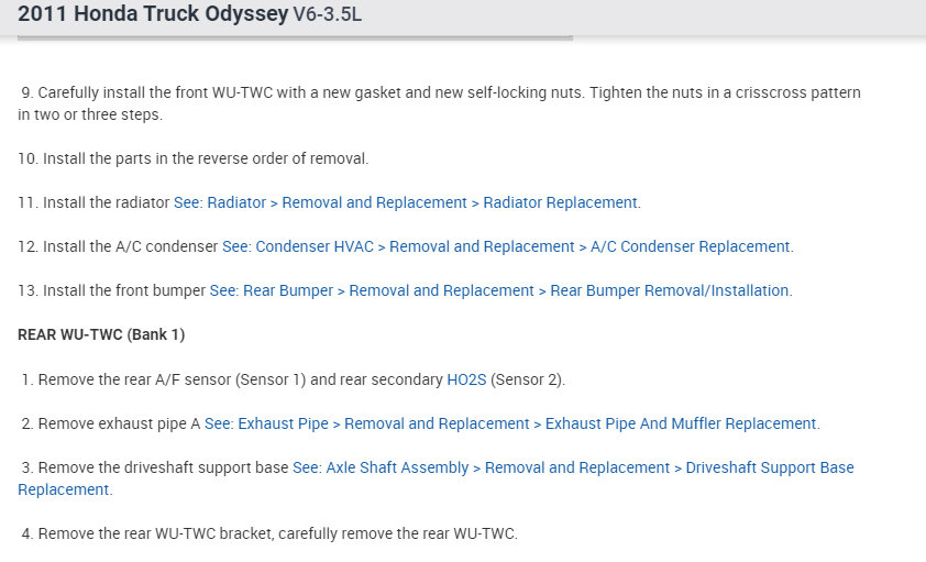

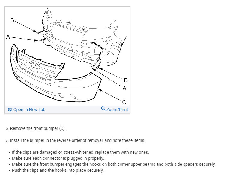

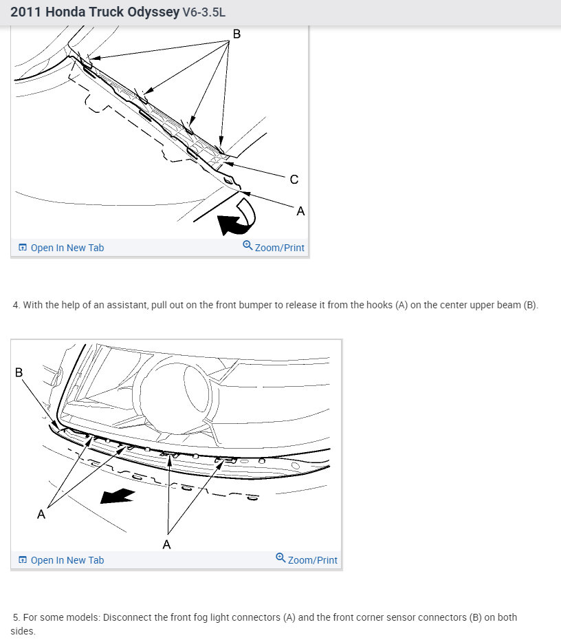

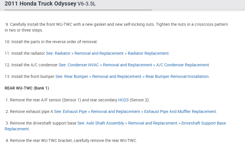

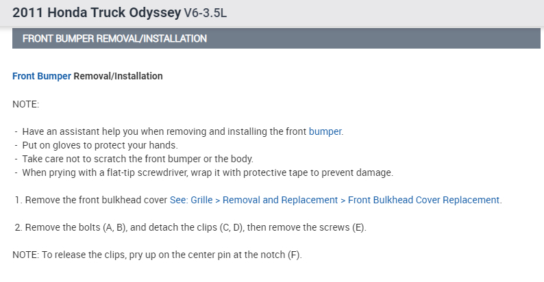

In order to replace the bank 2 catalytic converter, you will have to remove the front bumper as well as the A/C condenser and the radiator. Which will require you to drain the radiator and evacuate the A/C system.
Keep in mind that many times the efficiency codes are due to a faulty oxygen sensor and not the catalytic converter.
Here is a guide on how to test the catalytic converter:
Do you know exactly what code you have got for this?
I have attached replacement steps for the bank 2 catalytic converter as well as the bumper removal procedure below for your reference.
