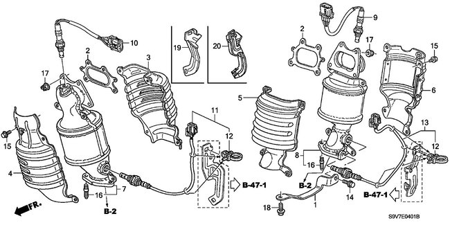

I was able to get help from someone with a live data scanner and I've determined that my oxygen sensors are functioning properly so I definitely need to replace my catalytic converter. The error codes refer to bank 1. Since the Odyssey has 2 catalytic converters does bank 1 refer to the front cat or the rear cat? How do I determine which one to replace or is it best to replace both? I'm planning to purchase the part genuine Honda part from hondapartsnow.com. The 2 part number on their site are: 18190-RGL-A00 (front) & 18290-RGL-A00 (rear).
The dealer ship gave me a slightly different part number of 18290-PRL-A00 when they originally diagnosed the problem. They also gave me a few part numbers for gaskets: 18115-RCA-A01, 18212-SA7-003.
I've got a subscription to AllDataDIY.com and their part numbers are completely different. The more I research, the more confusing it gets. Here's a link to the part list on hondapartsnow.com.
https://www.hondapartsnow.com/Page_Product/PartDetail.aspx?Vin=5FNRL386X5B074530&Filter=()&SubCategoryUrl=converter&Diagram=&PartNumbers=&PNC=7
Please let me know how I determine which part I need and any related parts that I should also get. Since gaskets and bolts are inexpensive let me know if it is best to also replace those.

Don't let the part numbers throw you. Automakers change the part number if there is a minor update or change for a part, even if it's functionally the same part. So say they took the front converter from your car, decided to use the same engine and converter in a different model. BUT to use it in the new car they needed to weld a tab on to hold a bracket. The new part number will now fit both cars BUT the original part number will only fit yours because it lacks that tab. Another reason they change the number will be if they change part suppliers. They can then track part failures by using the part number. Happens all the time.
Now as to the parts you need.
YES on any gaskets and bolts that are corroded or broken on removal, The gaskets will probably be junk when you remove them but even if they look good they have been compressed and won't seal on the new part.
Which bank - Well for most engines Bank One will be the cylinder head that has cylinder number one in it. In the case of your Honda, that will be the rear cylinder head closest to the firewall. Bank Two would then be the one closest to the radiator.
So if you are seeing the problem on Bank One you need the part to the right in the picture. OR Honda part - 18290RGLA00
You will need at least part numbers 2 and 8. Plus part 18212-SA7-003 which is the gasket between the converter and the pipe.
Now IF all the nuts (17) come off good, and the bolts (15) come apart and those covers (5&6) are good, And you can get bolt 14 out and can get the oxygen sensors out without damage, you should be all set.
