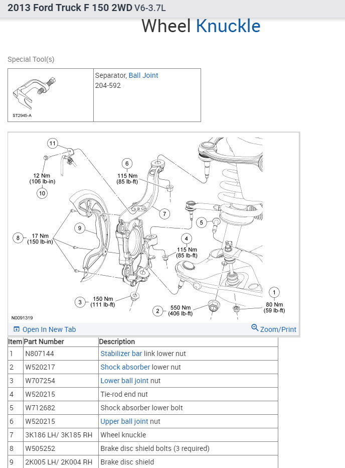

Having difficulty removing wheel knuckle from lower ball joint.
Jan 14, 2022 at 11:34 AM
SQM
  • 6,383 POSTS

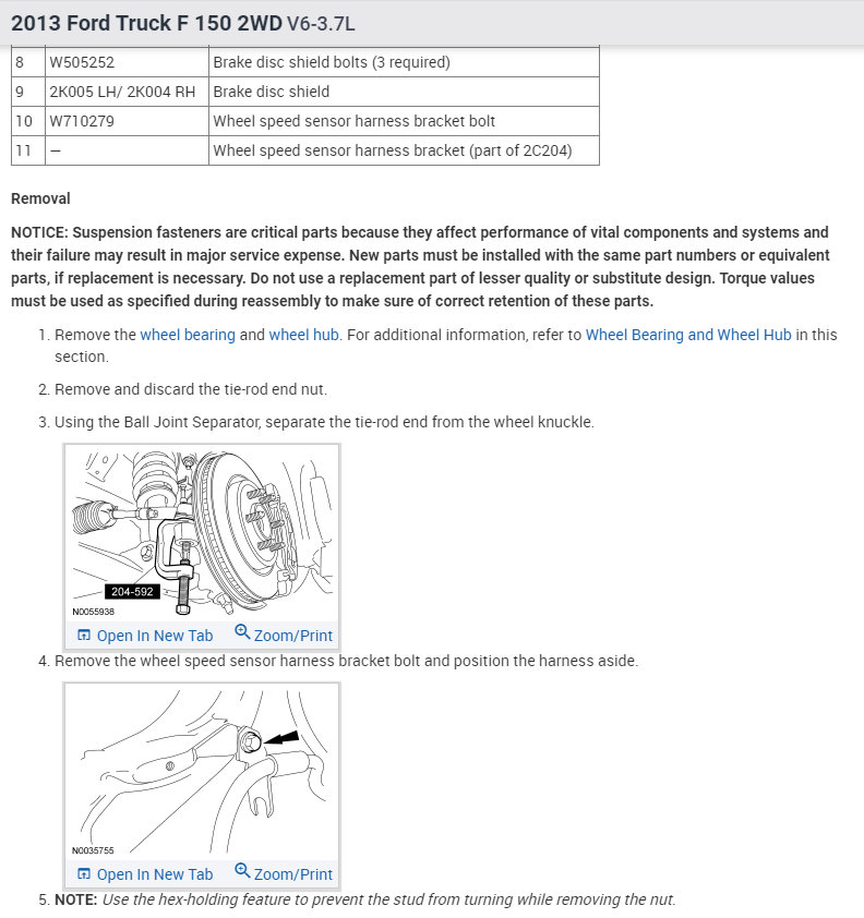

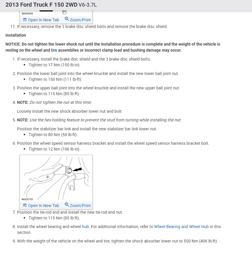

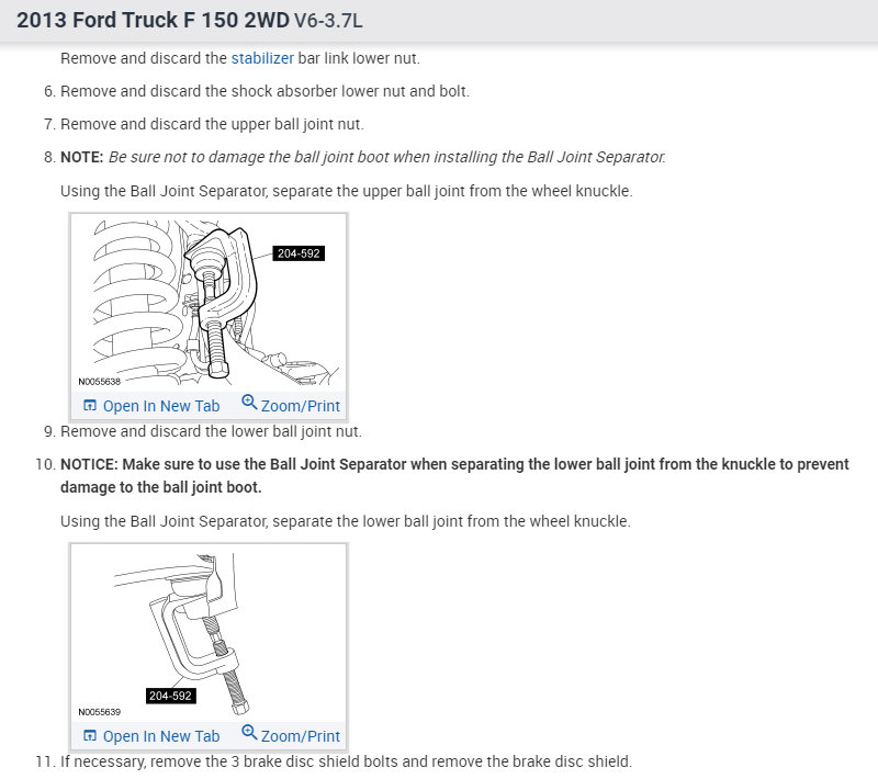

You will need a ball joint separator to get this job completed.
Keep in mind that many times the suspension components can be seized and will require extra effort to remove.
Can you tell me what you have tried so far and what exactly is the issue?
Here is a helpful guide:
https://www.2carpros.com/articles/how-to-release-a-ball-joint
I have attached the replacement procedure below for your reference.
