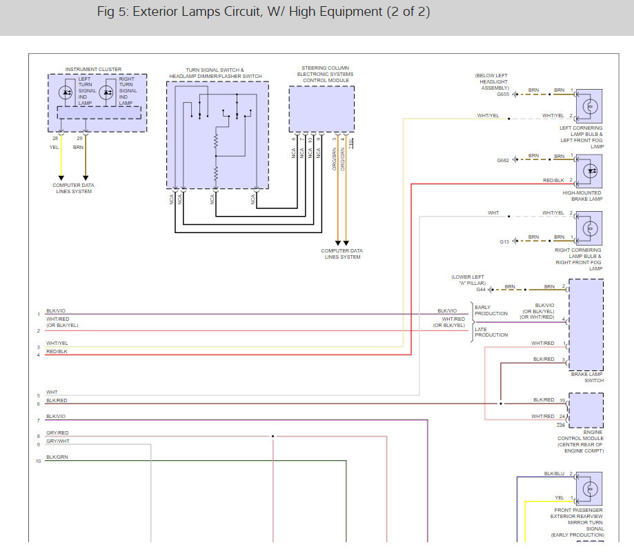

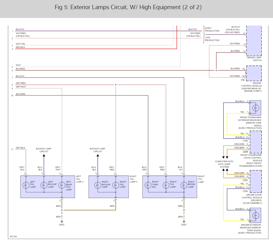

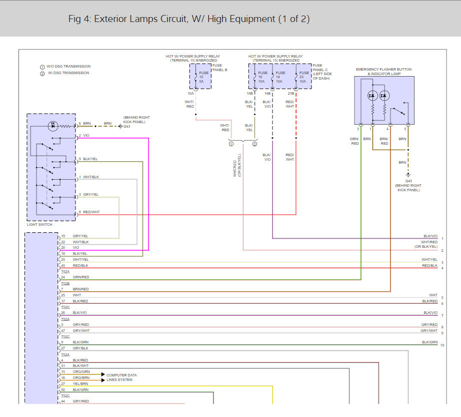

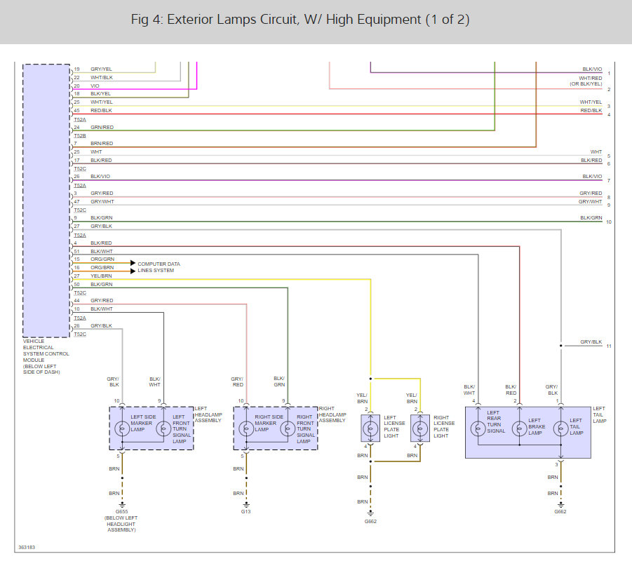

Both my rear running and cab lights are out. My rear brake, back-up and turn signals work fine. I have tried trouble shooting by checking all rear bulbs and fuses but still no rear running lights nor cab lights. Does anyone have a solution to this problem? :-(
Aug 19, 2018 at 9:54 AM
  • 55,746 POSTS
It sounds like you have a lighting module located on the under side of the dash on the right side that is going out but to be sure lets remove the electrical connector and check it for corrosion. Here is the wiring diagrams for the lights so you can see how they work.
