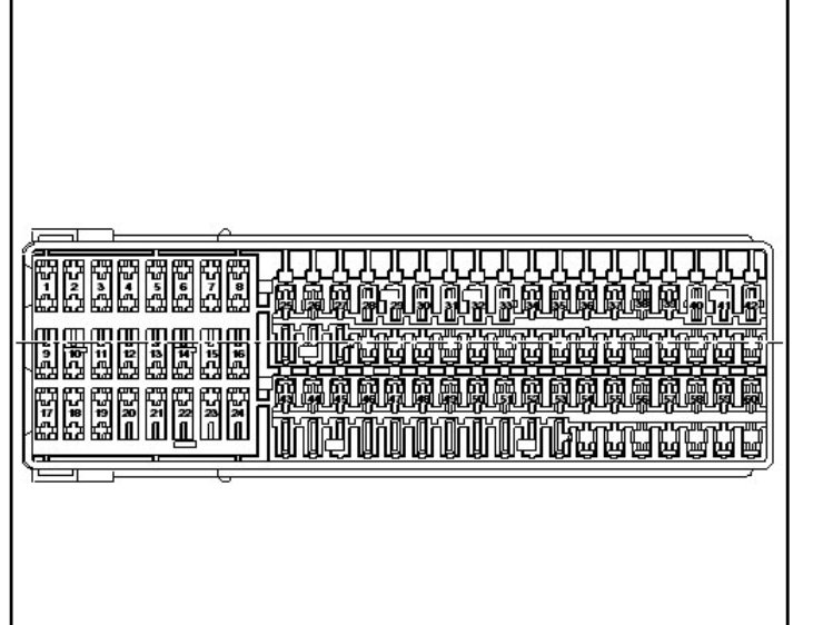

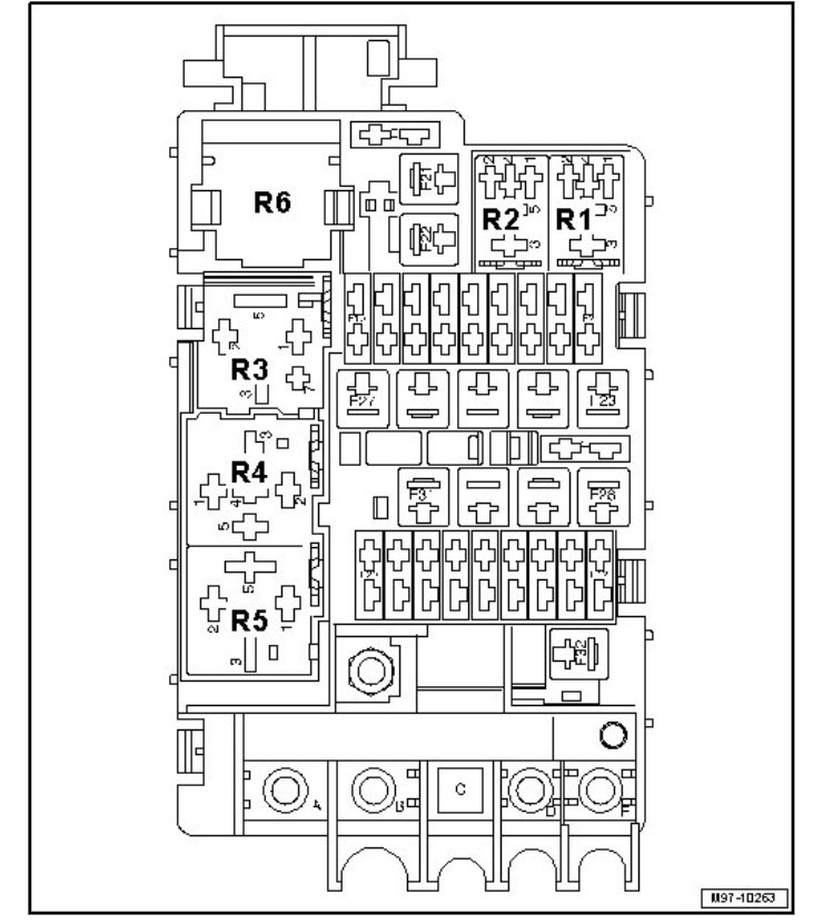

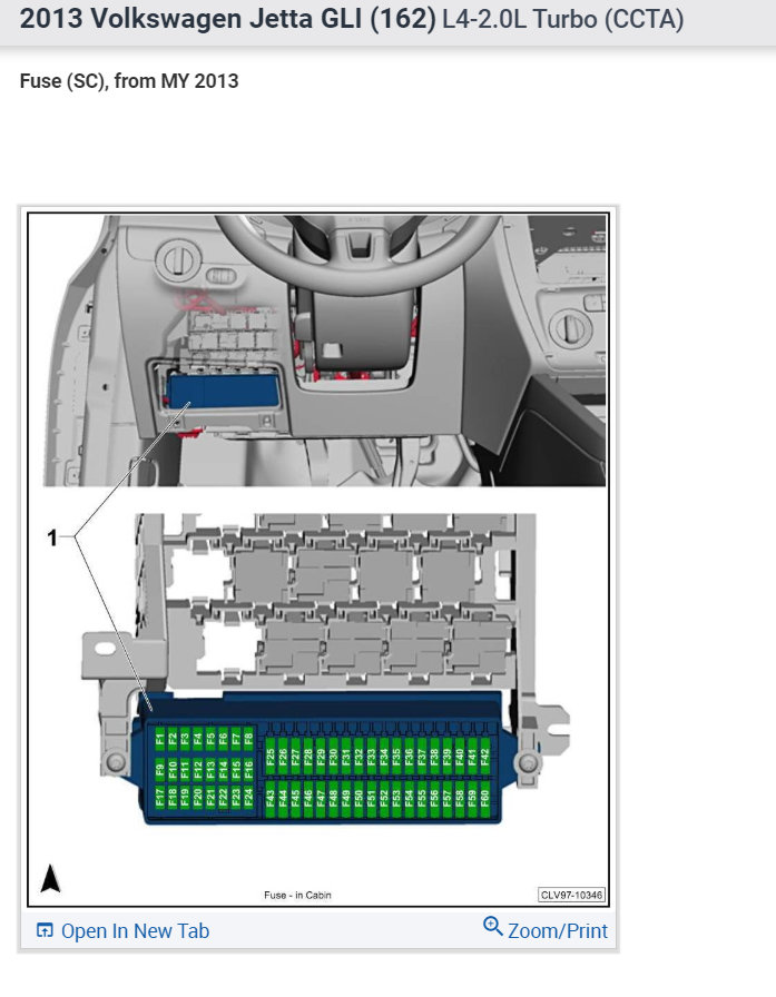

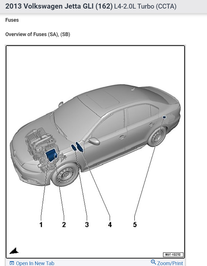

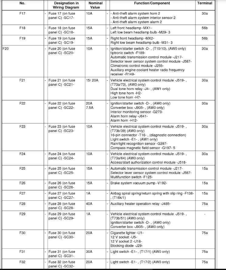

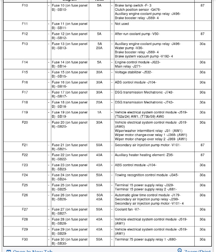

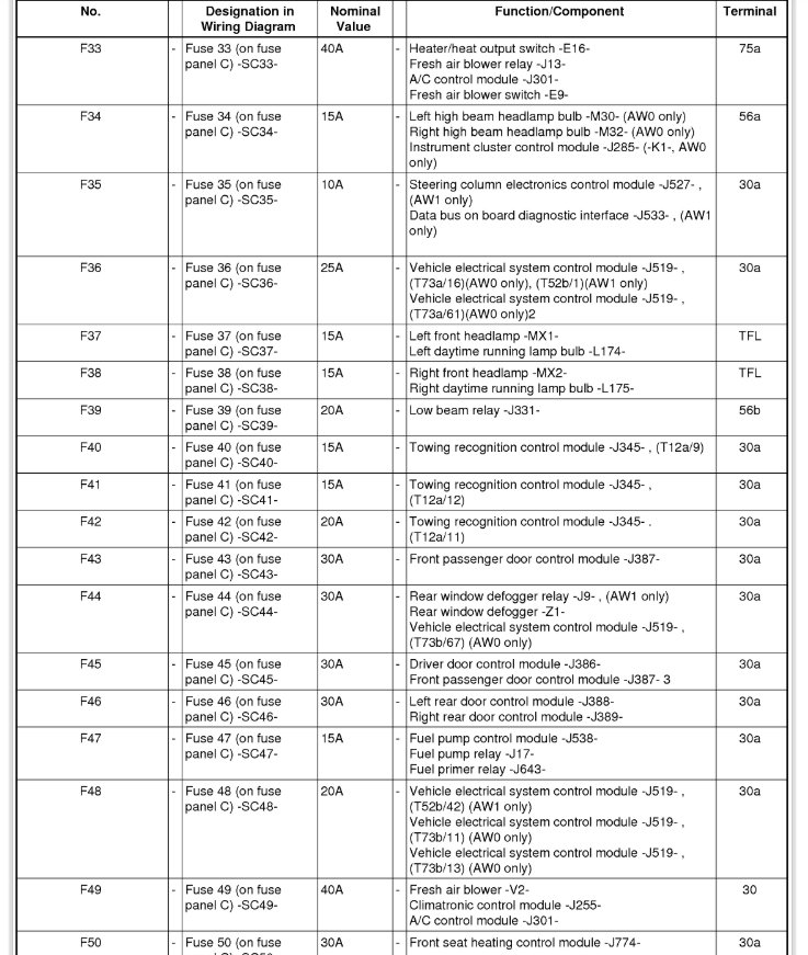

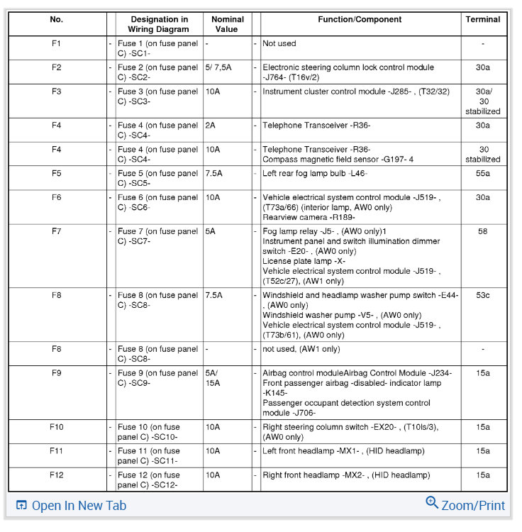

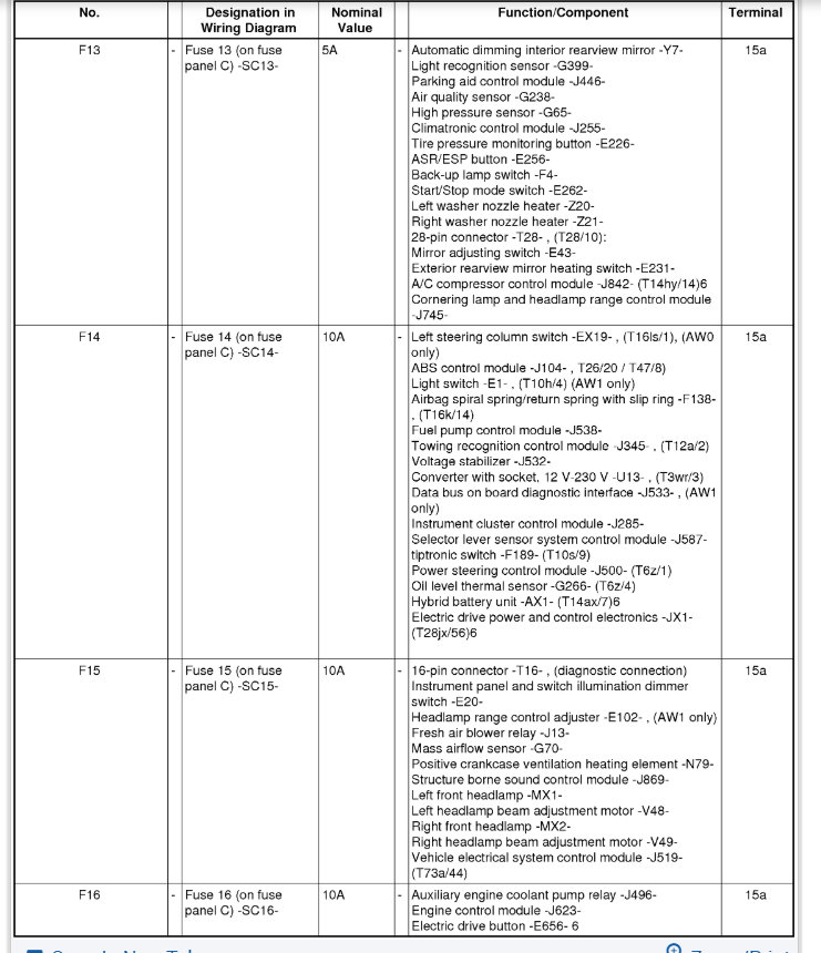

where can I tell which fuse is for what.In the fuse box? There is nothing saying what fuse is for the radio, or the tail lights or the instrument cluster.
May 27, 2016 at 8:14 PM
MHPAUTOS
  • 31,937 POSTS

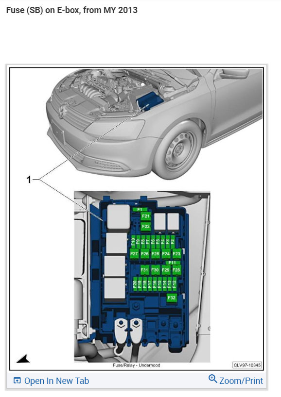

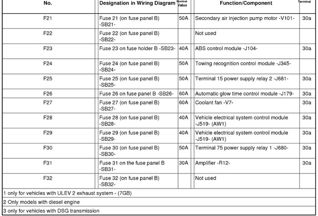

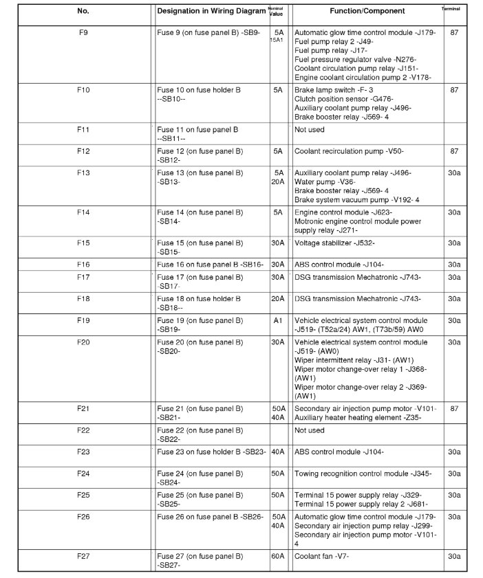

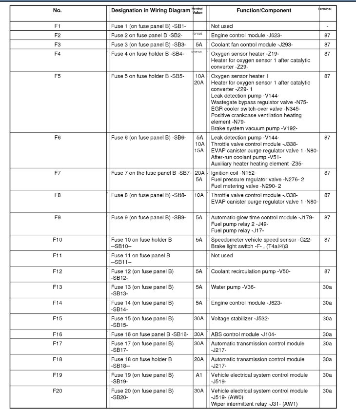

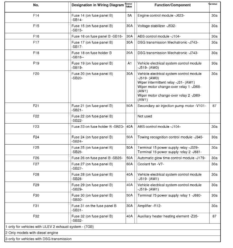

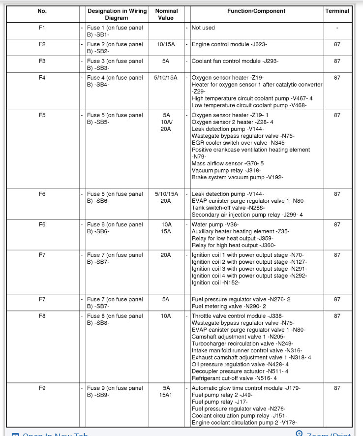

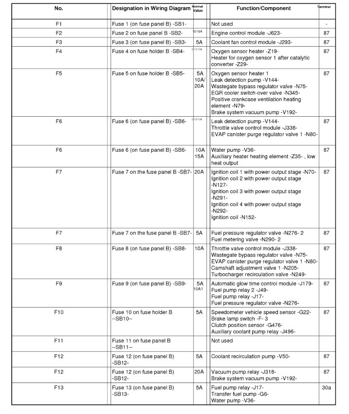

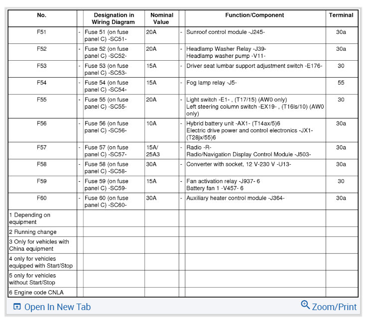

We need to check fuse #23, 10, 14 and 16 in the fuse panel inside the car and under the hood here is a guid to help you with the fuse locations and the wiring diagrams so you can see how the system works below.
Check out the diagrams (Below). Please let us know what you find. We are interested to see what it is.

Having a problem with the tail lights in the rear driverside.
#23 5a fues keeps blowing.

Is fues #23 a 5a?
Also need diagrams? Got to get this fixed soon. Thanks

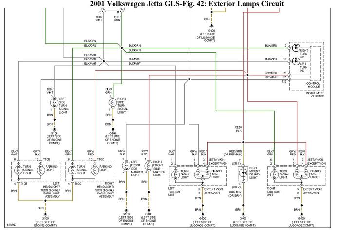

EXOVCDS
  • 1,883 POSTS
Are you sure the problem is in the back?
Did you check the front left side marker in the bumper?
How's the amber bulb in the front headlight assembly?
Thomas
Apr 13, 2020 at 11:13 AM (Merged)

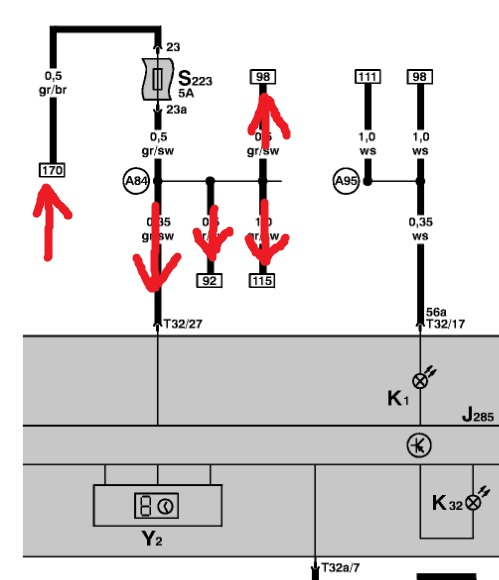

EXOVCDS
  • 1,883 POSTS
- #92 goes to front left side marker
- #115 goes to left tail light
- #98 goes to left park light (front)
Thomas
EXOVCDS
  • 1,883 POSTS
Forgot image... sorry.
Still getting used to new website layout...
Thomas
J.STIEG
  • 361 POSTS
Thomas,
can you post that diagram again, only without the red arrows. Thanks
J.STIEG
  • 361 POSTS
Never mind, I think they are all GR/SW. thanks

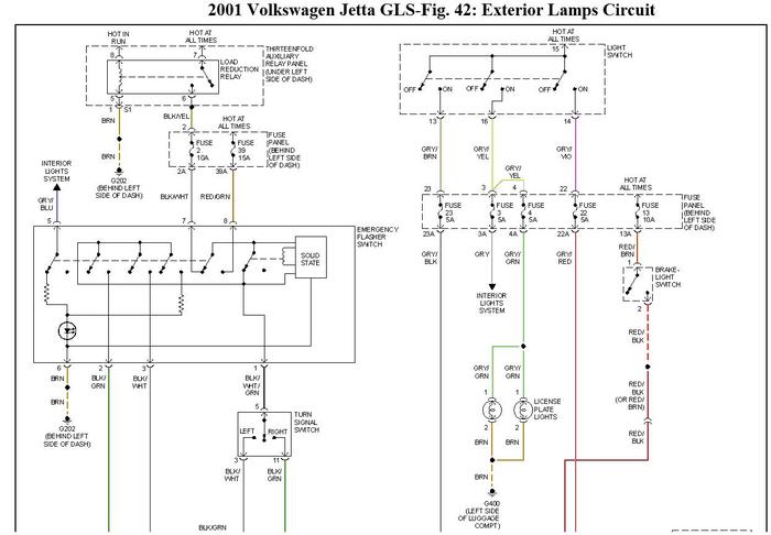

J.STIEG
  • 361 POSTS
The #23 fues ONLY blows when the HEADLIGHT SWITCH is on, but with all lights unplugged in every corner.
I have the test light bulb looped in series on #23, and all lights UNPLUGGED. I now turn the headlight switch on, but TEST LIGHT comes on.
Right now I am trying to get the test light off,,,,, with headlight switch on,,,,,, and of course every light unplugged.
Trying to find a place to unplugg at firewall to see if problem is in the front or back, Any ideas?
J.STIEG
  • 361 POSTS
There are 10 wires going to the headlight switch. I need to know what they are, and test them for shorts.
If I unplug headlight switch connector the test light on fues #23 goes out.

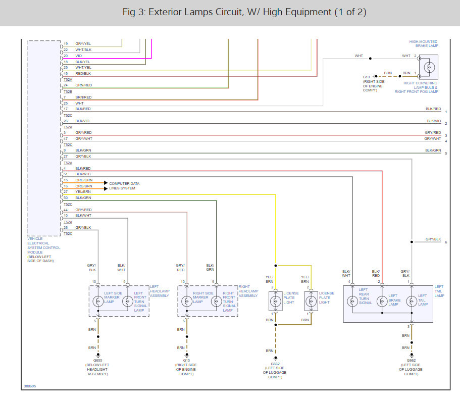

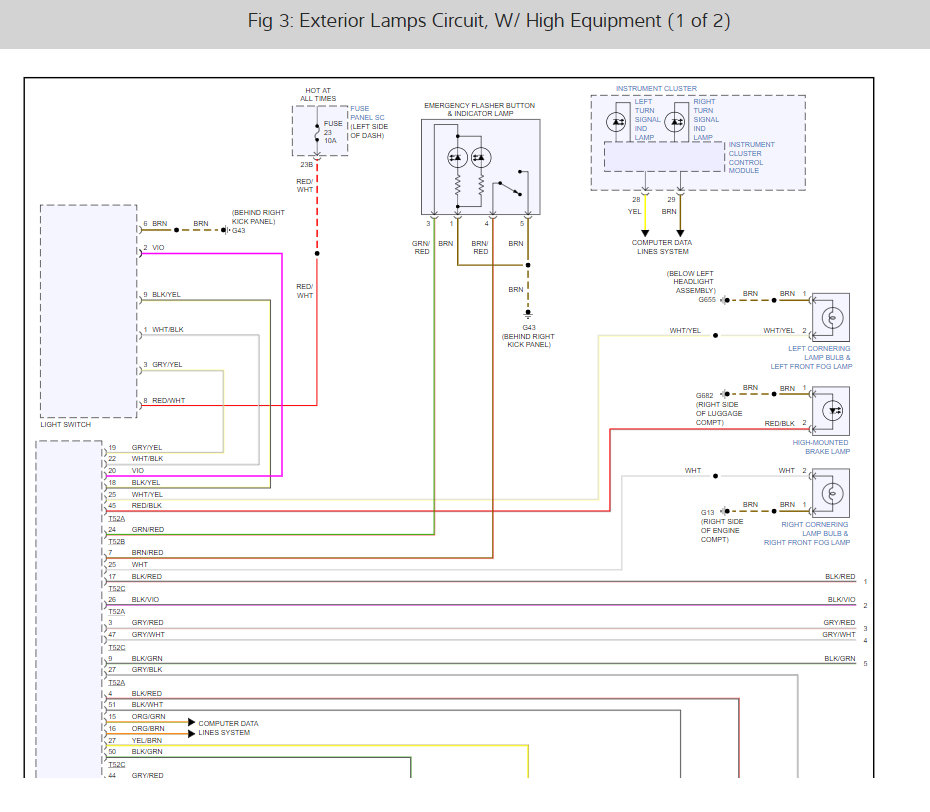

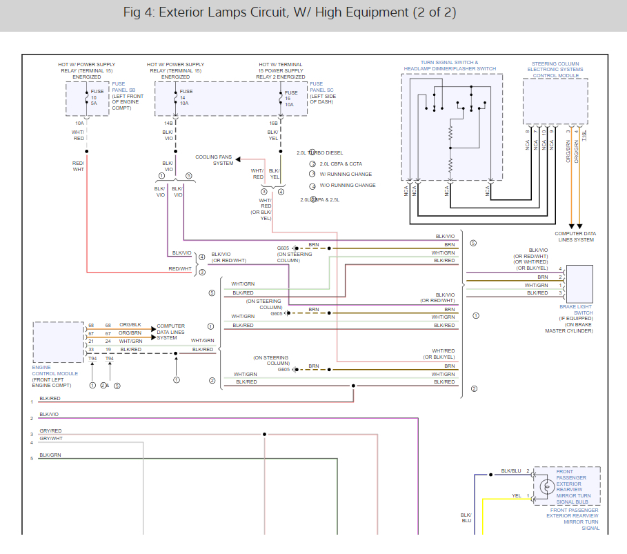

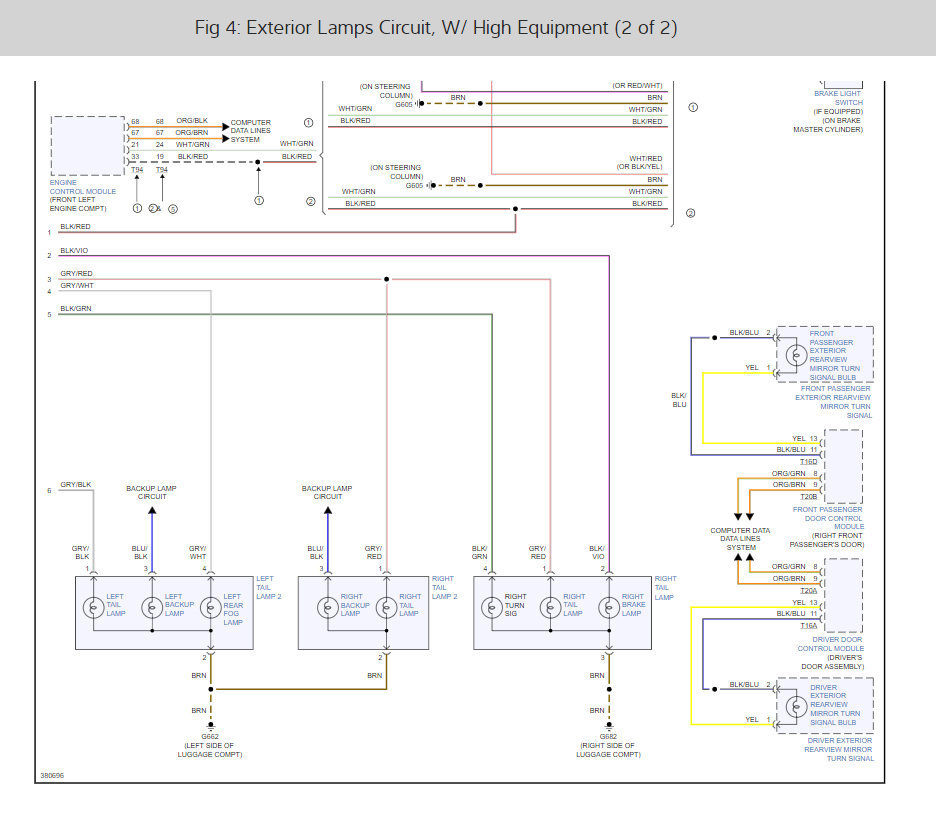

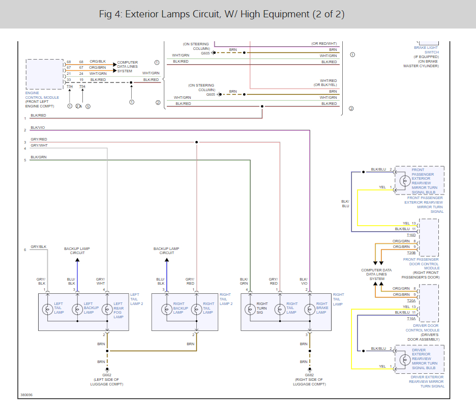

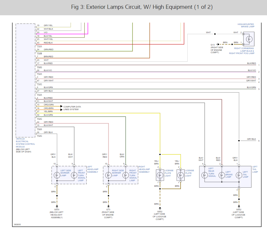

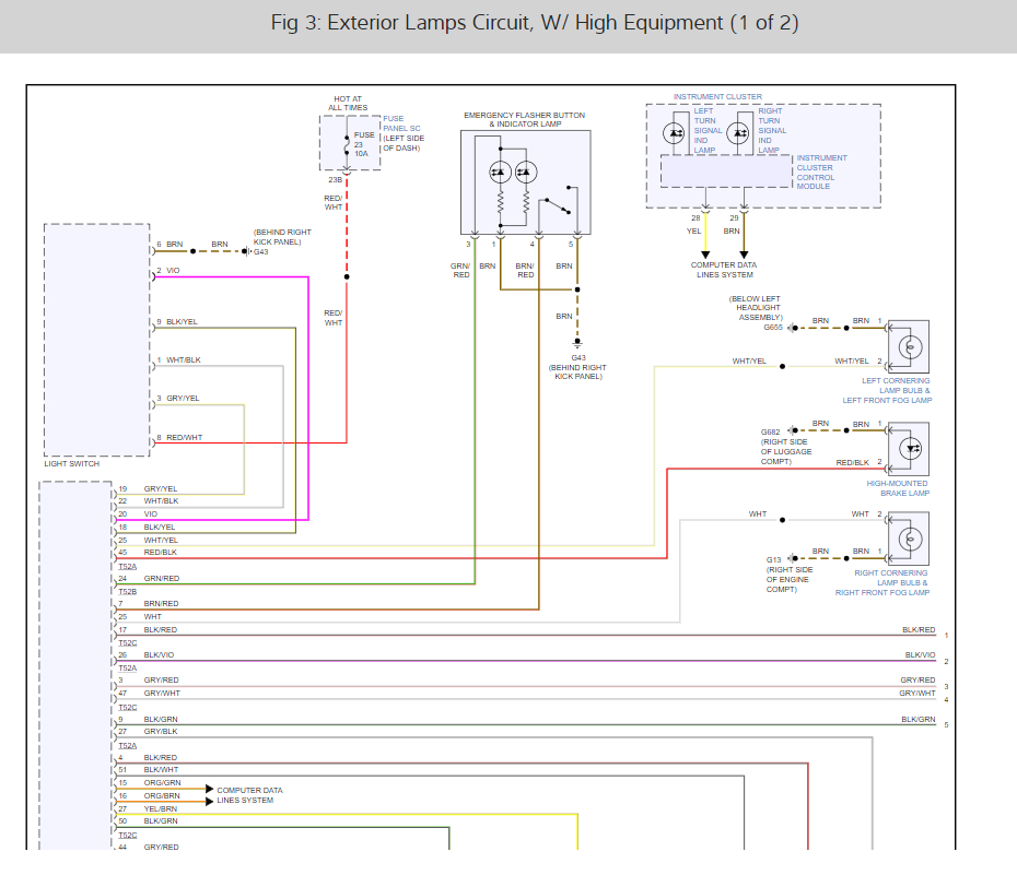

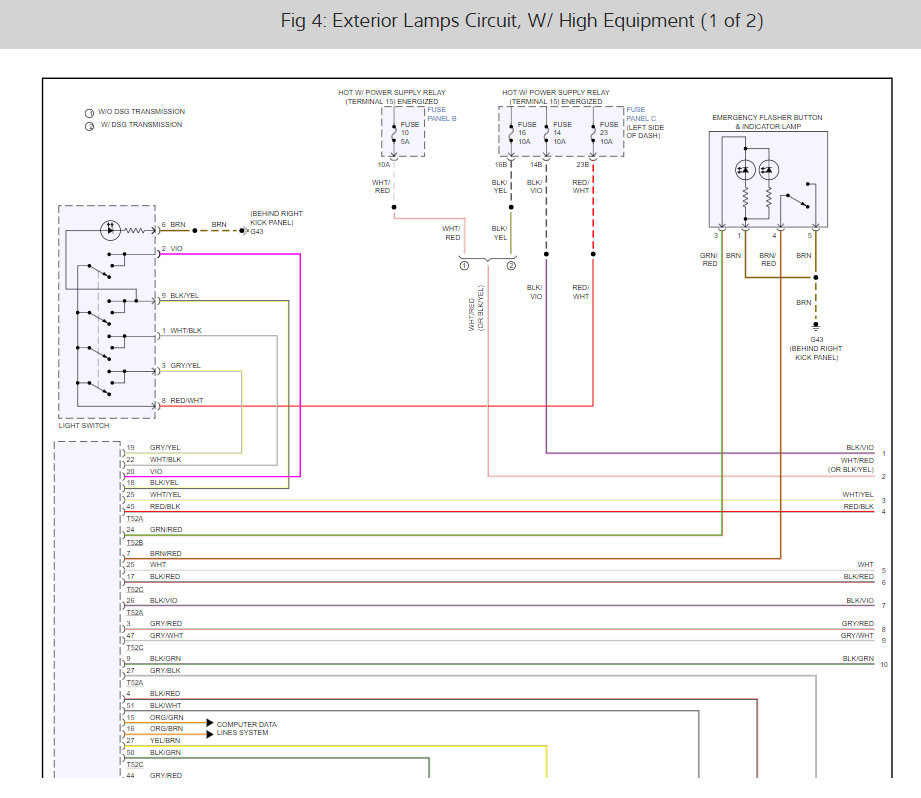

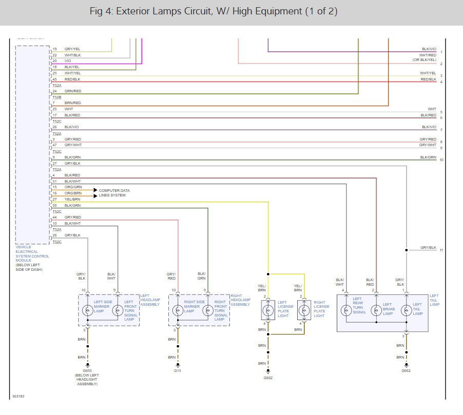

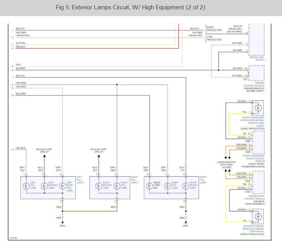

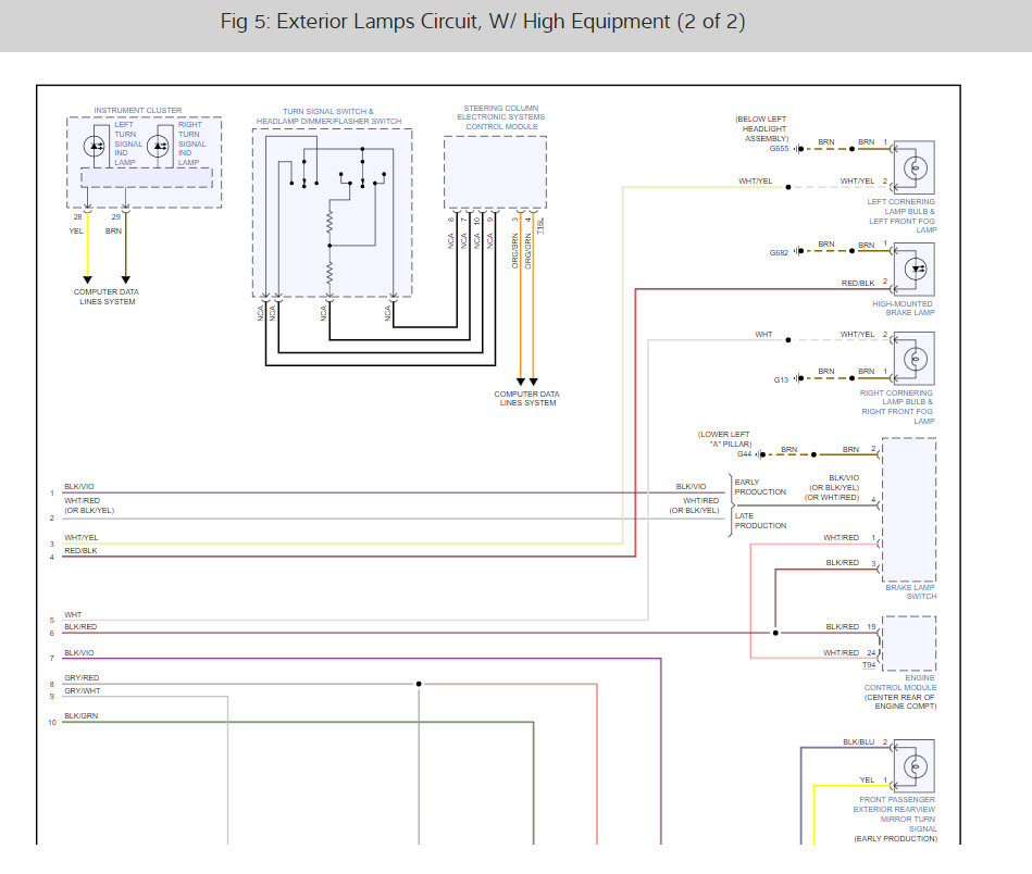

KHLOW2008
  • 41,814 POSTS
See if this diagram is of any help.
J.STIEG
  • 361 POSTS
thanks KHLow2008 for the diagrams! I found the problem using the diagrams.
It was a left front small amber running light shorted out.
