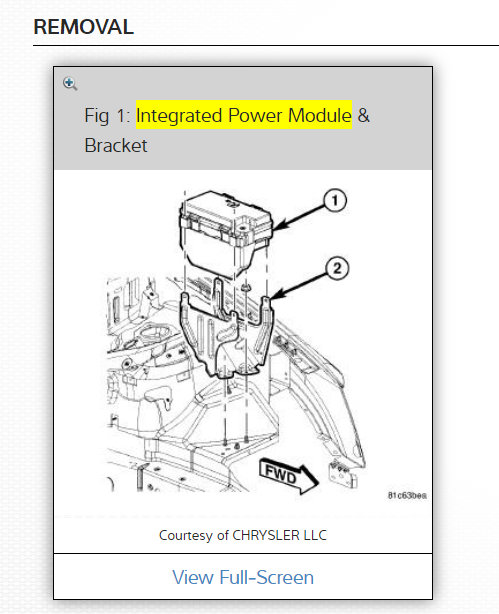

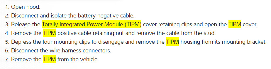

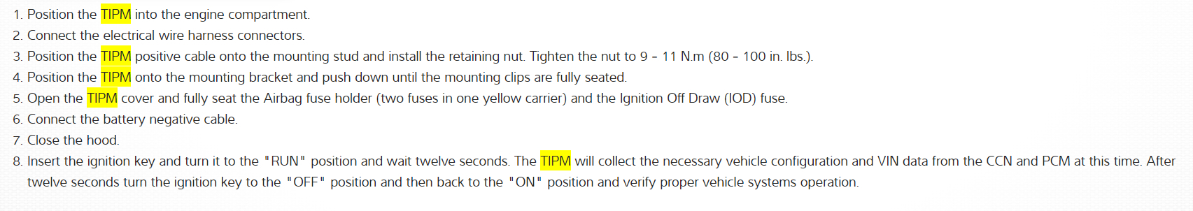

This sounds like a bad TIPM which is common. To be sure we need to do a CAN scan which you can get a CAN scanner from Amazon for about $60.00. here is a video of the job being done and instructions on how to replace the TIPM in the diagrams below:
https://youtu.be/InIlnsjOVFA
The TIPM self initializes so it is easy to replace. Check out the diagrams (below). Please let us know what happens.
