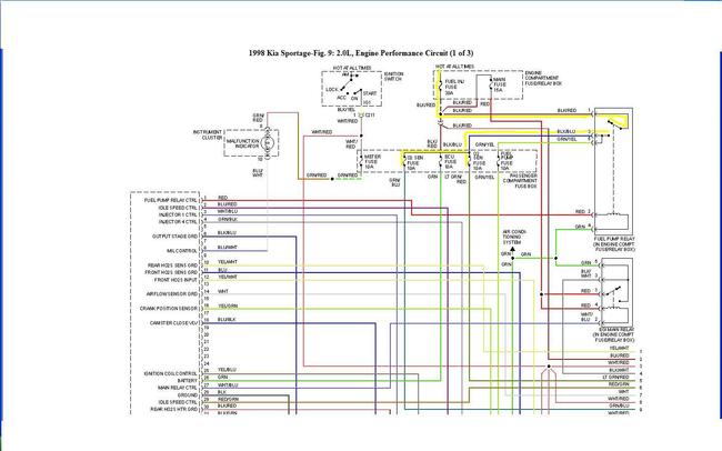

To test for power at the o2 sens fuses turn your key all the way on with out starting your engine. Set your voltmeter to direct current and place the negative probe on the inner wall of a power outlet or cigarette lighter (assuming your power outlet has power and ground) and your positive probe on each metal tab on the top side of the o2 fuses. If your meter reads battery voltage (12.9 +/-1.0) you know you have power to the fuses and on each side of the fuse. Then check for power to the rear o2 sensor. run a wire tied to the neg. battery post to your neg meter prob then place pos meter probe on the blue wire w/a green stripe and check for battery voltage. If good then this is where it gets more complicated. Turn the key all the way off and disconnect ECM computer electrical connector switch you meter to continuity and check pin no. 39 it is a solid blue wire and ground (ie power outer wall). If no continuity found then the only thing left is a damaged electrical connector pin either on the 02 sensor or ECM computer which is difficult to test w/o specialized electrical terminal tools.
Hear is some diagrams for your vehicle.

That doesn't look right to me. If your unsure about the ground on the power outlet you could run some wire right off of the battery ground into the driver side. Is there is way you could send a picture of your meter or a website that shows your exact meter? There are so many meters out there.
According to the wiring diagram you should get battery voltage with the key on at the fuse terminals. Let me know and we'll go from there.

TY looks like the fuse pump RELAY turns or passes 12 volts to both o2 sensor fuses
is the relay bad? or does car have to be running to check for 12 volts at these fuses ?
Sep 3, 2013 at 5:29 AM
TY ANDERSON
  • 719 POSTS
Yes, the fuel pump relay supplies power to the o2 fuses, You might be able to swap the fuel pump relay with another one (in the under hood fuse box). If there isn't another matching relay (5 pin) then you'll need to jump the relay (bypass the relay by completing the circuit with a large wire) then you can check for voltage at the o2 fuses. Let me know how it goes, TY

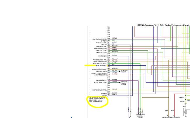

You should be getting power on to the o2 sens circuit from the fuel pump relay. The fuel pump relay under the hood supplies power to the fuel pump and also the o2 sensor fuses. Here is a wiring diagram that shows the path of power (highlighted). You may have an open any where between the fuse box on the driver side kick panel and fuse box under the hood specifically on the black wire with blue stripe. It looks like there is possibly a splice within the under hood fuse box that supplies power to the o2 sensor fuses.
Here I attached the actual diagnostic steps for P0137 fault code titled "98kiasportageP0137"
Pay extra attention to the blue wire it mentions. Although I don't talk about this blue wire above I find it odd at there is no power to the 02 sensor fuses.
Try these steps and then let me know if you have any questions, TY

Ok, Good your getting power to that side of the o2 sensor circuit. Now let focus on the other end.
Sorry for not making sure I sent the diag steps. It's complicated so I'll translate the steps to take.

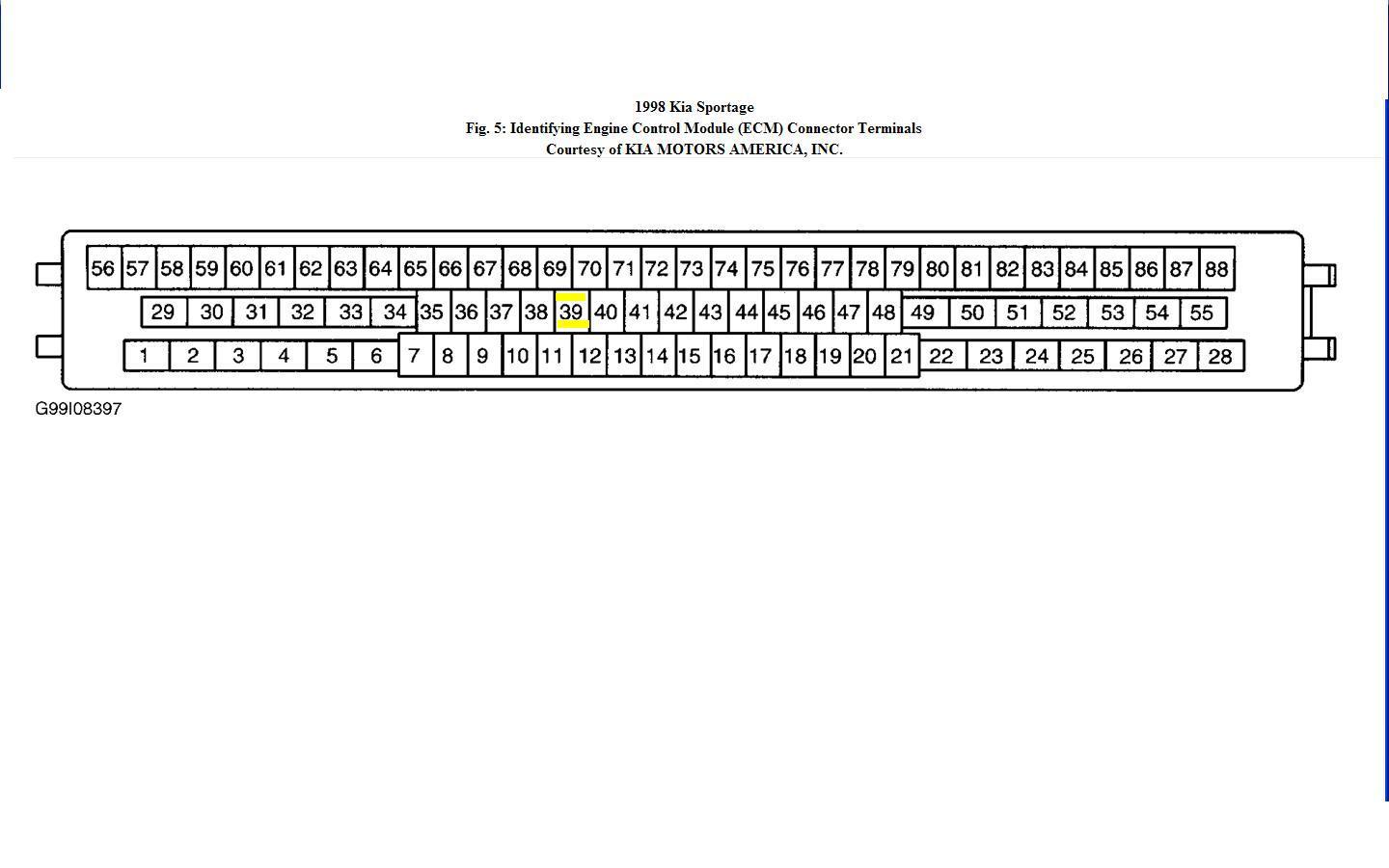

1 turn key completely off, disconnect rear o2 sensor 4pin electrical connector and computer 88 pin connector. Switch your meter to continuity (looks light sound waves picture) Place positive probe on pin 39 (pic I gave you on the computer electrical connector) and neg. probe on a ground ( power outlet wall or run a wire to the battery neg terminals). There shouldn't be any continuity if there is there is a short to ground on the blue wire running from computer to rear o2 sensor.
Start here and let me know how it goes, TY

Ty..You are saying to disconnect the rear O2 sesor 4 prong connector, and also disconnest PIN 88 on ECU..there is nothing to disconnnected at pin 88 according to my wiring diagram..??
I know how to do the continuity test..my meter has an adio so I can hear it if htere is continuity.
I just need help on the ECU pin 88

Sorry for the poor wording I meant the computer electrical connector (it has 88 holes for electrical pins on the connector it self).
You'll need to disconnected the o2 sensor or the continuity test will run through the sensor and give a wrong reading. All you're checking for on this test is a short to ground. So when you measure from the computer pin (#39 pin blue wire) to ground your meter shouldn't show any continuity. Talk to you soon, TY

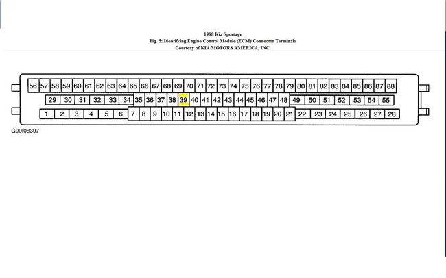

A four wire O2 sensor is supplied power from the battery for the heater circuit only on the Green wire with a blue stripe. The other three wires all go back to the computer.
The Black wire with a red stripe is the ground side of the heater circuit for the rear most oxygen sensor. The computer controls when the O2 heater turns on and off on the ground circuit.
Oct 27, 2013 at 2:00 AM
HOOKIE
  • 95 POSTS
Hi TY..originally the 98 kia sportage only had a P0137 code. Now it has the 2 others (po141, and Po103). I am sorry I didn't get back to you but have been sick, so wasn't able to diagnose this car problem.
I think I undertsand what you are saying. You are checking for continuity from rear (DOWNSTREAM) O2 sensor connector to pin 39 on ECU. I see in a wiring diagram that the oxygen sensor has grounds at the ECU on pin # 10 and pin #30, both grounds.
Do I need to check all 4 wires for continuity or just that one blue wire at pin #39 at ECU.
