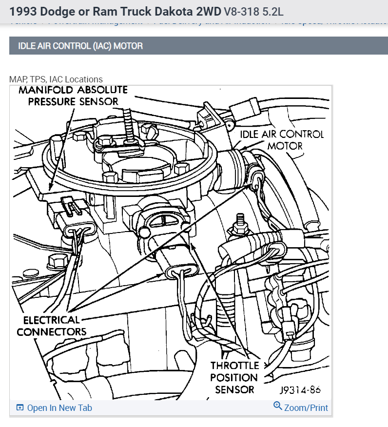

My 318 when running down the road, I will let off the gas and the engine will lope and shut off. How can I correct this?
Jun 21, 2023 at 1:04 AM
  • 55,456 POSTS

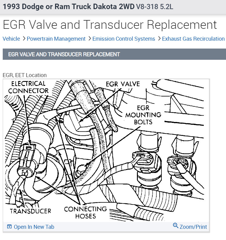

This can be a vacuum leak, a bad IAC valve or the EGR valve sticking open. Please go over this guide which should help us fix it:
Here is the vacuum leak guide, use only when the engine is cold:
Here is the location of the IAC and EGR valve so you can change it out. here is a video that can help you test the EGR:
https://youtu.be/DqUCbbKdWf4
