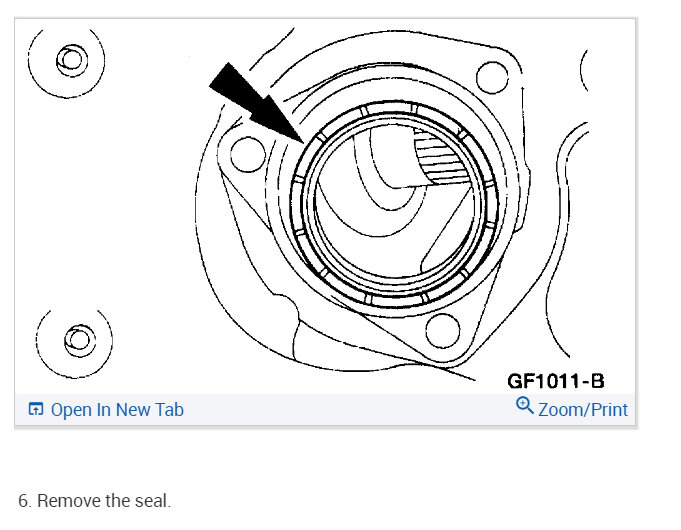

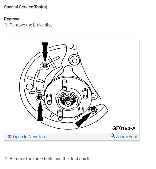

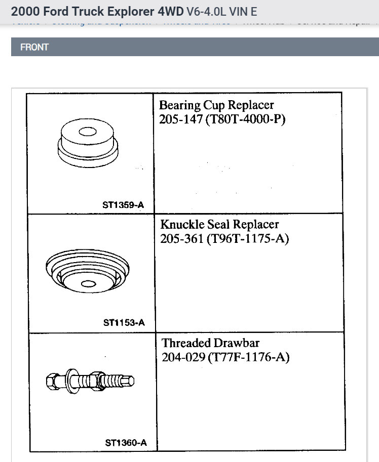

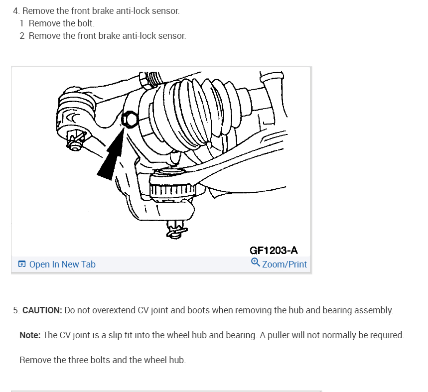

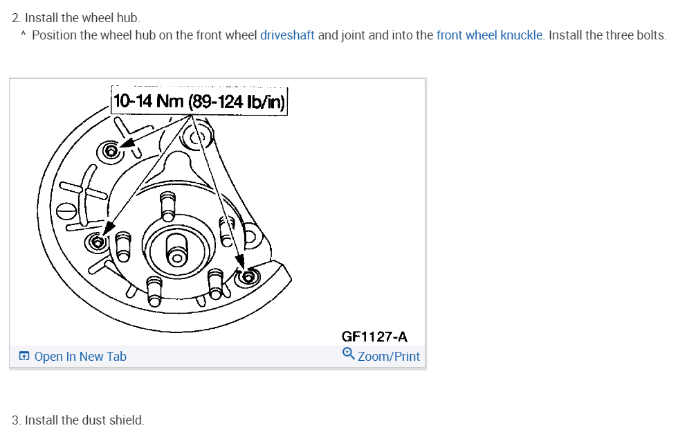

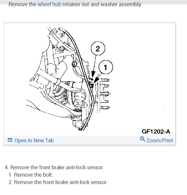

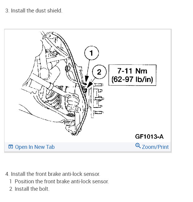

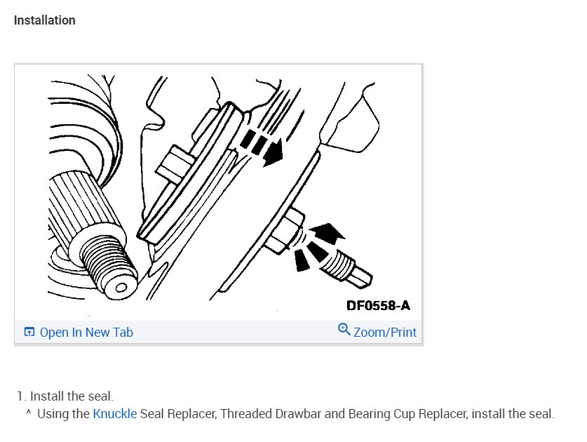

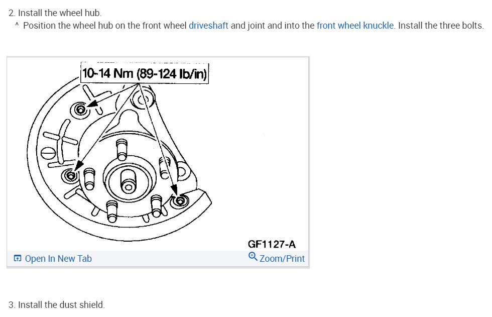

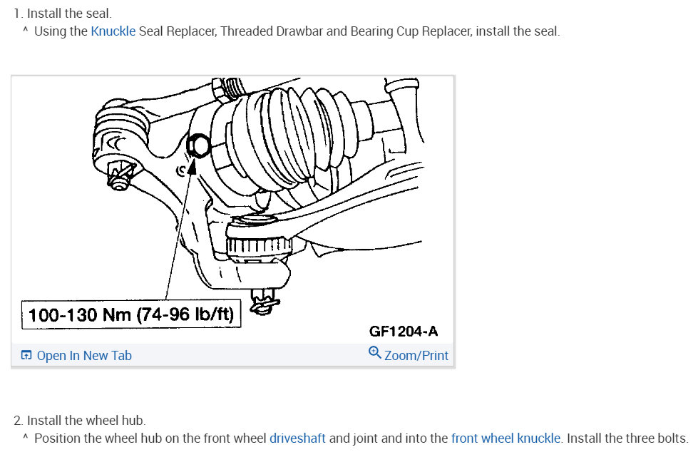

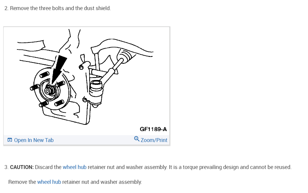

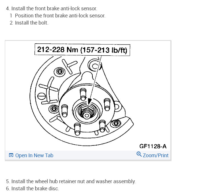

It is common for this vehicle to make this noise when the front bearing hub goes out, here is a video of the job being done on a similar car with instructions below to help as well:
https://youtu.be/qOAyXfPo7Z0?si=1uaIu7XFdbwSKDyC
Check out the images (below). Please let us know if you need anything else to get the problem fixed.
