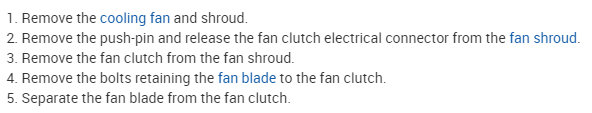

My vehicle runs real hot in traffic and the A/C won’t cool until the car moves. I can stop the fan easily with a glove on and hold it still with little or no resistance. How can I be sure it’s bad? I checked the fuse and relay.

Hi Danny, my vehicle listed above has an electronic fan clutch and I can stop the fan easily with my hand. I don't think it is moving much air. how can I be sure if its good or bad?I think i need to replace it but not 100% sure it is bad. Thanks, Craig

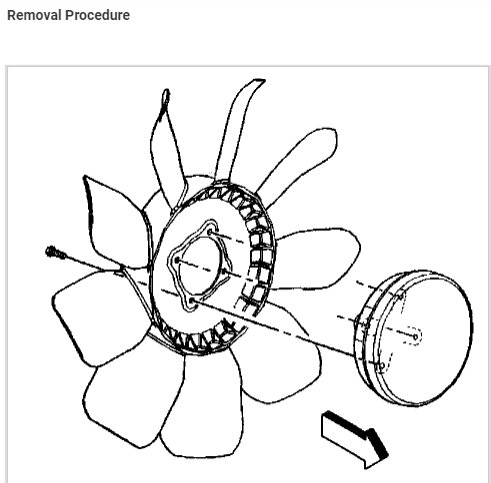

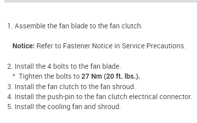

Yes, sounds like the electronic fan clutch is faulty. I've attached three pictures below as a step-by-step on how to remove and replace.Hope this helps and thanks again for using 2CarPros.
