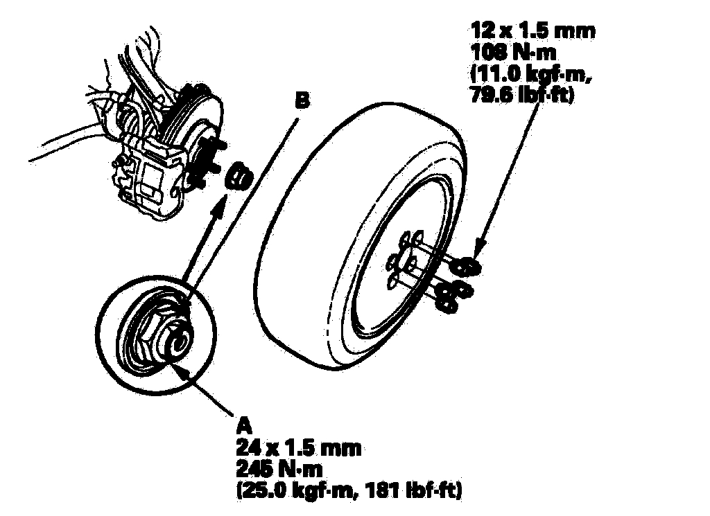

2. Remove the wheel nuts and front wheels.
3. Lift up the locking tab (A) on the spindle nut (B), then remove the nut.

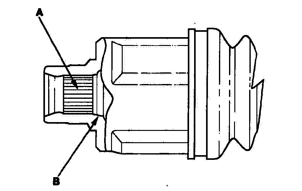

5. Remove exhaust pipe A.

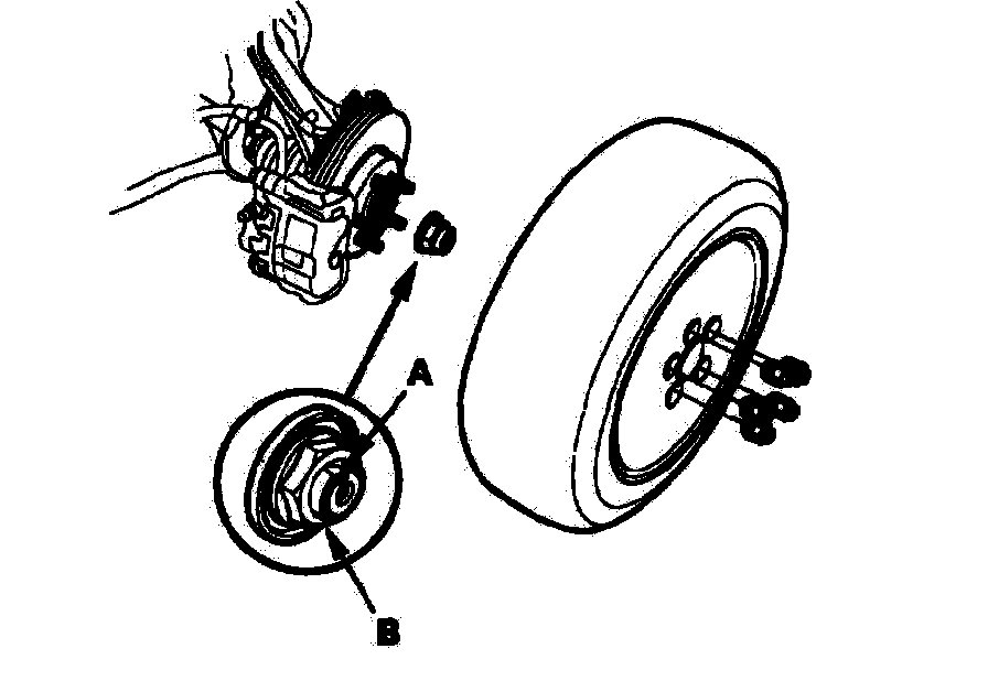

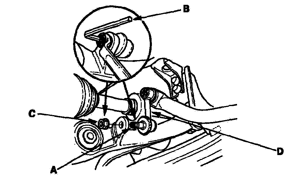

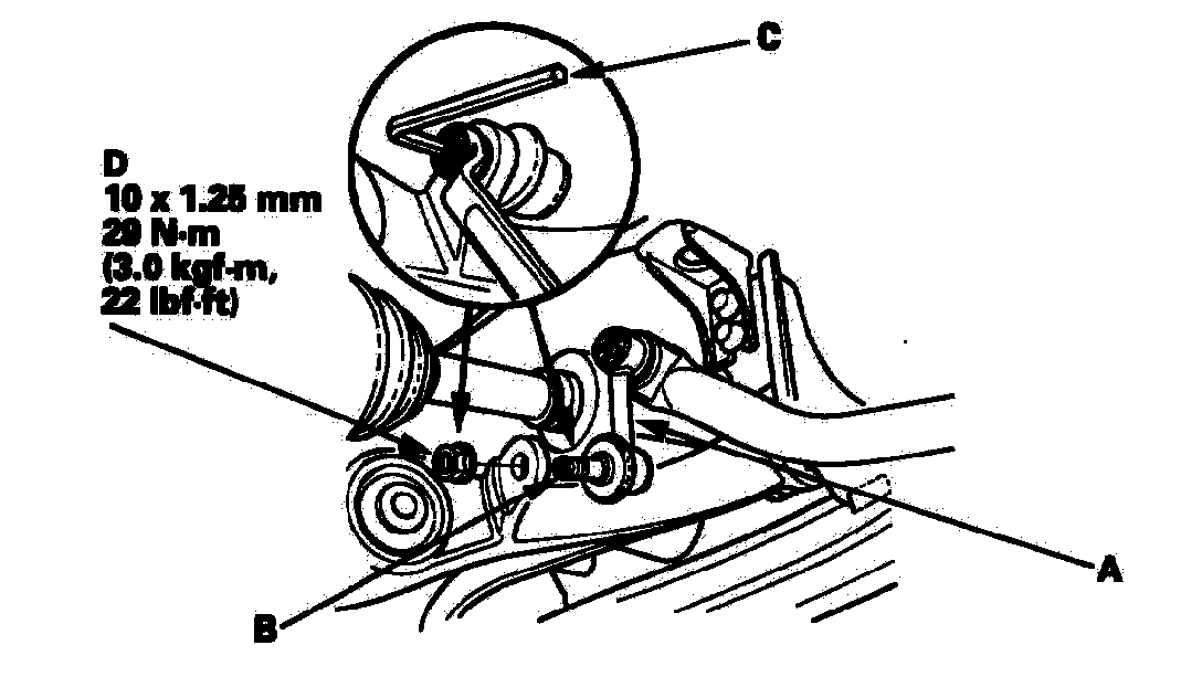

6. Hold the stabilizer ball joint pin (A) with a hex wrench (B), and remove the flange nut (C). Separate the front stabilizer link (D) from the lower arm.

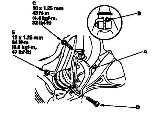

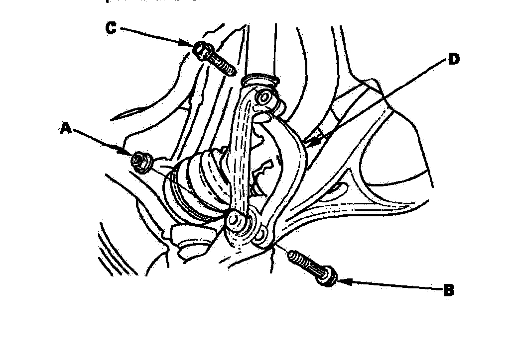

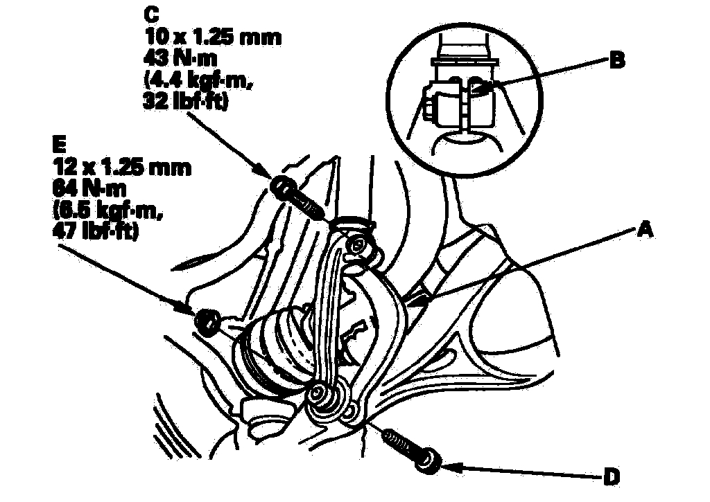

7. Remove the self-locking nut (A), 12 mm flange bolt (B), and 10 mm flange bolt (C), then remove the damper fork (D).

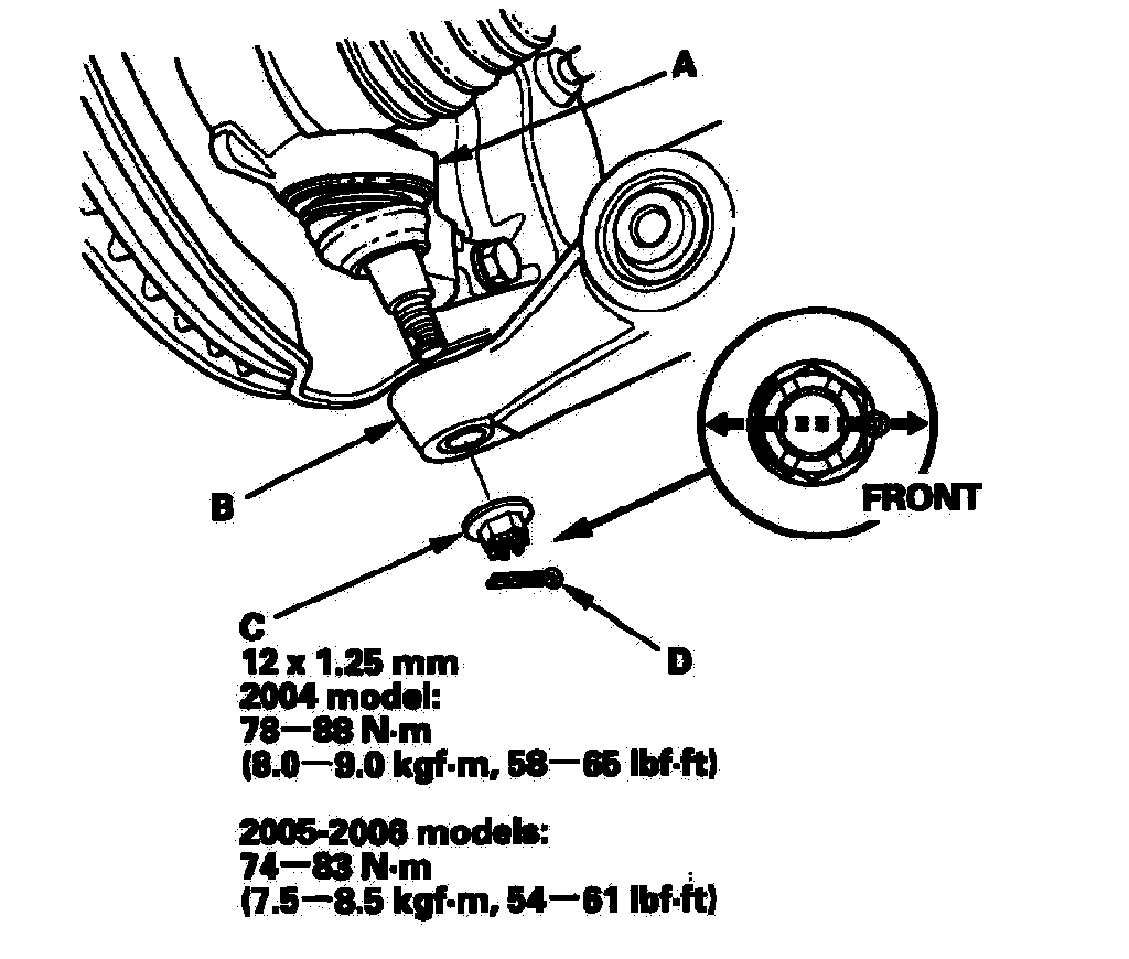

8. Remove the cotter pin from the lower arm ball joint castle nut, and remove the nut, then disconnect the lower ball joint from the lower arm using the ball joint thread protector and remover.

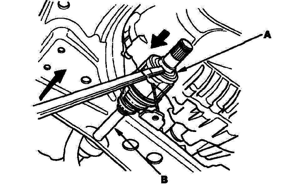

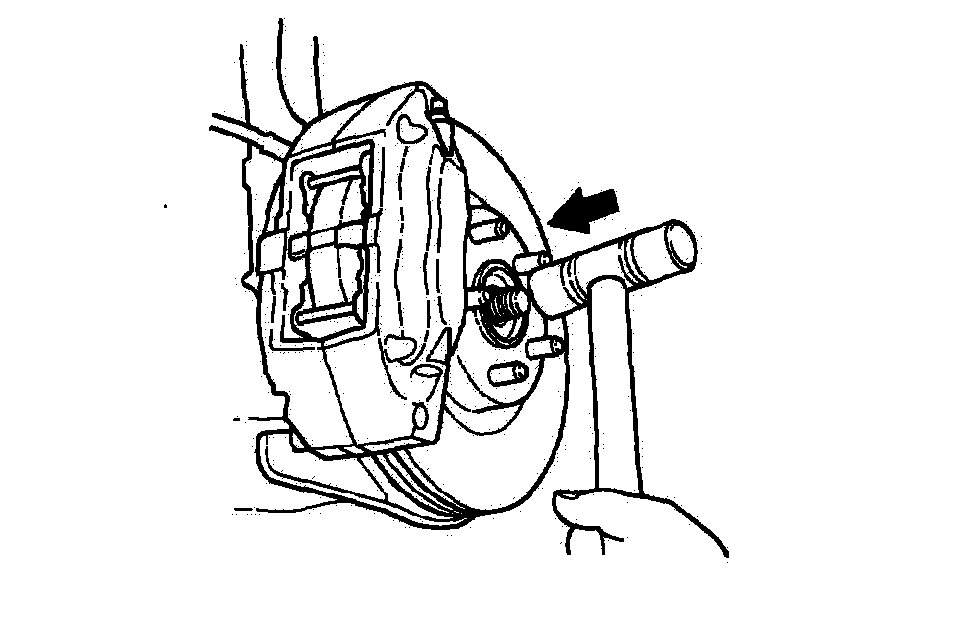

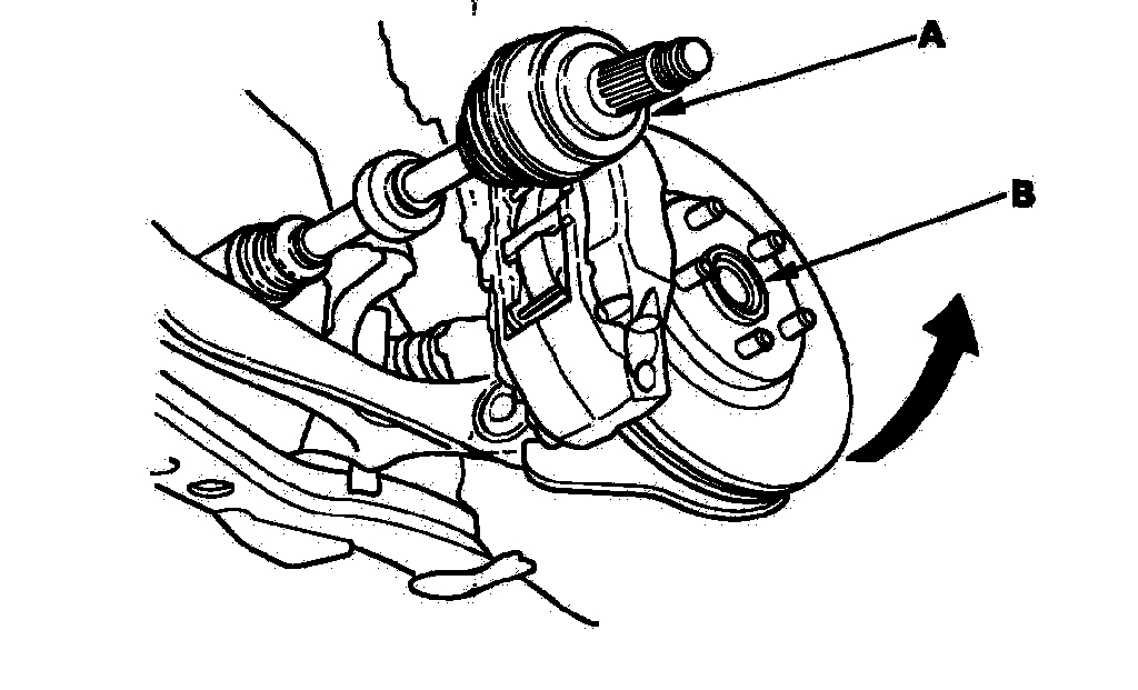

9. Pull the knuckle outward, and remove the driveshaft outboard joint from the front wheel hub using a plastic hammer.
pic 5

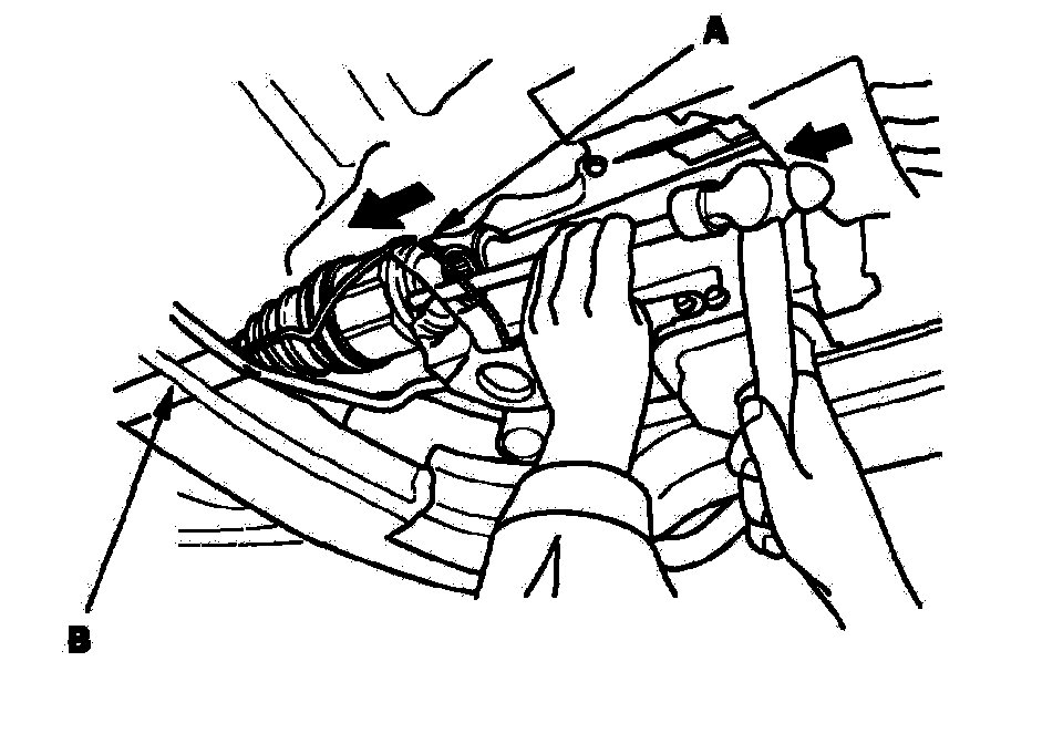

10. Left driveshaft: Pry the inboard joint (A) from the transmission housing with a prybar. Remove the driveshaft as an assembly.
NOTE: Do not pull on the driveshaft (B) or the inboard joint may come apart. Pull the driveshaft straight out to avoid damaging the oil seal.

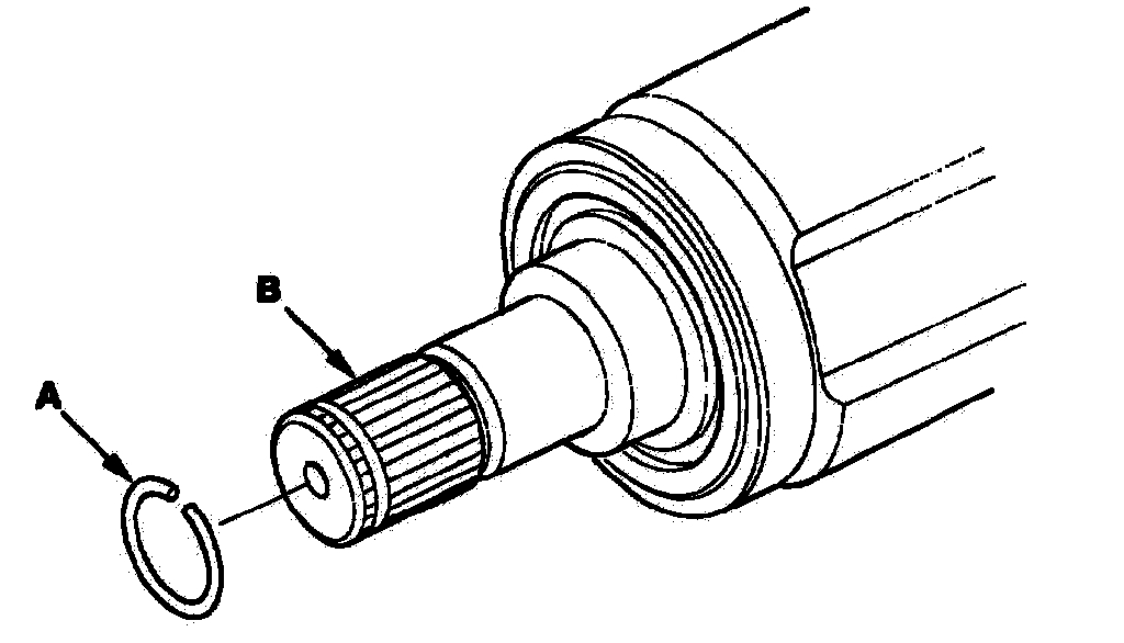

1. Install a new set ring (A) in the set ring groove of the left driveshaft (B).

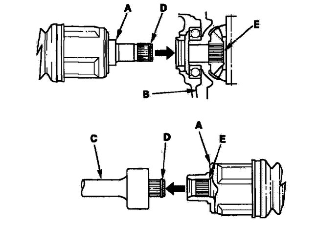

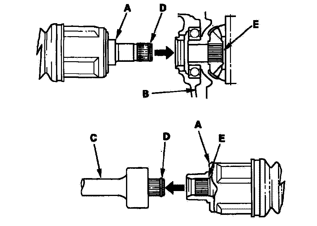

3. Clean the areas where the driveshaft contacts the differential thoroughly with solvent or brake cleaner, and dry with compressed air. Do not wash the rubber parts with solvent. Insert the inboard end (A) of the driveshaft into the differential (B) or intermediate shaft (C) until the new set ring (D) locks in the groove (E).

5. Clean off any grease contamination from the ball joint tapered section and threads, then install the knuckle (A) onto the lower arm (B). Torque the new castle nut (C) to the lower torque specification, then tighten it only far enough to align the slot with the ball joint pin hole. Do not align the nut by loosening it.
NOTE: Make sure the ball joint boot is not damaged or cracked.
6. Install the new cotter pin (D) into the ball joint pin hole, and bend the cotter pin as shown.

7. Install the damper fork (A) over the driveshaft and onto the lower arm. Install the damper in the damper fork so the aligning tab (B) is aligned with the slot in the damper fork. Loosely install the flange bolt (C).
8. Loosely install the flange bolt (D) and a new self locking nut (E).

9. Connect the front stabilizer link (A) to the lower arm. Hold the stabilizer link ball joint pin (B) with a hex wrench (C), and tighten the new flange nut (D).
