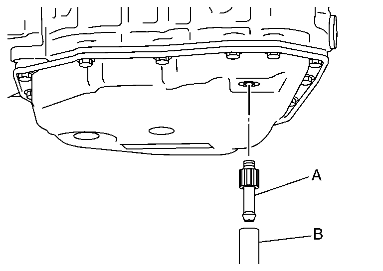

Bad accelleration and shifting
2014 NISSAN SENTRA
100,000 MILES • 1.8L • 4 CYL • 2WD • AUTOMATIC
TERRY PARSONS
  • 5 POSTS
The car will not change gears on take off unless i shift from drive to neutral back to drive. then it jumps to limp mode, but after you get up to speed and right gear the car seems okay, until we stop again.

Here are the specific directions for your vehicle to check transmission fluid level. If it is low, you must use the recommended CVT transmission fluid listed in these directions. Don't use regular automatic transmission fluid. The attached picture correlates with these directions.
CVT FLUID
Adjustment
CVT fluid: Refer to "General Specification" See: Continuously Variable Transmission/Transaxle, CVT > Mechanical > General Specification.
Fluid capacity: Refer to "General Specification" See: Continuously Variable Transmission/Transaxle, CVT > Mechanical > General Specification.
CAUTION:
- Use only Genuine NISSAN CVT Fluid NS-3. Using transmission fluid other than Genuine NISSAN
CVT Fluid NS-3 will damage the CVT, which is not covered by the (NISSAN new vehicle limited) warranty.
- During adjustment of the CVT fluid level, check CONSULT so that the oil temperature may be maintained from 35 to 45 C (95 to 113 F).
- Use caution when looking into the drain hole as there is a risk of dripping fluid entering the eye.
1.Check that the selector lever is in the "P" position, then completely engage the parking brake.
2.Start the engine.
3.Adjust the CVT fluid temperature to be approximately 40 C (104 F).
NOTE:
The CVT fluid is largely affected by temperature. Therefore be sure to use CONSULT and check the
"FLUID TEMP" under "TRANSMISSION" in "Data Monitor" while adjusting.
4.While depressing the brake pedal, shift the selector lever to the entire position from "P" to "L", and shift it to the "P" position.
NOTE:
Hold the lever at each position for 5 seconds.
5.Lift up the vehicle.
6.Check that there is no CVT fluid leakage.
7.Remove the drain plug. Refer to "Exploded View" See: Fluid Pan, CVT > Removal and Replacement > Exploded View.
See Pic 1
8.Install the charging pipe set (KV311039S0) (A) into the drain plug hole.
CAUTION:
Tighten the charging pipe by hand.
9.Install the ATF changer hose (B) to the charging pipe.
CAUTION:
Press the ATF changer hose all the way onto the charging pipe until it stops.
10.Fill approximately 0.5 liter (1/2 US qt, 1/2 lmp qt) of the CVT
fluid.
11.Remove the ATF changer hose from the charging pipe, and check that the CVT fluid drains out from the charging pipe. If it does not drain out, perform charging again.
CAUTION:
Perform this work with the vehicle idling.
12.When the flow of CVT fluid slows to a drip, remove the charging pipe from the oil pan.
13.Tighten the drain plug to the specified torque. Refer to "Exploded View" See: Fluid Pan, CVT > Removal and Replacement > Exploded View.
CAUTION:
Never reuse drain plug gasket.
14.Lift down the vehicle.
15.Stop the engine.

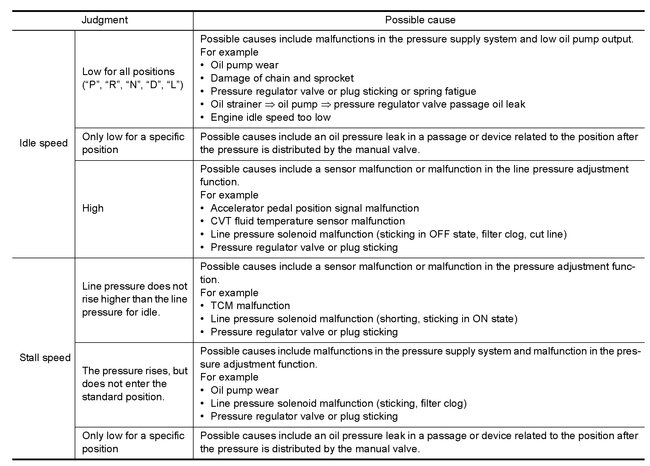

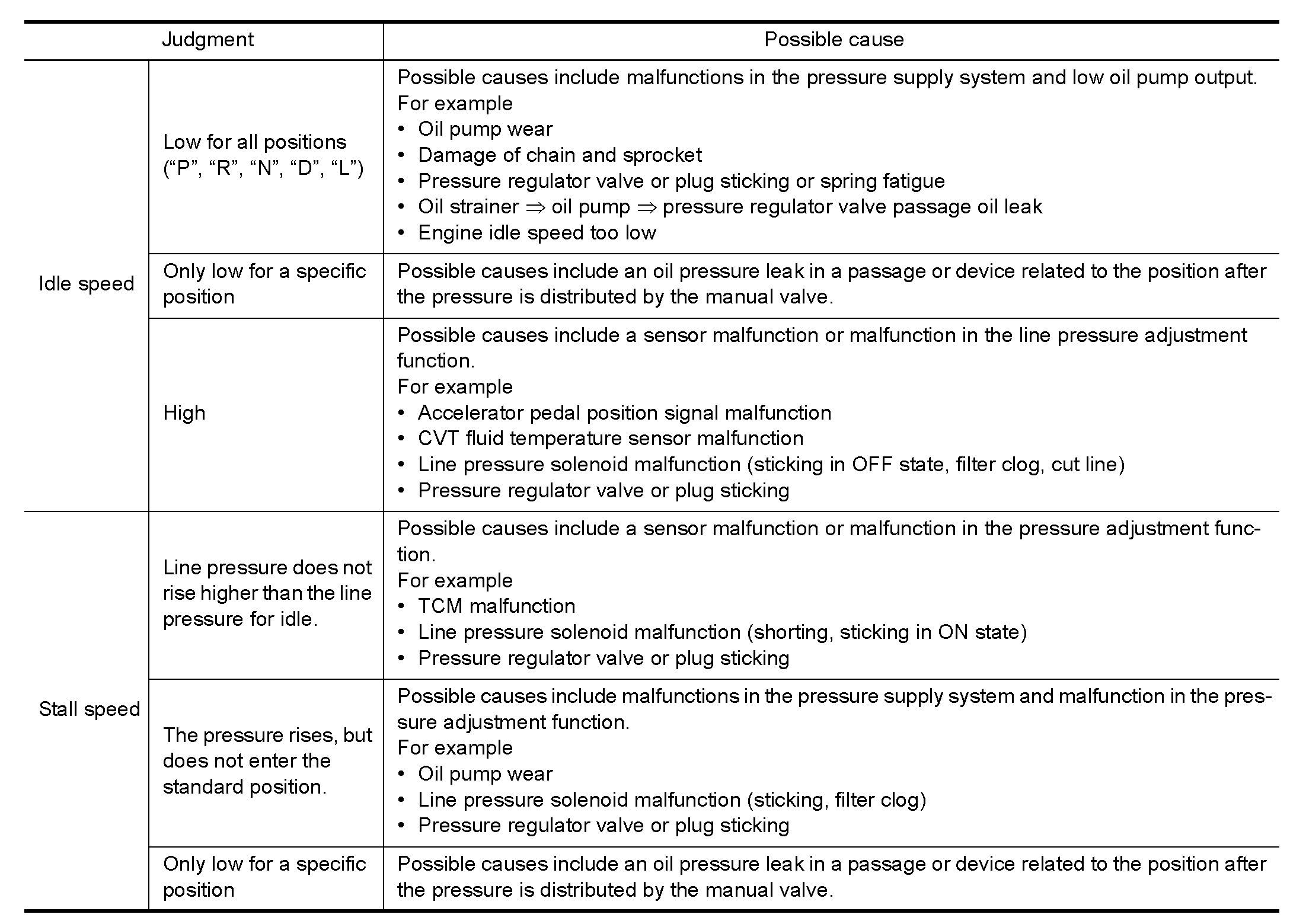

TERRY PARSONS
  • 5 POSTS
IM codes says-02S,CAT,EGR,EVA
Other codes P0846,0965,2859
Mar 24, 2019 at 6:26 AM
  • 110,194 POSTS
The IM codes are all emissions component related. The additional codes are related to line pressures and clutch pressure in the transmission. That is where I would start. With that, here are the directions for testing line pressure. The attached picture correlates with these directions.
LINE PRESSURE TEST
LINE PRESSURE TEST
Work Procedure
INSPECTION
1.Check the engine oil level. Replenish if necessary. "Inspection" See: Engine Oil > Procedures > Inspection.
2.Check for leak of the CVT fluid. Refer to "Inspection" See: Fluid - CVT > Procedures > Inspection.
3.Drive for about 10 minutes to warm up the vehicle so that the CVT fluid temperature is 50 to 80 C (122 to
176 F).
4.Be sure to apply the parking brake and block the tires.
5.Start the engine.
6.Select "Data Monitor" in "TRANSMISSION".
7.Select "LINE PRESSURE".
8.Measure the line pressure at both idle and the stall speed.
CAUTION:
Keep brake pedal pressed all the way down during measurement.
Line pressure: Refer to "Line Pressure" See: Continuously Variable Transmission/Transaxle, CVT > Pressure, Vacuum and Temperature > Line Pressure.
NARROWING-DOWN MALFUNCTIONING PARTS
See Picture 1
Let me know the results.
