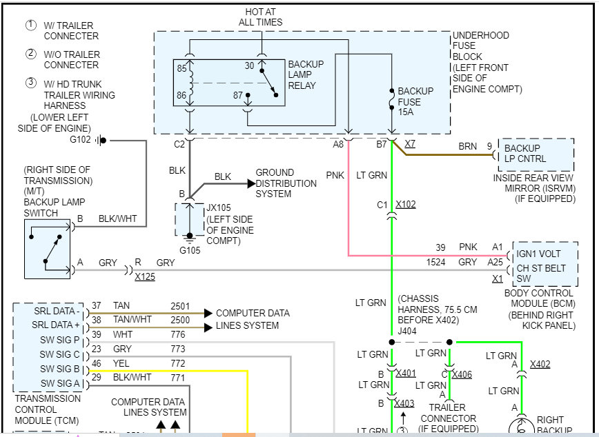

backup light switch wire color needed?
2011 GMC CANYON
112,345 MILES • 2.9L • 4 CYL • 4WD • MANUAL
GES313
wire color to backup light switch.
Sep 25, 2022 at 4:20 PM
  • 110,194 POSTS

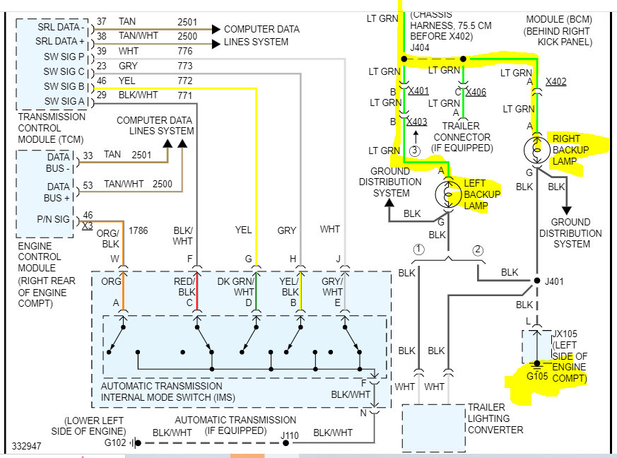

I attached the wiring schematic below for the entire circuit. The power supply to the lights is light green.
Take a look through it and let me know if you have other questions. Also, I had to cut the schematic in half to make it readable for you. I did overlap the two so you can follow from one to the next.
