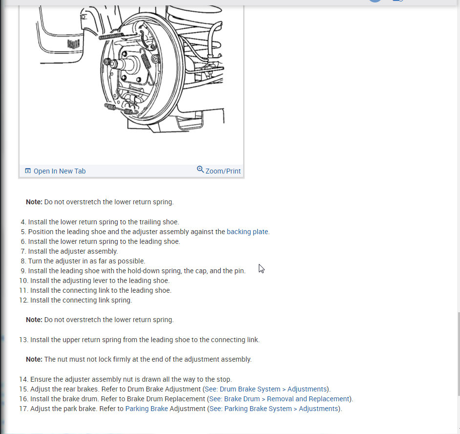

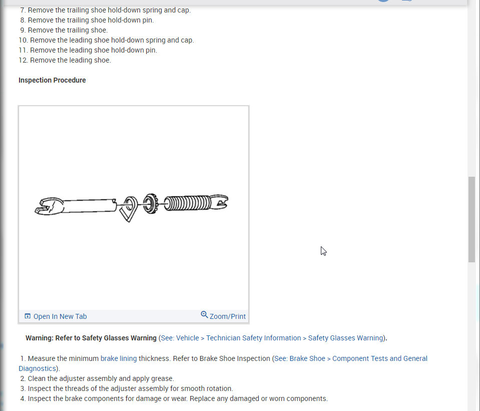

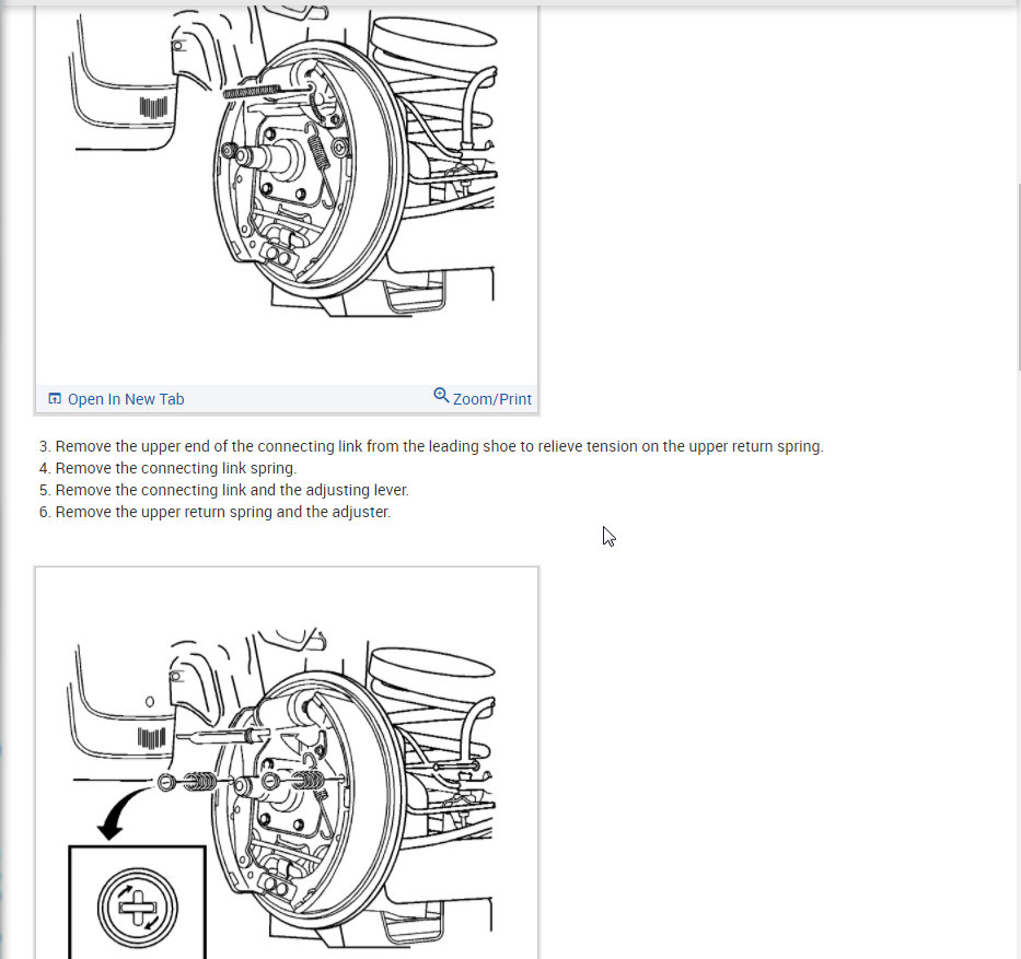

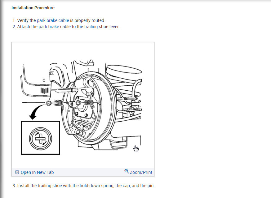

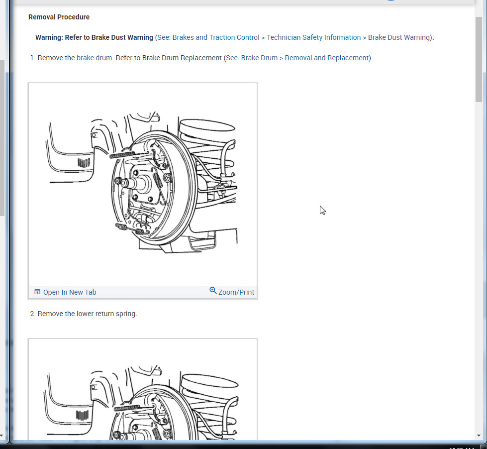

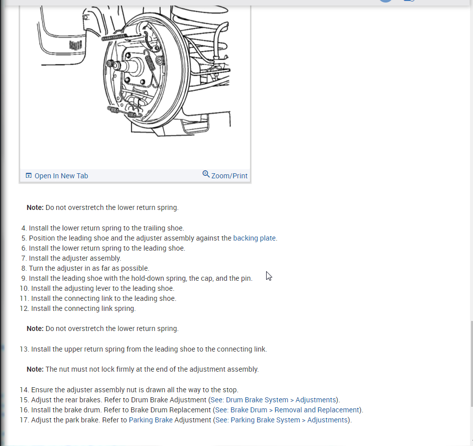

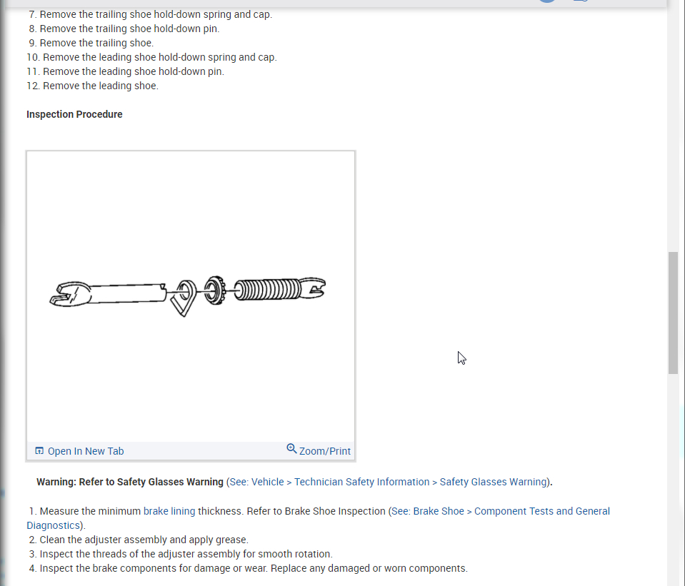

The car starts and makes a loud noise , all tires will move except my back right tire.
Mar 26, 2021 at 12:27 AM
Two things. First, the loud noise that this is making, can you get a recording of this noise? I don't think that is related to the tire not moving.
Then can you lift the vehicle and try and spin the tire by hand? If it does not move then we most likely have a brake issue being locked on that side.
Here is a guide that will help with this:
https://www.2carpros.com/articles/how-to-replace-rear-brake-shoes-and-drums
Below is the info from the manual on how to replace the shoes. We need to take them apart to find out what is going on in there.
Let me know what questions you have and if you can get a recording of that noise. Thanks
