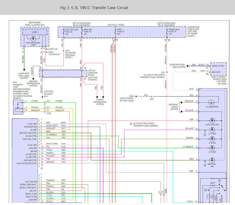

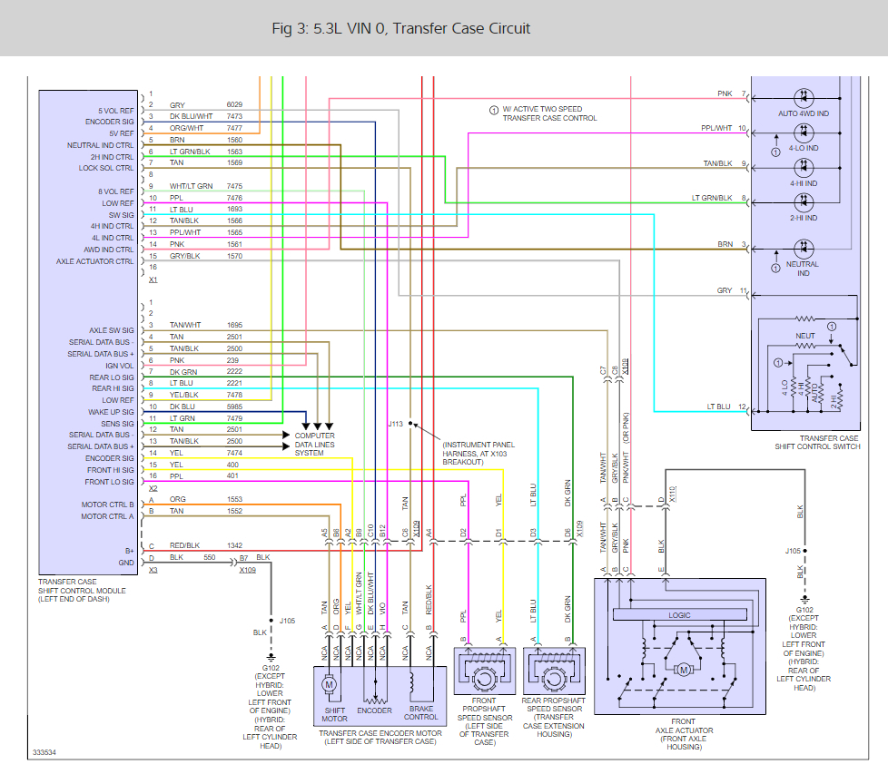

This car has the stability track light on.
scanned and found following code :
B0790 BO706 fault code : transfer case neutral range indicator control circuit low voltage/open.
Any advice please.
Thanks
Oct 10, 2017 at 9:55 AM
  • 54,832 POSTS

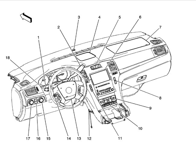

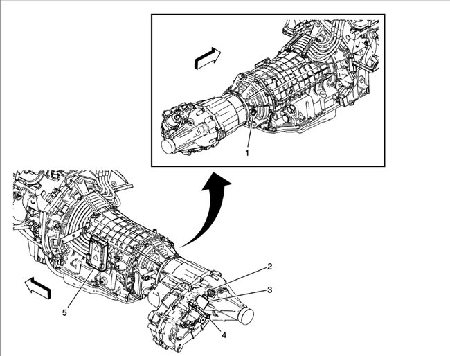

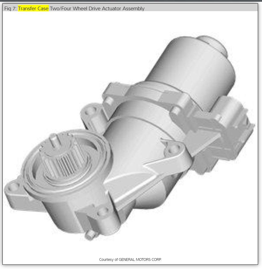

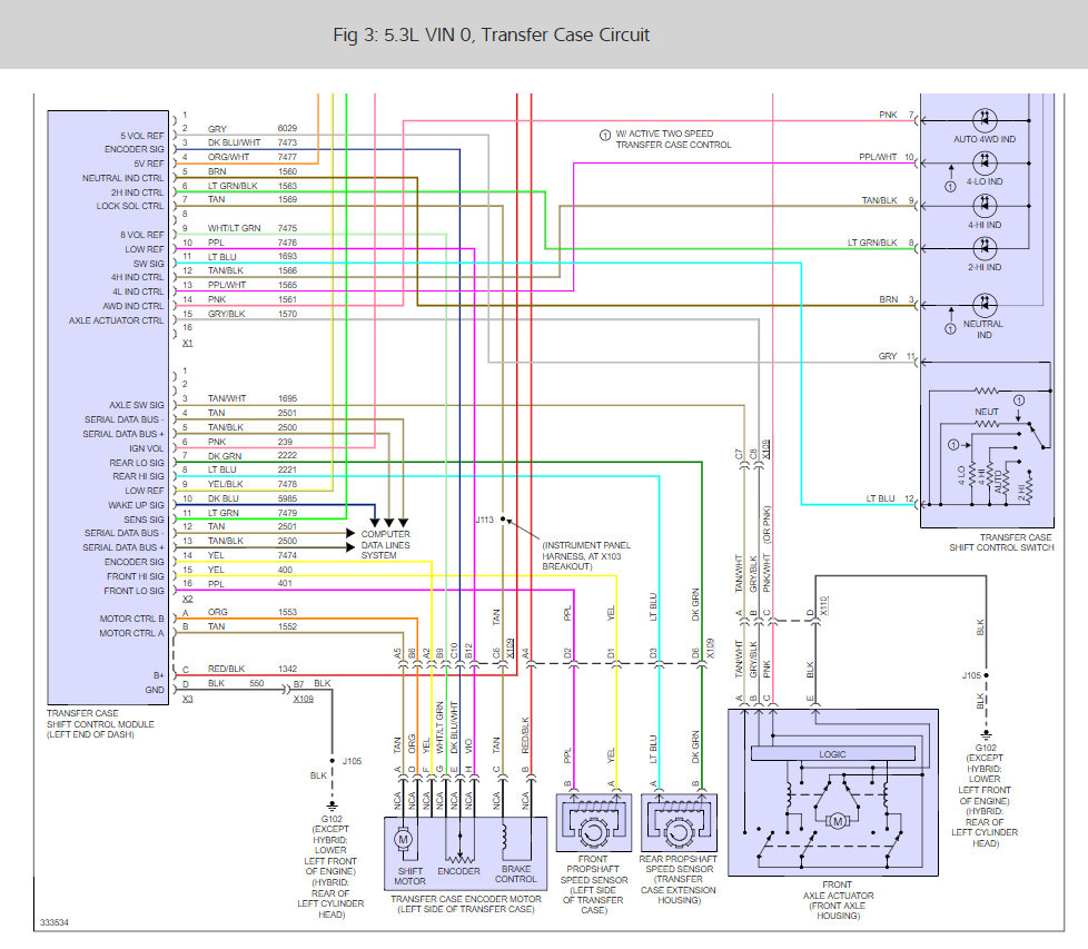

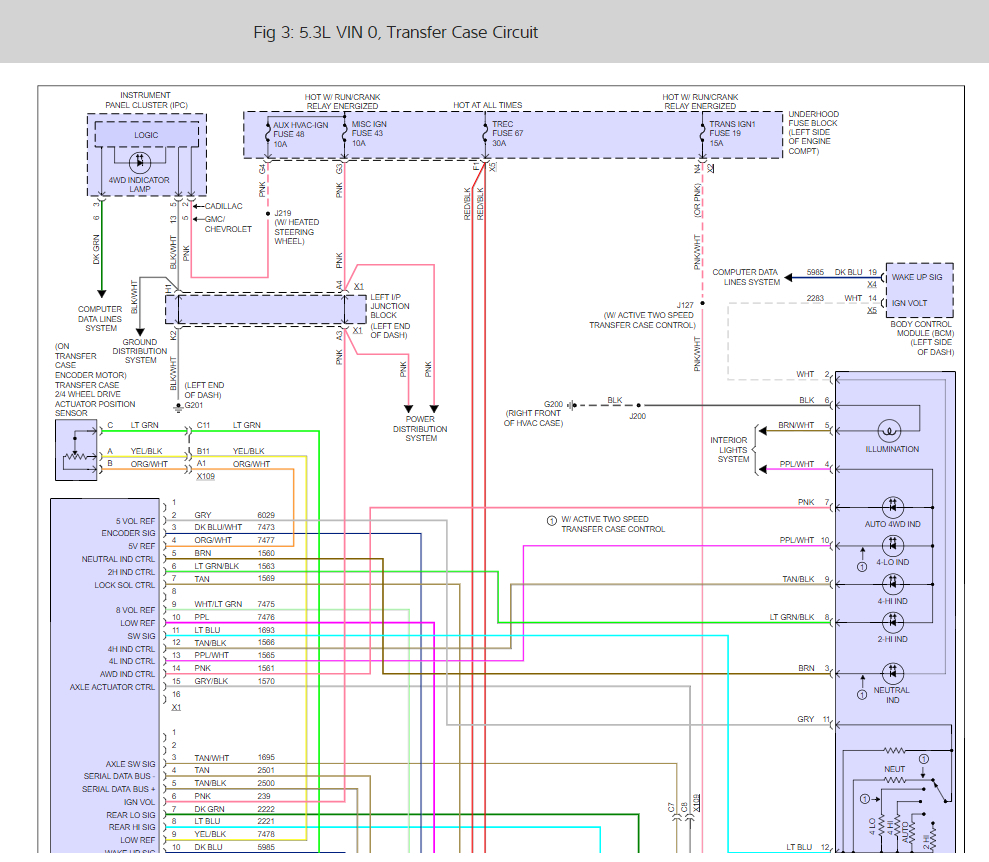

It sounds like you have an encoder or a wiring issue.
Here is a guide and some diagrams to help you see whats going on:
Please let us know what happens and upload pictures or videos of the problem.
Oct 10, 2017 at 12:11 PM

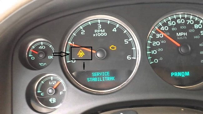

Hi
I mean the light as attached.
thanks

I cleared codes and drive for test , then scanned again , now I got 2 fault codes :
B0790-06 and B2725-08
any advice ?
Regards
Oct 12, 2017 at 4:30 AM
  • 54,832 POSTS
The stability track light will stay on if the encoder is stuck. It can also mean you have a 4wd drive switch that is out.
The switch is common as well and is an easy fix.
Oct 12, 2017 at 10:56 AM
MB-POWER
  • 80 POSTS
Hi
4wd drive switch has been replaced & every thing is okay now.
thanks for every body.
Oct 23, 2017 at 9:04 AM
